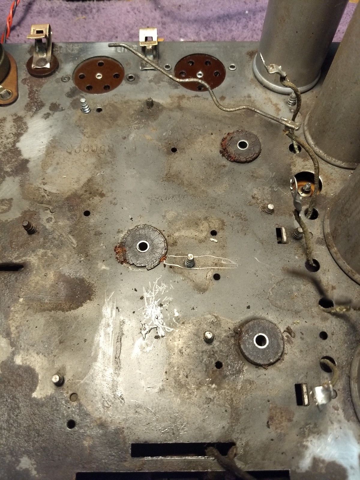

Take the cap apart, rotor and stator separately, soak in dishwashing soaped water (not together), take a long soft brush, gently brush inside. Rinse well, blow with air (be careful with airguns, better use canned air), dry completely.
Reassemble, lube.
The dial could be washed with mineral spirits. Try on a corner first.
Find the grommets. The ones you have are fully flat. The grommet should be 1) a bit thicker than the metal insert, 2) allow the inserts to go through and 3) be able to go through the openings in the chassis without being torn apart (heatgun on low helps by softening it). Renovated Radios might have them . If not, bu a suitable grommets in Lowes and use rubber washers to pad if not long enough. This is a bit tedious to reassemble but I did that a few times.

If all goes well, I'll put a new dial in it. I am taking this radio in phases to see if there is a show stopper I might not want to tackle, but I think it is restorable with my skills. I carefully examined all exposed coils with bright light and magnifying glass to see if any NC disease, they look great and all ohm out good. I removed the last covered detector to see its shape and it looked perfect also, I will re wire if I have to.
About cleaning the cap, do you clean the micas as well? There's black hardened buildup on the shaft which I tried to get off, maybe the soak will with careful brushing. I have some good neoprene grommets that will suspend this cap tightly. I will rewire the entire cap, those are gone also.
