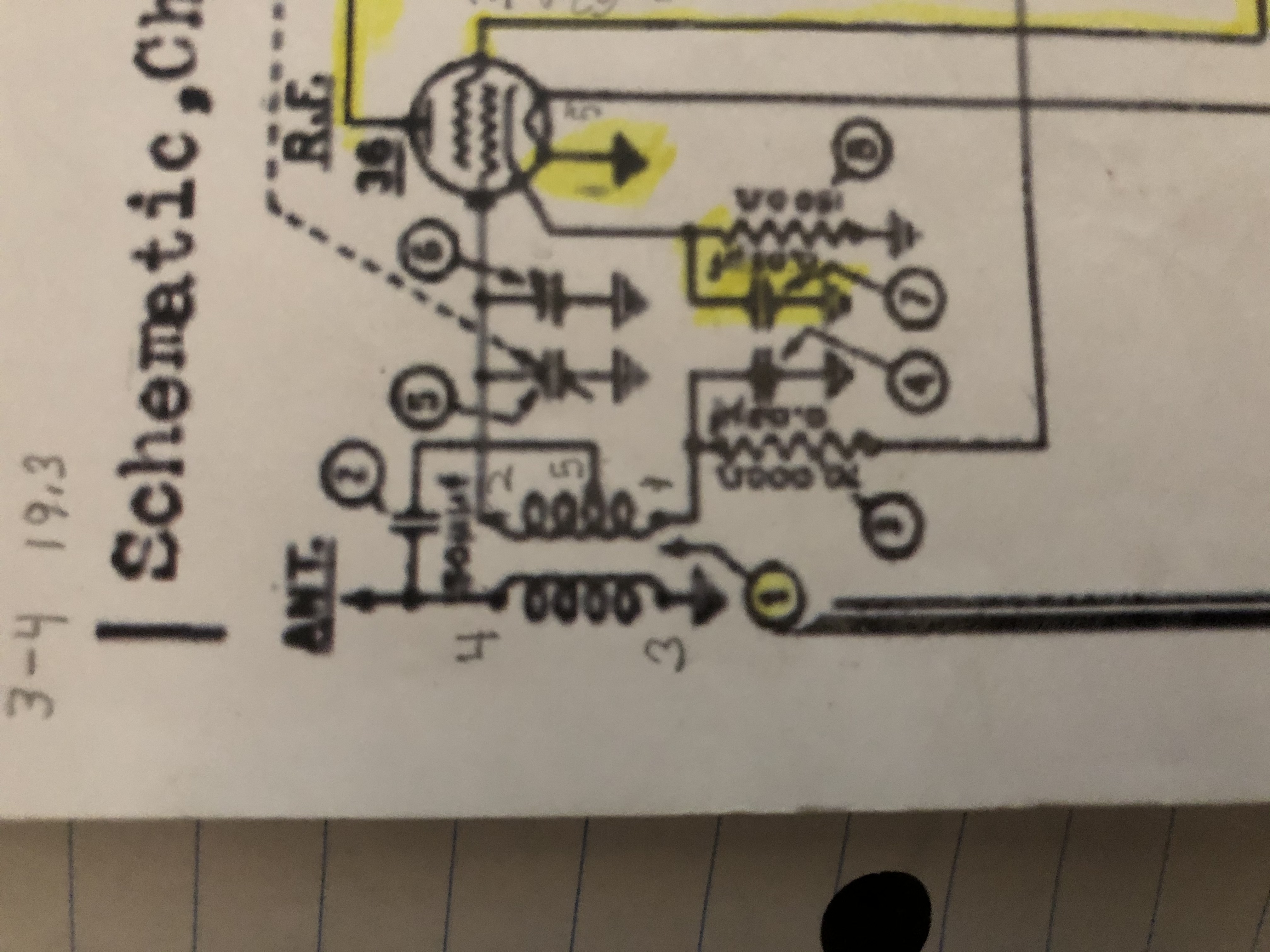

On your suggestion I rechecked the RF transformer.
It seemed resistances came up defying common sense.
I have Coil #1 out of the radio and it reads  19.3 ohms on the primary
However the secondary reads across the coil 7.57 ohms
from the bottom of the coil to the center tap 6.55 ohms
from the center tap to the top of the coil to the center tap 7.75 ohms
I would expect the total coil resistance to be 7.75 + 6.55...14.30 ohms total ??
I have no clue as to what is going on here?
I will probable unwind  it to try to figure out what gives.
Tom
tom,
your resistance readings sure don't "add up." but you must be looking at the antenna transformer if it haws a center tap. it's part no. 1 on the schematic attached to your first post. the readings suggest maybe a short in the secondary coil?? even so, i'd wait before unwinding it. you can test the rest of the circuitry by putting a modulated signal into the grid of the 36 tube. i'd leave the antenna transformer out for now in case it is shorted. I still think the secondary of the RF coil, part no. 3, is open. it only has 4 leads, connected in pairs. again, you can check those resistances [2 low, the rest infinite] with the transformer in the radio. double check to be sure you really do have the RF transformer and not the antenna transformer. it's the one connected to the plate of the 36 tube. the antenna transformer is connected to the grid [cap] of the 36.

What I found was there are 2 caps marked c35 on the schematics !! Put two in on opposite sides of the chassis making the value x2. And one missing cap needed for isolation.   Gotta love Philco schematics…My Bad!
Once corrected I was able to get back to the correct values for the oscillator RC timing values
Everything trim’d up but couldn’t get through the rf amp

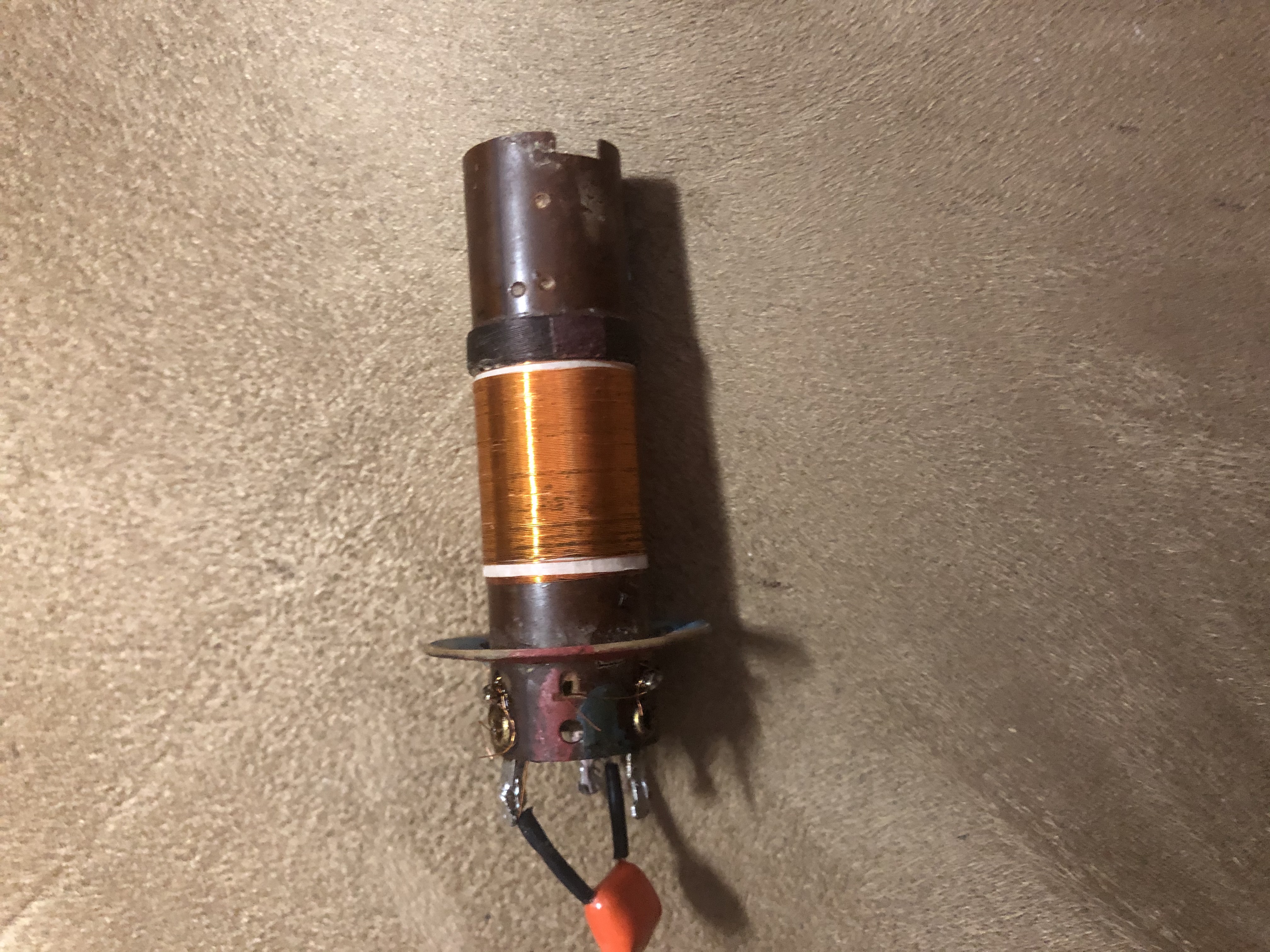

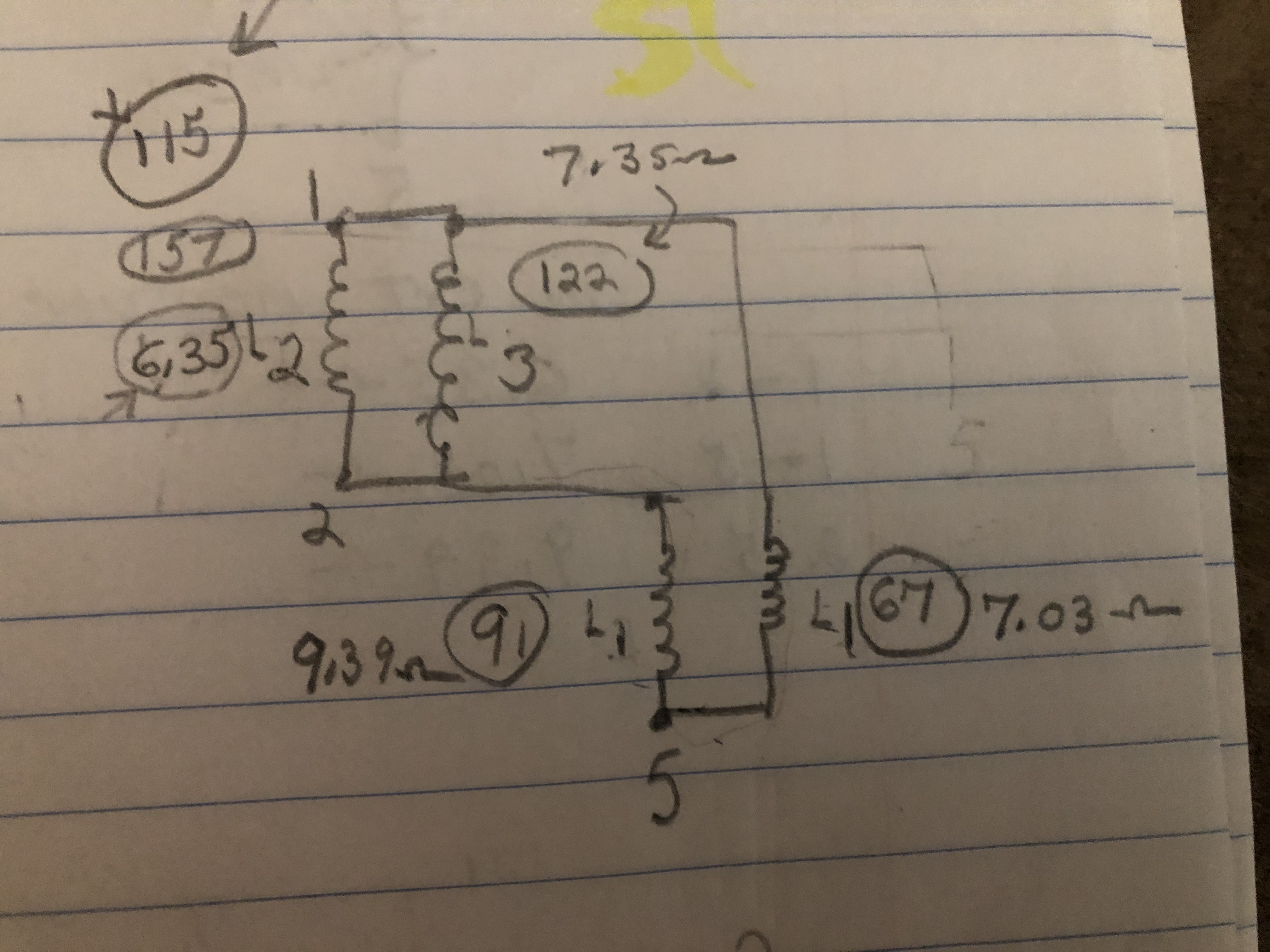

Antenna coil measured crazy on the secondary. I unwound it and it
turned out to be not even close to the schematic.   Ended up unwinding and documenting it then rewind
There were 3 layers separated by parchment paper.  I rewound it.  What a pain! Wish I took your advice and left it alone.

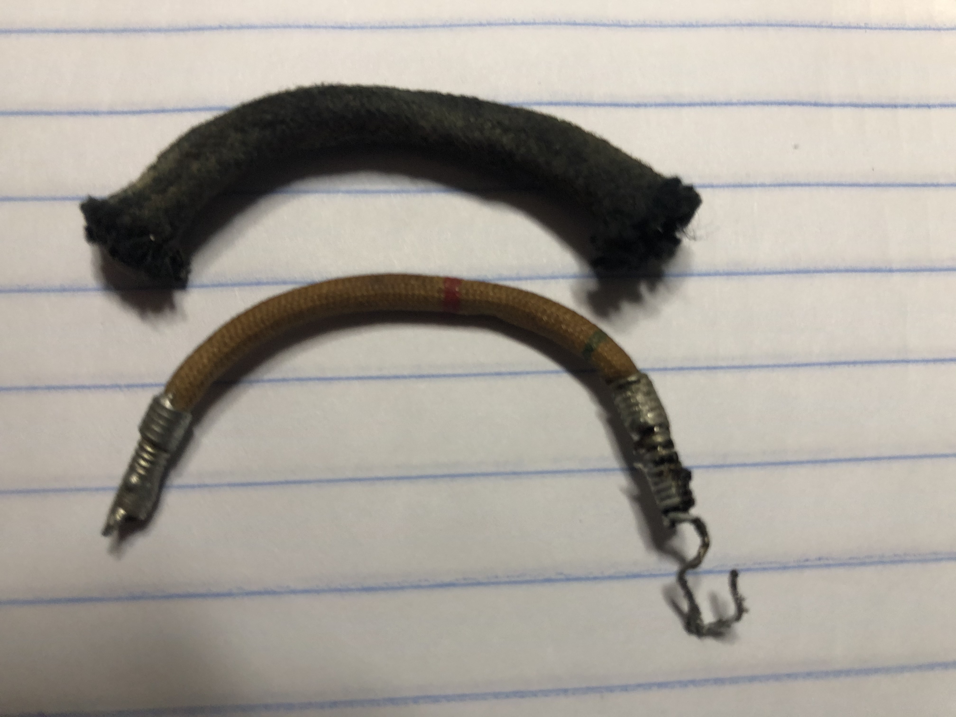

Final problem was some sort of resistance wire buried deep in the chassis inside of a covering....(R8).
R8 was open so no bias on the cathode of the rf amp.  I attached pictures of the coil and the (resistance wire R8)
Radio is working and trimmed to spec.
Will never go near one of these again!
Another Philco from H**l
Tom
Those flexible resistors are not unique to Philco; they turn up in other sets as well. They tend to be fragile, and sometimes open up.
