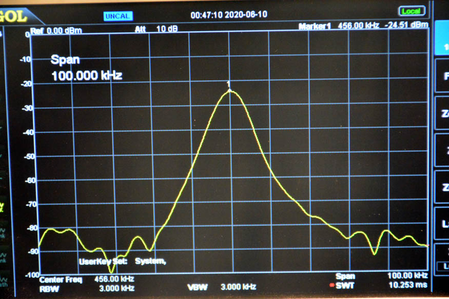

I hooked the IF section up to the spectrum analyzer to see what I could do with the response curve.  Here are the results:
IF peaked per alignment instructions. At 6 db down the bandwidth is about +-3.5k.

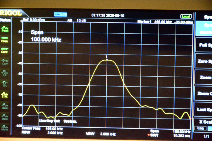

I looked at doing this.  At 6db down, bandwidth would be about+- 7K but the sensitivity is down a lot.

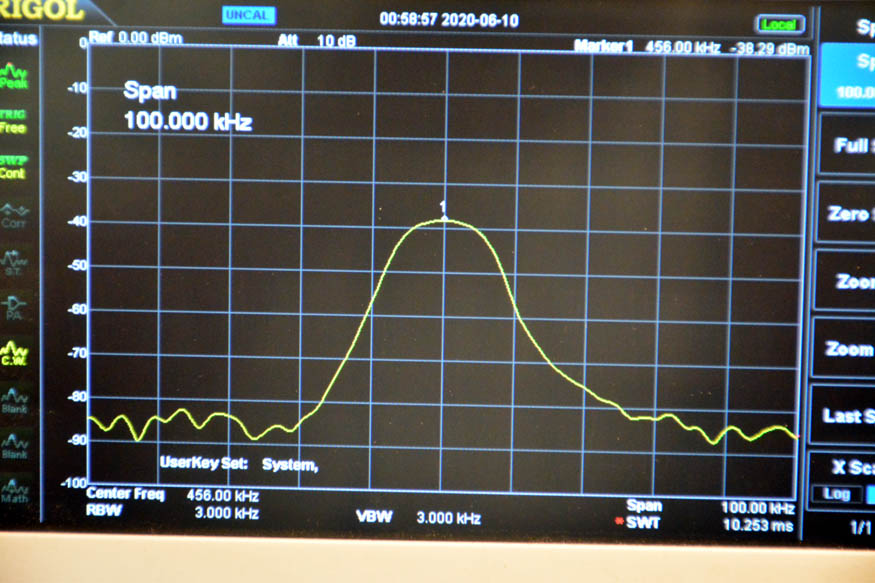

I settled in on this. At 6db down, bandwidth is about +- 6k.
At the loss of quite a bit of sensitivity, I gained a fair amount of bandwidth.  Still not as good as the Philco 37-116. The radio does sound better with my HiFi transmitter, though.  That's the way I usually use my AM sets.  If I listen to real broadcasts, it's usually talk radio so the high frequencies are not needed.

To every change there are consequences! By broadening out the IF response curve, I reduced the sensitivity. Now, with a very strong signal, I get a lot of distortion. I presume the strong signal is over driving the RF stage since the AVC is not shutting the RF and Detector amps down enough. I'll have to take some AVC voltage measurements with the IF peaked and compare it with the broadened IF AVC voltages. Perhaps changing one resistor will bring it in line again. It's fun to fiddle!
