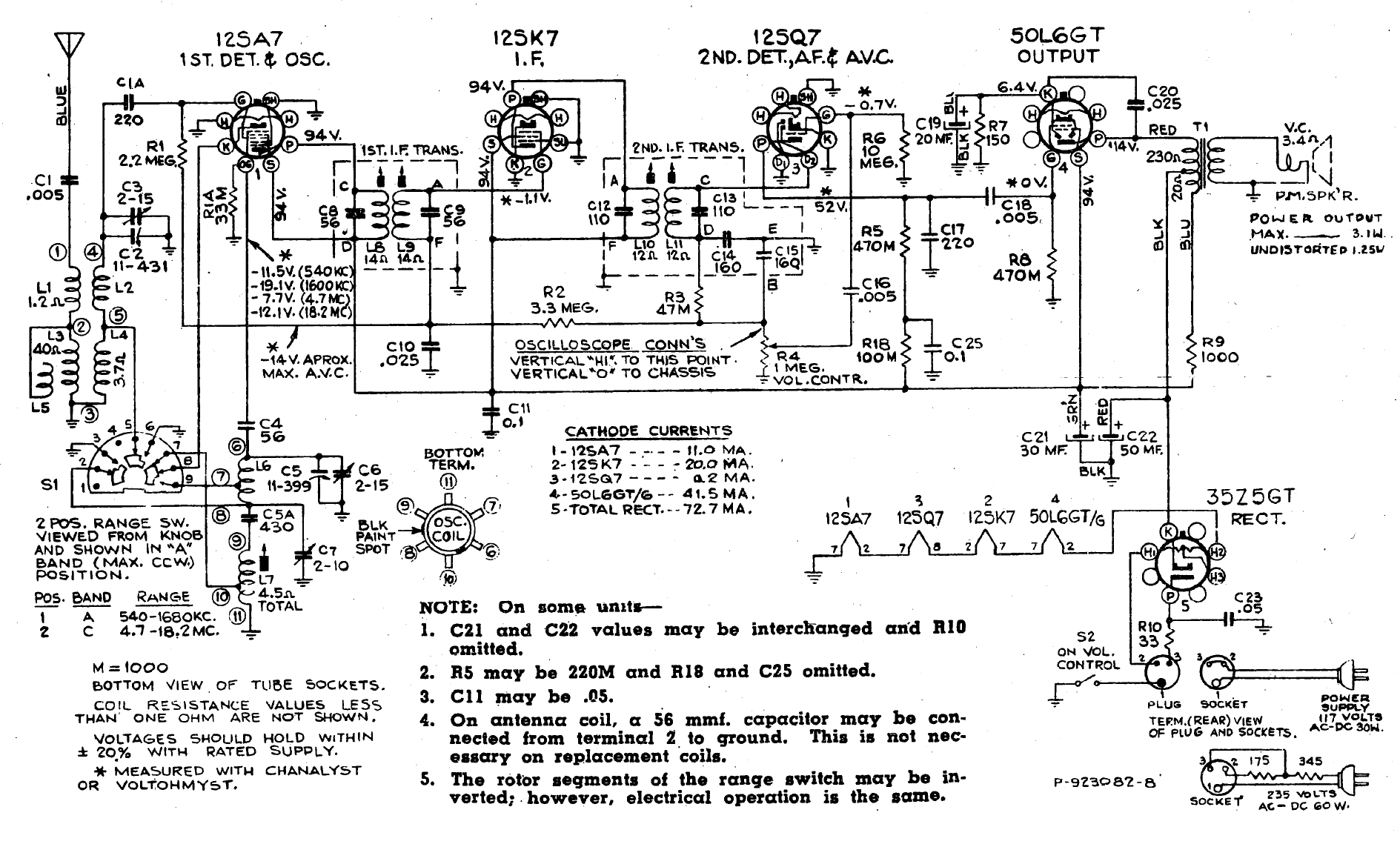

See the schematic below. Fortunately, RCA did see fit to include the value of the trimmer in question, which is C6 in the schematic below (2 to 15 pF).

Hello Ron. Would it be possible to re-tap the bakelite to the next larger thread size and use the appropriate larger screw? If not, and the room exists, replace with a new trimmer. Take care and BE HEALTHY. Gary
Gary - thanks. I have considered trying that, but I wonder if the old Bakelite can handle a rethreading?

Quote:I have considered trying that, but I wonder if the old Bakelite can handle a rethreading?
Well Ron, you don't have too much to loose by trying since you're contemplating replacing it entirely. You could also fill the hole with J.B. Weld, let cure and then drill and tap.
Ron
Without the pucture I am not sure what it looks line, but: if you clean the thread with solvent (degrease) , put some epoxy in, grease the screw and thread it in, so it comes out when you unscrew it...might do the trick.
Or put theflon tape inside and try to see if that works.
Pretty close to what John said with JB Weld.
Yes you got something to lose: the original cap. Backelite CANNOT be rethreaded.
Thanks Mike. (And John, and Gary.) That's what I was afraid of regarding the Bakelite.
I'll likely try the J-B Weld as I don't think I have any Teflon tape. Hmmm...I'll have to check and see. If it doesn't work, I'll add the external trimmer capacitor later.
This is a cheap radio, but it does have separate adjustments for low and high AM, which is unusual - most cheap radios eliminated the low end AM adjustment to save $$$$.
Theflon tape is the one used in plumbing.
JB is more reliable. Just a bit trickier.
I would not tap. Tap will exert pressure and if it is small old backelite puece, it might crack, even if you are retapping epoxy inside.
I would try fill it with putting a screw inside while it is still soft.
I know what Teflon tape is, I just don't know if I have any of it lying around. I will have to check and see.
Makes good sense re: adding screw to J-B Weld before it sets. I think I'll try the Teflon tape first (if I still have some around here, that is) - less messy than mixing and applying J-B Weld.
Don't forget to grease the screw. And when torquing it out, be gentle and hold that backelite piece so the torque doesnt apply to it.
I tried the Teflon tape. It holds the screw in place but it still won't adjust like it should.
I *might* try the JB Weld and grease when I am able to get back to the bench. In the meantime, two 1.5-15 pF trimmers are on their way to my place.
Good to see ya talking trimmers.
Maybe the tape protruded and didn't let the flexible part go all the way? Meaning: a bit too much of it was stuffed in?
Thanks Mike.
I first tried a little Teflon tape, and the screw would not stay in. So I added more. Then it stayed. But as you said, it might be too much. I don't know. I think the original screw is a 4-40 thread and the damaged hole is now big enough for a 6-32 thread.
When I'm home and feeling like going to the bench, I'll post a picture or two.

If you can tap it out cleanly to 6-32 or even 8-32 without creating any new capacitance between the screw and the housing, go ahead and do it. The cap doesn't care about screw size, only about proximity to the electrical components.
