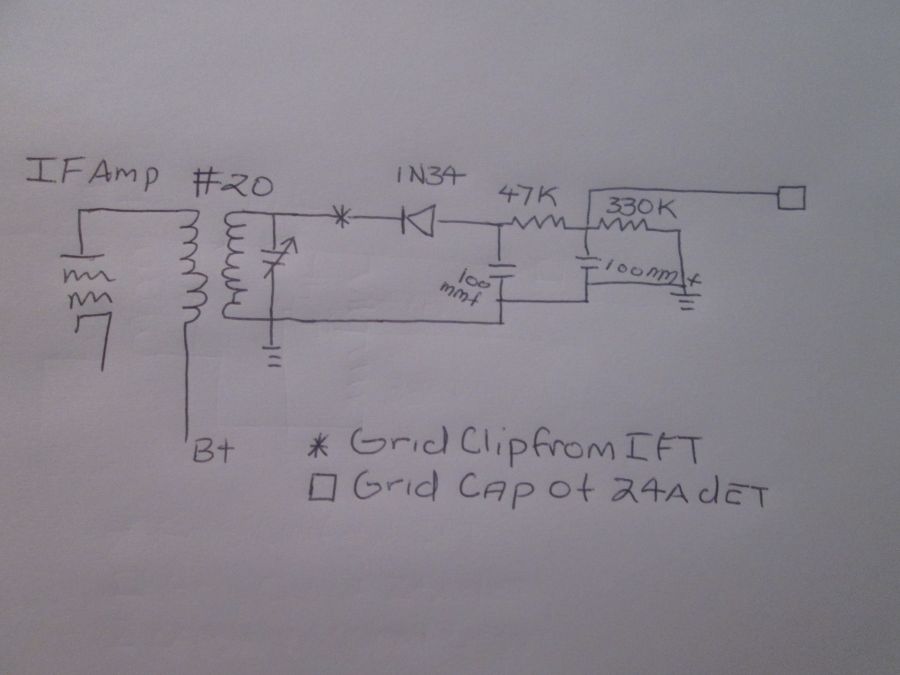

If you dislike the sound coming out of the 24a power detector here's a simple circuit at converts it to a diode detector. The audio recovery is much cleaner with little distortion. Requires just a few parts and can be packaged to be a plug in unit if you would want to put it back to the old circuit. Connects from the grid clip to the grid cap and needs a single ground wire. I tried it out on my 370 and worked great!
Nice! So you are leaving the filter on the plate of the 24 in circuit. I did the modification previously talked about on my 570, removing these components from the circuit, but leaving them in the radio for future reversion back to original. I may play with this on my 70. The distortion is annoying.
I did think about removing it out but it sounded good before I didn't any under the hood stuff so I left it in place. Was trying to keep it simple. Very little difference in levels between the two circuits so didn't have to adjust the value of the 51K resistor down to pump up the gain. The audio frequency response is better more high and lows. Here it is when I was giving it a test.

This can be assembled in a socket of a dead tube, so if one feels like restoring the radio to the original state, just remove this and put the tube in.
Not even that it could be in the small plastic tube with grid cap one one end, a grid clip on the other and a ground wire with an alligator clip. The parts could be a lot smaller than the ones I used, they were just what I had in the junk box. It doesn't connect to anything at the bottom the tube near the base.
I believe the 24 is still in use as an audio driver so where would you put the dead tube? I may haul out my 70 tonight.

A bit of raining on the good sound parade though: same as achieving better quality of sound by reducing the cathode feedback cap from, methinks, 0.5uF to 200pF, any such technique results in killing the PD gain. PD is, after all, a Class B amp. If it no longer amplifies, the sensitivity of the set will be noticeably reduced.
