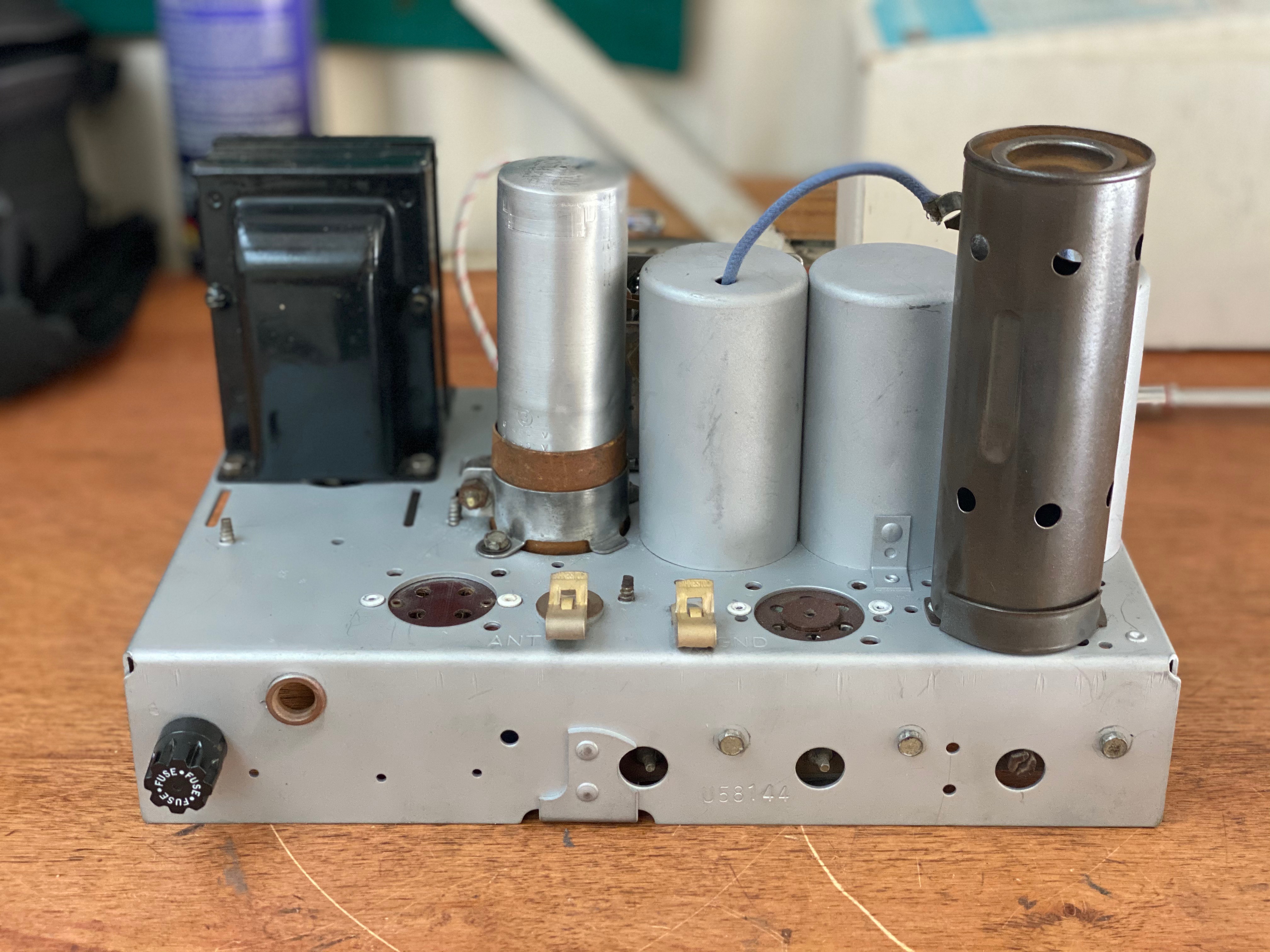

I am attempting to restore a 37-84. The chassis has been stripped and painted, the sockets and cap blocks have been replaced, the power supply has been repaired, etc. I am starting to rewire the chassis with new caps and resistors and The coils have been checked.

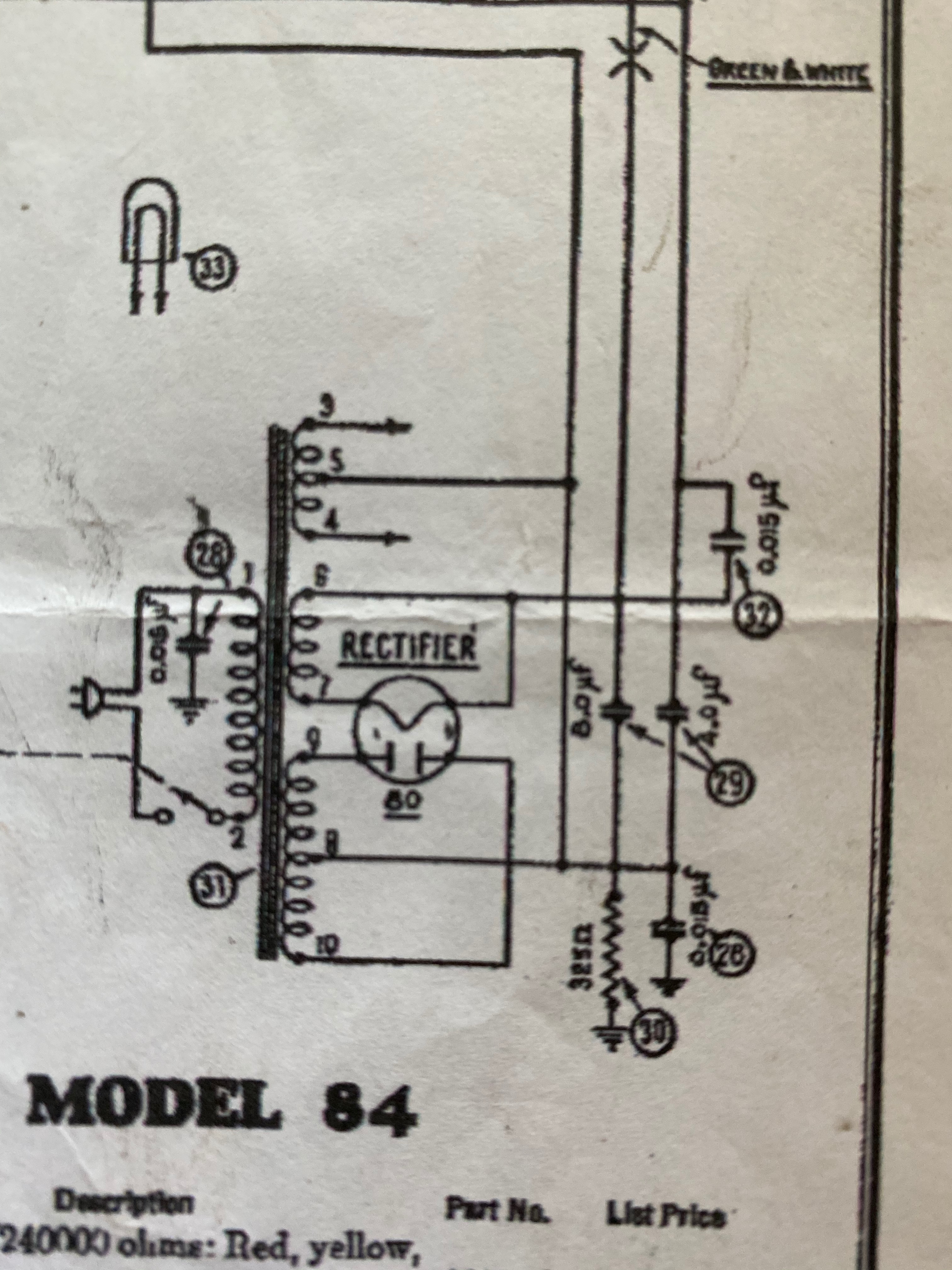

The power supply schematic shows a center tap (5) that does not exist on the power supply (32-7180). Another center tap (8) exists that are connected together. Is it necessary?

Forgot to enter photos of where I am in the restoration. I understand that the radio value may not warrant the restoration, but i'm doing this me myself, as a learning experience and because I like restoring old things.

The Code 122 version of the 37-84 (see: http://www.nostalgiaair.org/pagesbymodel...013225.pdf ) does not have that the center tap.  Are you sure you have the right schematic.  The model 84 is different from the 37-84.  The first being an earlier model, the second a 1937.

I updated my post as you were typing so check it again. I think you have the wrong schematic.

I am working on a 37-84, code 121. It uses an 80, a 42 and 2 - 77's. It's the same schematic as the 122, except that the tubes (which are essentially the same spec) are 4 and 6 pin tubes in the 121 and 8 pins in the 122. I tried to post the 121 schematic but can't seem to make it work. You're right, I see the center tap is not included in the 122 schematic. No shorts and good continuity on the tubes. I guess the only way for me is to fire it up and see if it works.

Tell you what will call it a model 84 it's got standard base tubes tube like yours. The tap on the filament is there to help cut down on the hum from getting into the detector stage. Don't ground any of the filament or pilot lamp connections. I would increase the value of the filters to 10 or 20 mf ea and add 20 or 25 mf to the bias filter too. Because of the det and the amp it needs p/s to be really clean from hum.
It's just a different way to do the same thing. The tap may work a little better not sure. When I've built some regenerative sets I've added a diode and cap to apply dc voltage to filament of the detector stage. This works well but there is about a half volt drop across the diode 6.3 down to 5.8v.

The schematic shows the tube filaments wired directly to the power supply. The chassis I am working with has the ground side of the filament power connected together and tied to a rivet to chassis ground. Does the filament power need to be above ground, or is it acceptable to mix the chassis grounds?  Thank you for the help. See attached images.

It looks like you have all of the pin six's grounded so one end of the heater winding would be grounded. The other end would connect to one of the pin one's of the 6v tubes. The center tap is left unconnected. The lamp would be connected in parallel with one of the 6v tube's heaters.
Thank you, I agree with your description of the grounds, however, ... is this correct?
If you are asking does it matter which way I connect it? As per the 84 diagram or the 37-84B code 122 I answered that before. I doesn't matter but it is important that if you  ground one side of the heater don't ground the tap also.

Question about the grounding. This chassis has the grounds connected to the chassis. The tube grounds are factory wired together and then to either a grounding lug or, for the tubes, connected to a socket rivet for grounding. This is the way I received it and it appears no mods were made to it since new.
So ... are you recommending I remove the grounds from the chassis and put them "above ground"?  Or leave them the way the factory originally installed them.
