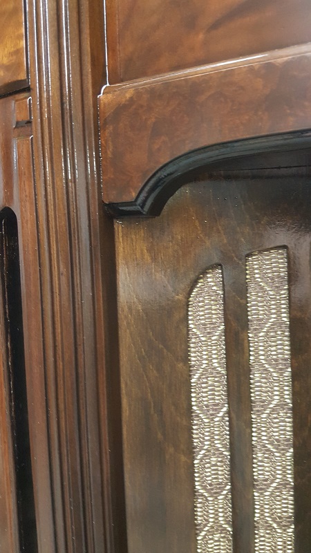

3 days into this zenith and I'm finished. New preproduction grill now available has been  installed, inside cabinet detailed and painted factory zenith blue. Custom color and toning done with grain filled veneered areas. Sealed and re sanded, 6 coats of mohawk semi gloss precat Lacquerer. No rubbing out. Outstanding example of a zenith console professionally refinished cabinet. Thanks for looking Fred Taylor Dallas tx

Stunning, very nice indeed.
