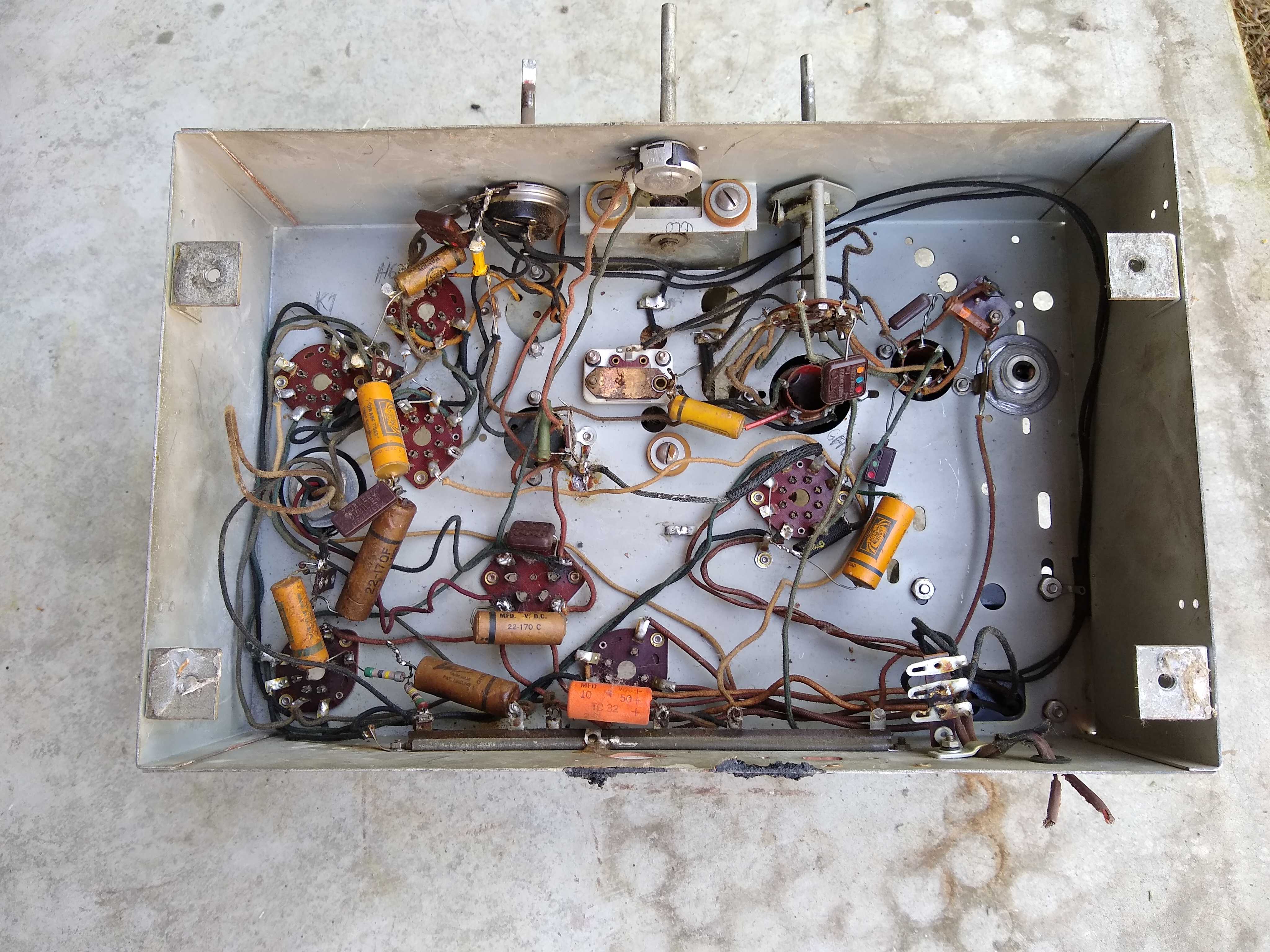

A little unpromising, as there is a speaker/transformer/field coil combinaiton to fiind. Otherwise, here is what I have found in the first assessment:
Power transformer seems intact, windings check out
There are a couple of extra holes in the back of the chassis - no clue what these were for (record player connection maybe, past tinkering)
Filter caps have been disconnected/bypassed at some time in the past, but the cans are still on the chassis
There are a few signs of past repairs/tinkering of marginal quality
The big "Candohm" or equivalent resistor along the rear of the chassis seems to have an open section.
The tuning drive belt is long gone, and a replacement would be needed.
After giving the chassis and cabinet a good cleaning to remove the antique dust and grime, the tuning mechanism received some attention. The dial was removed and and put aside for safety. Then I carefully dismantled the gear drive, cleaned and reassembled temporarily. It moves freely now.
I am very tempted to give this one the full treatment - I have always liked the big Zenith dials.

I think you are correct about the extra holes, one looks like it my have been for an AC outlet, the elongated one, the round hole was obviously intended for a jack. I think that Brand Z liked to use rebadged Rola speakers, painted gold or copper, the bracket around the field coils look like a Rola. I can see why you picked it up, the cabinet actually does not look that bad, and the chassis isn't a rustbucket, even if the transformer was bad it would not have been a great loss as X mount replacements are easier to find.

From what I see on the back of this radio ; the rectangular hole would have been for a slide switch
to go from radio to phono hence the initials 'R' and "p'.
The round hole would have been for the RCA jack for the phono.
I have seen this configuration on many radios, with the switch being in a rectangular hole.

I guess the slot could have been for a slide switch, though it looks like whomever made it either did not use the holes, or removed whatever they added some time ago. It's too bad that they defaced the rear apron by making a rectangular hole, round holes are easier to cover, but you could make use of the two smaller holes and attache a cover plate.

I have one of these, chassis only, Chassis 5619 out of a 6S52, same chassis as used in the 6S27. I don't have the cabinet or the speaker and wish i did! (Chassis was given to me by a teenager when I was a kid. He was going to use the cabinet and speaker for a guitar amp.)
However, it works fine with a transformer with an 8K Primary, 8 Ohm Secondary, 8 Ohm PM Speaker and 1 K Ohm Resistor where the field used to be (Schematic shows a 1K Ohm resistance reading for the speaker field). If going this route, up the Power Supply Caps to 40 uF. The output transformer in my set was salvaged from a Magnavox TV that had a 6V6 Output tube.
Nostalgia Air has the Schematic. God bless them, I know a lot of the scans on the N A Site are blurry but this one is as clear as day. Drawing is mid 1935, so Unit was for the 1936 model year. I believe that this is one of the first of the Big Black Dial sets. Resistance of all sections of the CandOhm and the speaker field resistance are shown on the schematic.
I believe that the screw terminals are for antenna and ground. The Schematic shows "Circuit changes for Phonograph. I don't know if Zenith ever manufactured the chassis with a phono connection or if what was added to the schematic was for a Service station to add. The Phono jack would not have been an RCA Jack, as these were not invented till around 1940 (RCA Radios of this vintage had a jumper and screw terminals. The Mod indicated on the schematic uses a DPDT Switch as it grounds out the detector output in Phono mode.
Good luck with the restoration, even if having to use a modern speaker. You will eventually score the speaker and until then, it will sound fantastic with a modern one.
