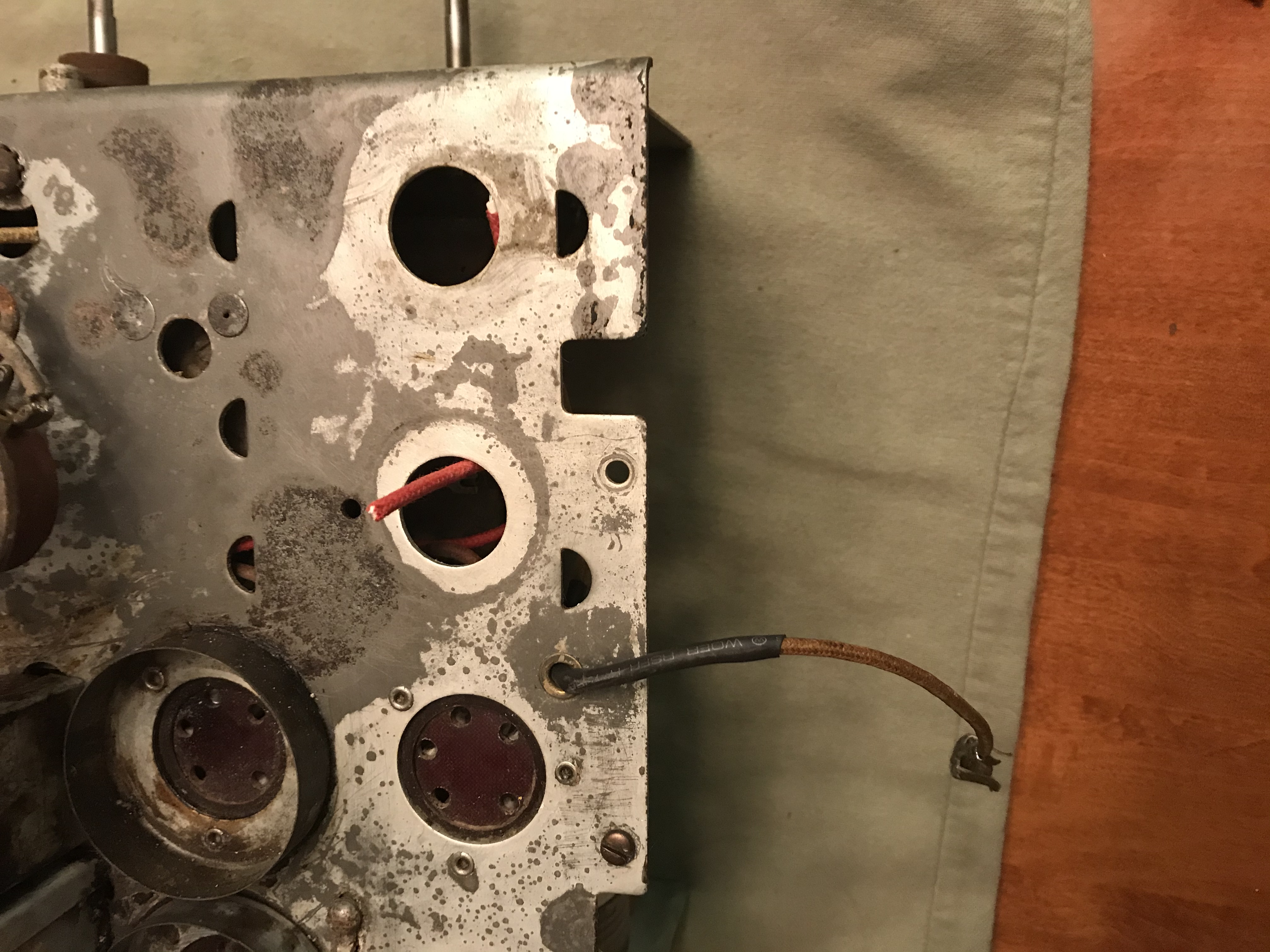

I have rebuilt the capacitor block, replaced resistors but have come to a dead end with the two electrolytics C17 and C18. I have nothing but two holes where these two caps once were. They may have been Mershon caps and someone removed them. I don’t know. My problem is I don’t know how to install my new caps and get the polarity correct. There is a existing unconnected red wire from the 1st Det coil that I assume went to C17 as well as another unconnected red wire from the resister terminal board that I assume went to C18. I’m assuming the + connections for C17 and C18 are these two red wires.

These two above photos show what should be there and how the Mershons did have a screw threaded base with a nut. The last photo shows my radio. There is nothing there. I could put a terminal strip underneath but as I said I’m unsure of how to wire it correctly.
At a later time I could glue some empty caps to cover the holes to make it look better but my concern now is how to install the new caps.
If you are not greatly concerned about appearances a terminal strip may serve very well. You can use a 3 terminal strip with radial electrolytics of 450 volt rating, and 10 MFD for C17 and 5 MFD for C18. The positive terminals from both C17 and C18 are tied together on an isolated terminal of the strip, and connected to the red wire from L4 on the 1st detector coil, and the red wire from the corner terminal on the resistor terminal board on the opposite side of the chassis. The negative side of C18 goes to chassis ground. For that you can use the grounded terminal of the strip. The negative side of C17 goes to the other isolated terminal of the strip and then to the second terminal in from the catty corner on the terminal board, where R10, a red (or blue?), and a black and brown wire attach. The black and brown wire goes to the center tap of the high voltage secondary of the power transformer, which is the most negative point in the circuit. I suggest you look carefully at each part and locate it on the schematic. This will begin to give you a better understanding of how to read a schematic in relation to the various parts. Another question, did you replace the bypass condensers in the block on the TOP of the chassis? The connections are shown in a little schematic on the right hand side of the wiring diagram. They are in a box on the TOP of the chassis labeled in figure 3 as part 15, Capacitor Pack, R F bypass capacitor pack. You will need to replace these also.

Look at the schematic. one side of the field coil of the speaker, labeled as a blue wire on the SCHEMATIC, goes to the negative terminal of C17 and the center tap of the high voltage secondary of the power transformer, as well as one side of R10. That wire labeled "blue" on the schematic seems to be the red one shown on the wiring DIAGRAM, which goes to the "reproducer terminal board" and from there to the negative side of C17. Trace these wires on the wiring DIAGRAM, and then carefully compare them to the SCHEMATIC, and you will see what I mean. It should become clear then that all these points, the second in terminal on the resistor board with R10, and the black and brown wire and the red (or blue) wire, and the negative side of C17 all are directly connected, and should have virtually no resistance between them. I think part of the confusion comes from the discrepancy between the DIAGRAM which shows a RED wire, and the labeling on the SCHEMATIC which says BLUE. I really never bother worrying about colors much since they are mostly so faded on the wires these days that they all look brown. Instead I just trace where they are going.

I followed Mike’s plan as far as the hookups for the terminal strip as well I did run a wire from the same isolated terminal up to the speaker. All good! The radios working. The only thing I need now is a tuner roller since the one that’s there doesn’t work. Not sure who sells them. I’m not even sure what its called.
