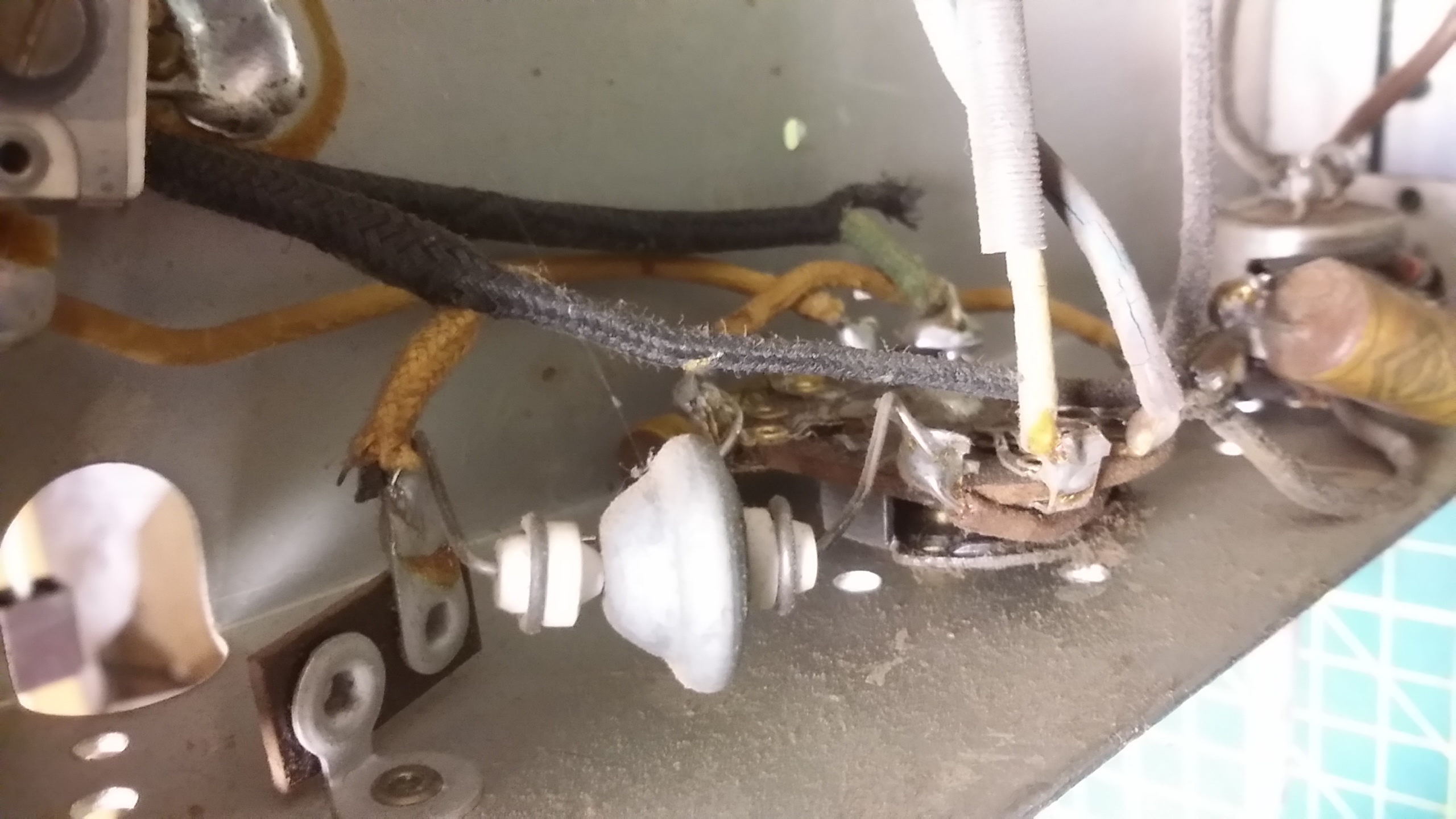

The chassis was very dusty but also has had some work done to it in the past.
[Image: https://www.dropbox.com/s/kq9yvpcnnw0hij....jpg?raw=1]<br />[Image: https://www.dropbox.com/s/s07v335j9ve70s....jpg?raw=1]
This set uses a battery as a bias and a "replacement" Ray-O-Vac had been soldered in. There is a white pincher like device that is also connected to the same place the battery is so I suppose that it was the holder for the original bias cell although I have never seen one before.

Here's a bias battery for an RCA 28T set I worked on. I replaced it with a lithium button cell.
[Image: http://philcoradio.com/phorum/images/smi...on_eek.gif] Chris

I believe the bias battery can be eliminated by altering the cathode bias and adding a grid resistor of a high value. At the time of production, stable high value resistors were not available for that service. The battery was a relatively reliable alternative and will often out last the 5 year life of the radio as no current is drawn... chas

Thanks guys. Appreciate the photo of another bias cell holder OZ4! I'll probably also try a button Li battery and think about the bias mod Chas suggests if it all works when I'm done.

Just my two cents, you could also buy a single cell battery holder for an AA cell, and make any future changes simple. Once you rebuild the original electrolytic cans, and get rid of those big orange replacements under the chassis, there should be a whole lot more room. If you don't bother with re-stuffing the paper condensers, but just go with the yellow poly condensers as is, you'll have even more room. Should be able to find a place for an AA cell holder pretty easily.

The watch batteries work but the polarity is the opposite of one of those vintage Mallory bias cells. With the style I run into in Rogers sets, the kind with the cylinder that fits the domed side, the cylinder is negative, and the spring contact is positive, so you have to rewire them to use the modern watch batteries which have the case as positive. I don't think the availability of one type of resistor or another had much to do with why bias cells were used, I've never seen a radio older then 1936 that had them, the newest set I have seen with them was a Canadian Marconi set from 1941. They claimed that it was to simplify the power supply, but since the usual method was to place a resistor, and cap, in series between the cathode of the tube, and ground the parts count would be negligible. I'm guessing that it was either to create a service item that would create extra business for repair shops (keep in mind that other then electrolytic caps the paper caps seldom needed replacement when these sets were under 10 years old), or that it was a scheme to avoid paying patent royalties. Weird that a Stromberg would use one, all the ones I have encountered do not, and Stromberg didn't care about patent royaties, they just paid them.
