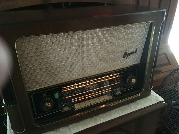

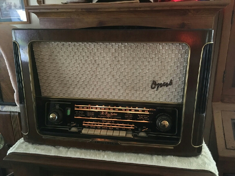

I picked up this Opus 6 yesterday
Talk about a sweet sounding radio.  Wow this thing sounds good. Superb reception as well.  Best I've had at my place where many of my other radios have trouble The cabinet is in excellent condition as are the glass knobs and buttons. 6 speakers, all working.  I've been on the hunt for a nice one for a long time. My search is done.
