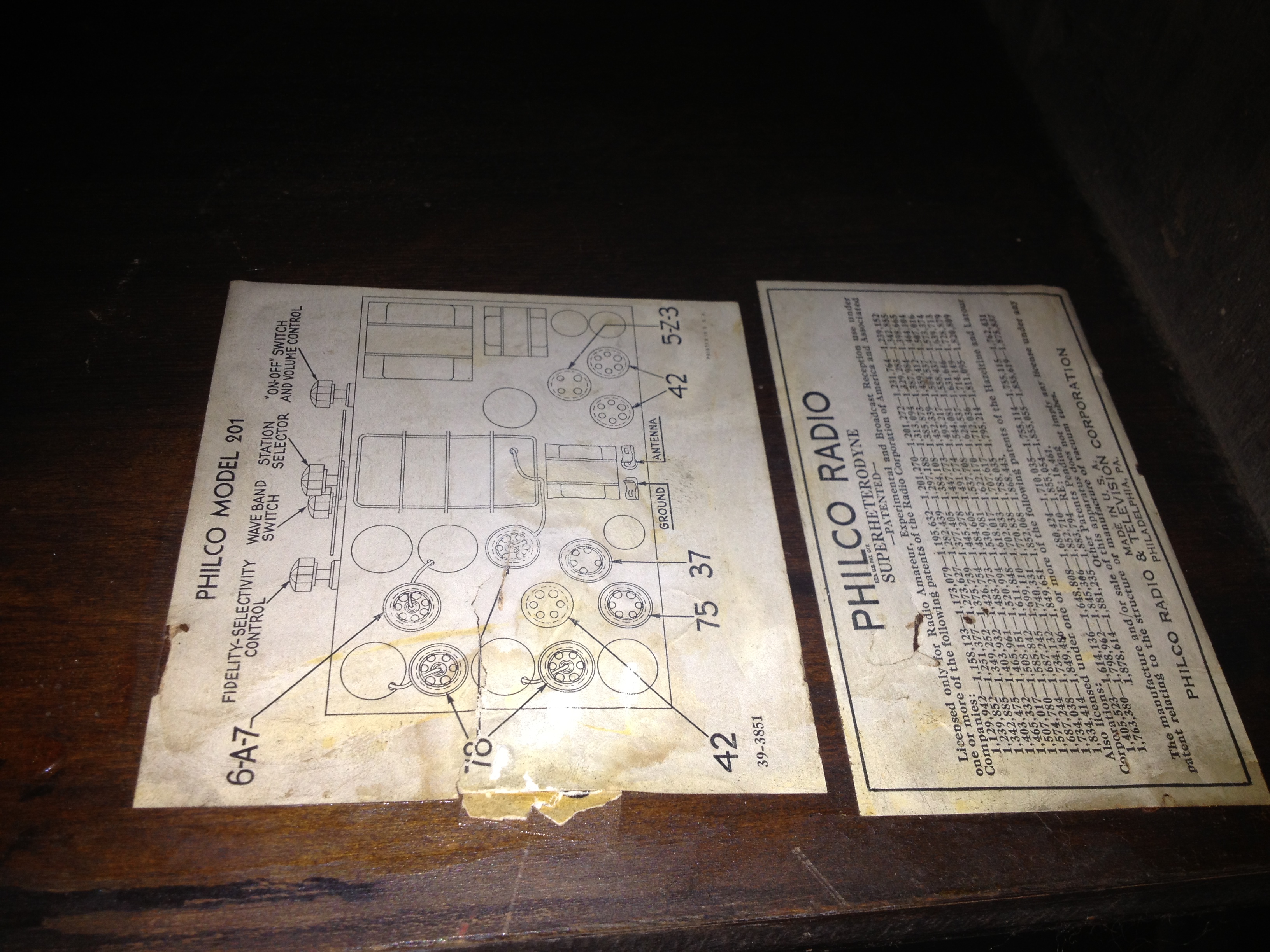

Also, I saw the thread you link to as well. Interesting because My 201X is in the right cabinet but as you can see there appears to be a label under the one on mine as well. They are stuck together, so can't tell what the one under it was. Hmmm

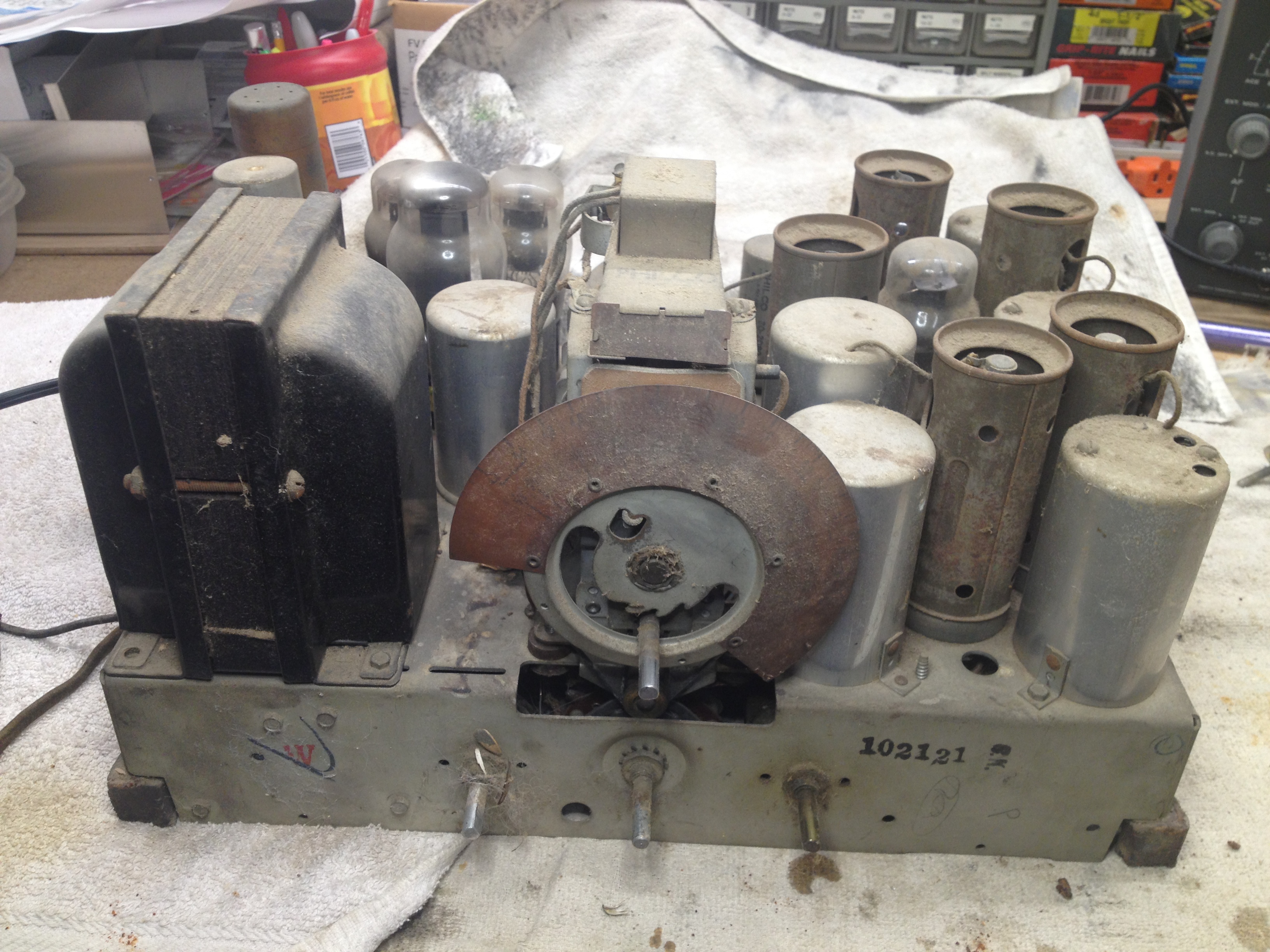

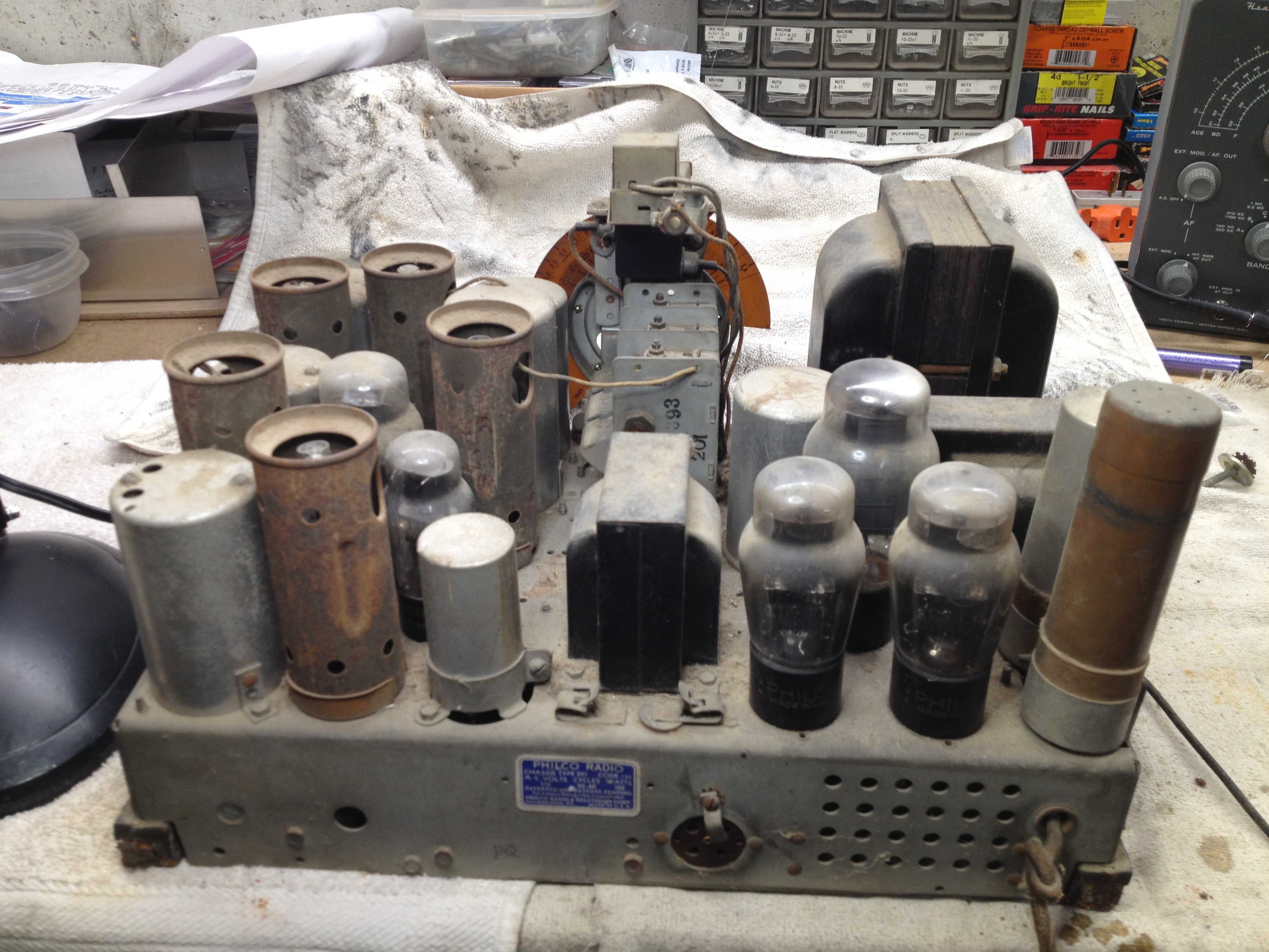

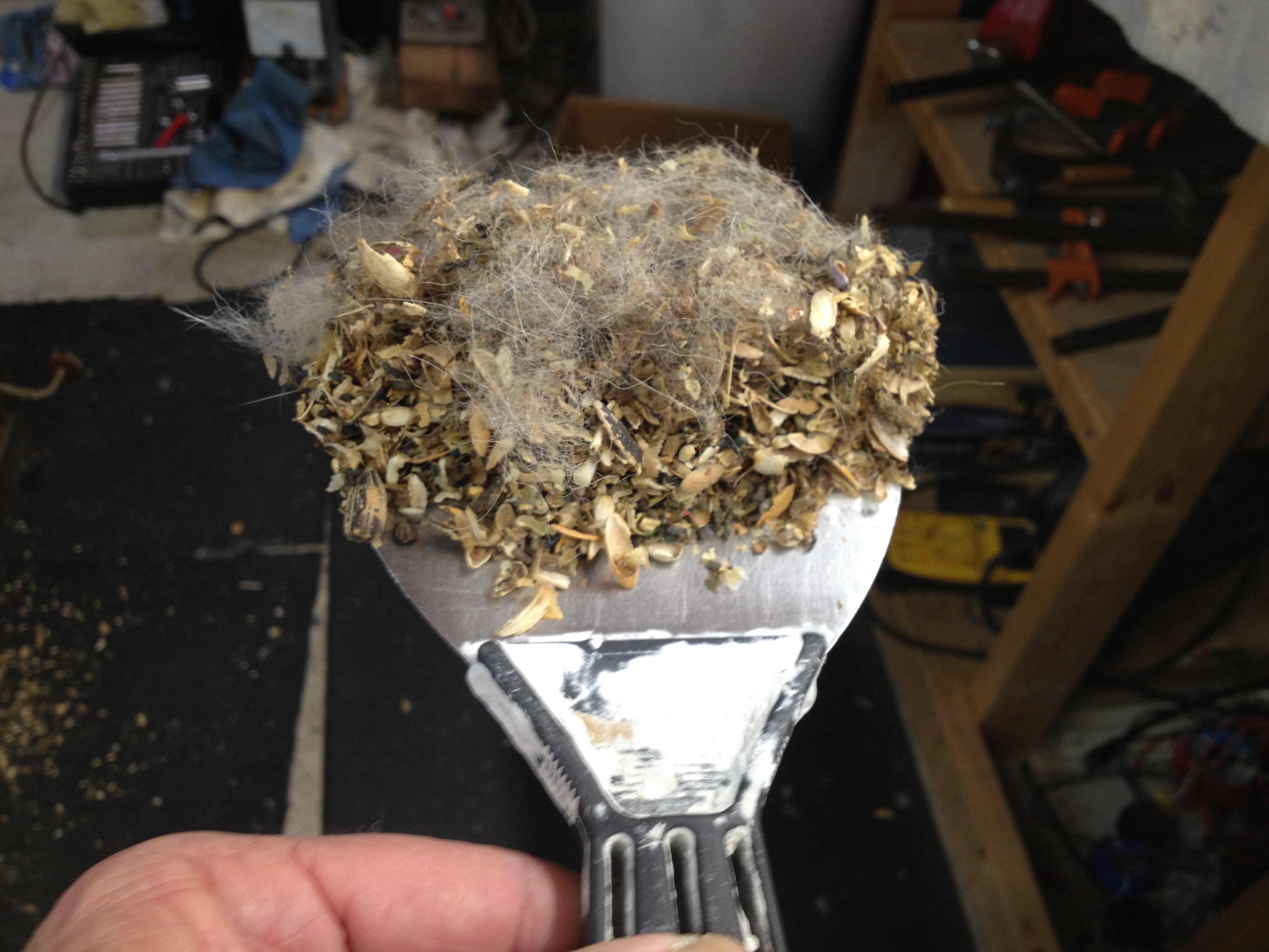

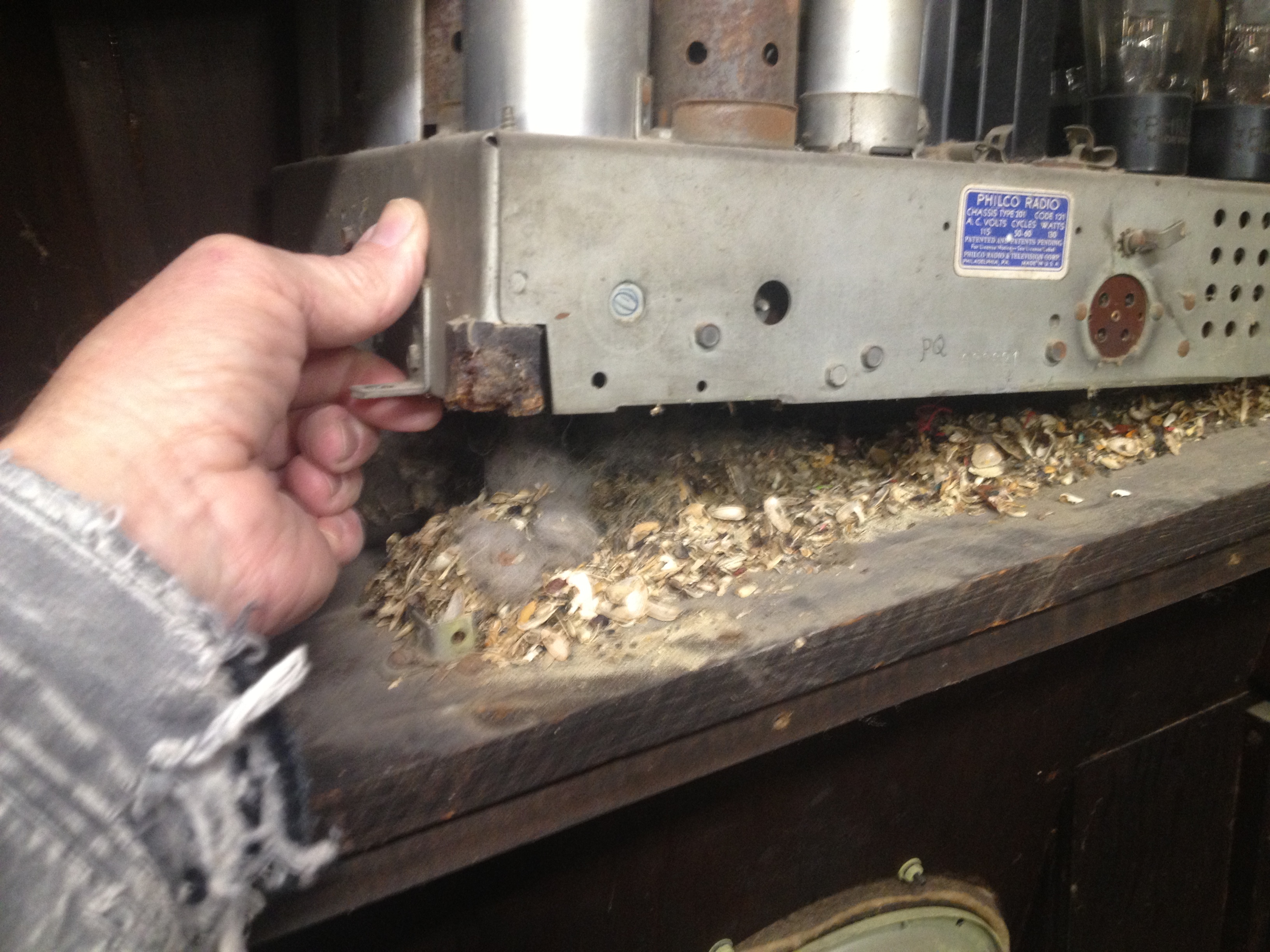

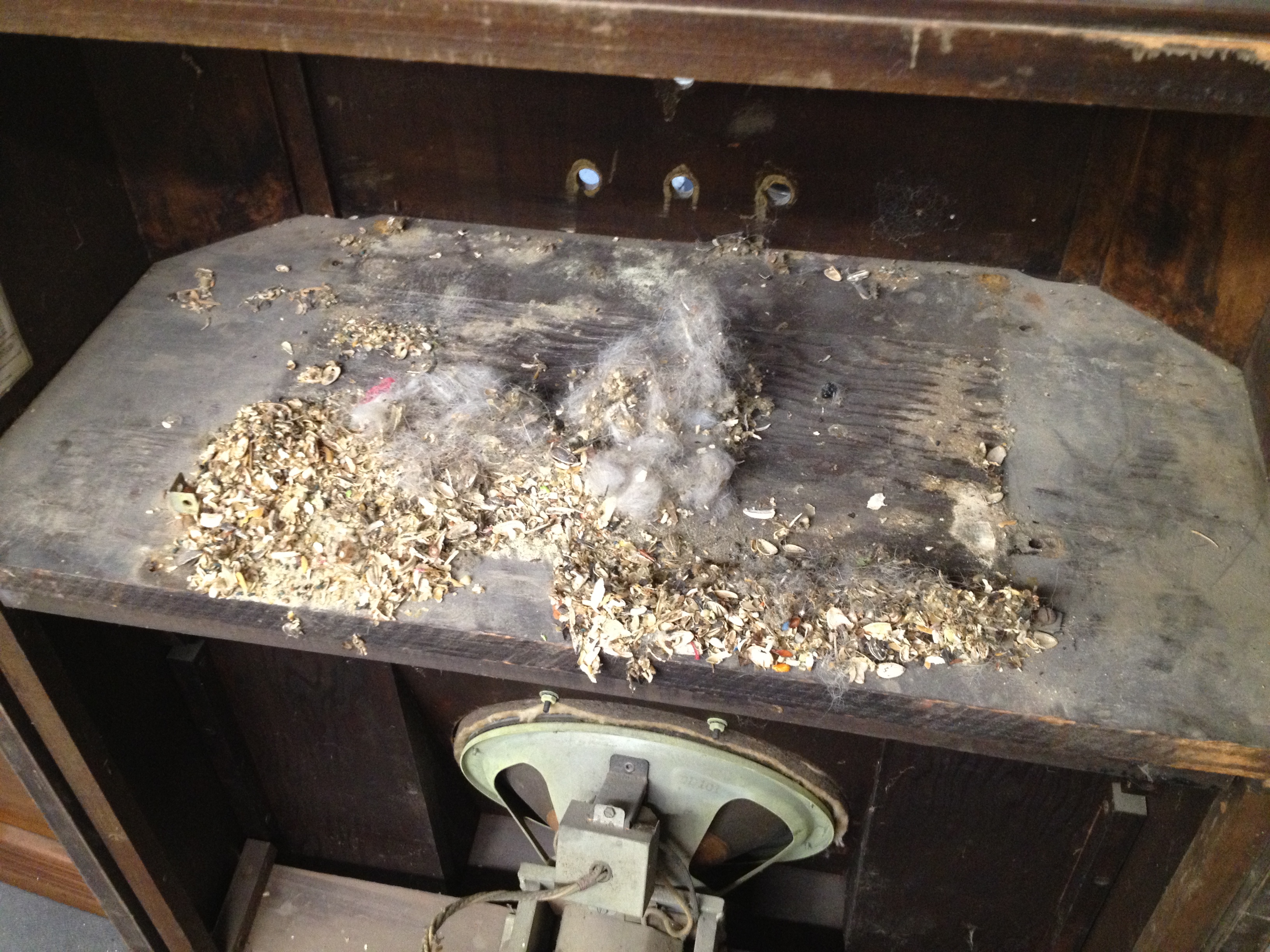

Like all of us when you get a new Radio, we hope that it's unmolested or at least not to badly. I had high hopes that would be the case with this one, but. Before I even got the chassis out, I could see that wouldn't be the case.  In this case it was the 4 legged molester.
            Hungry anyone ?

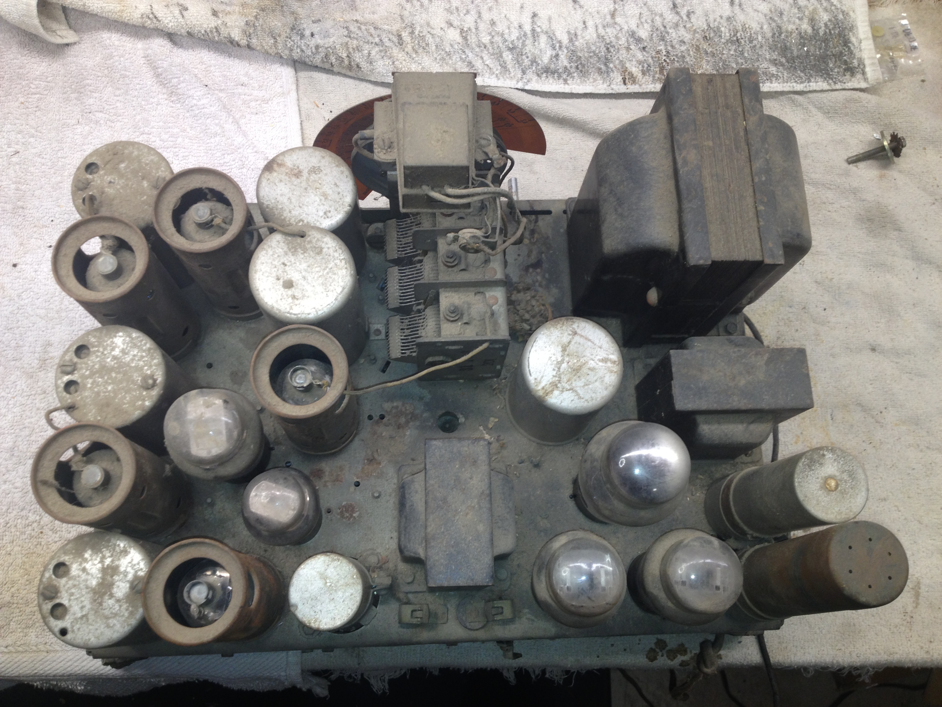

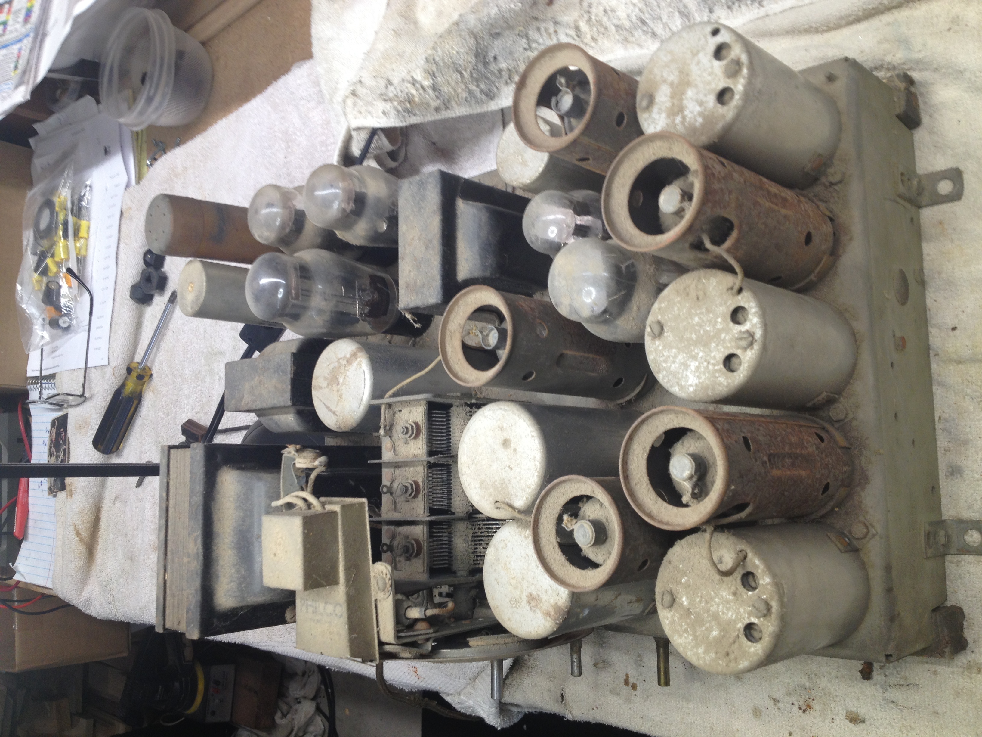

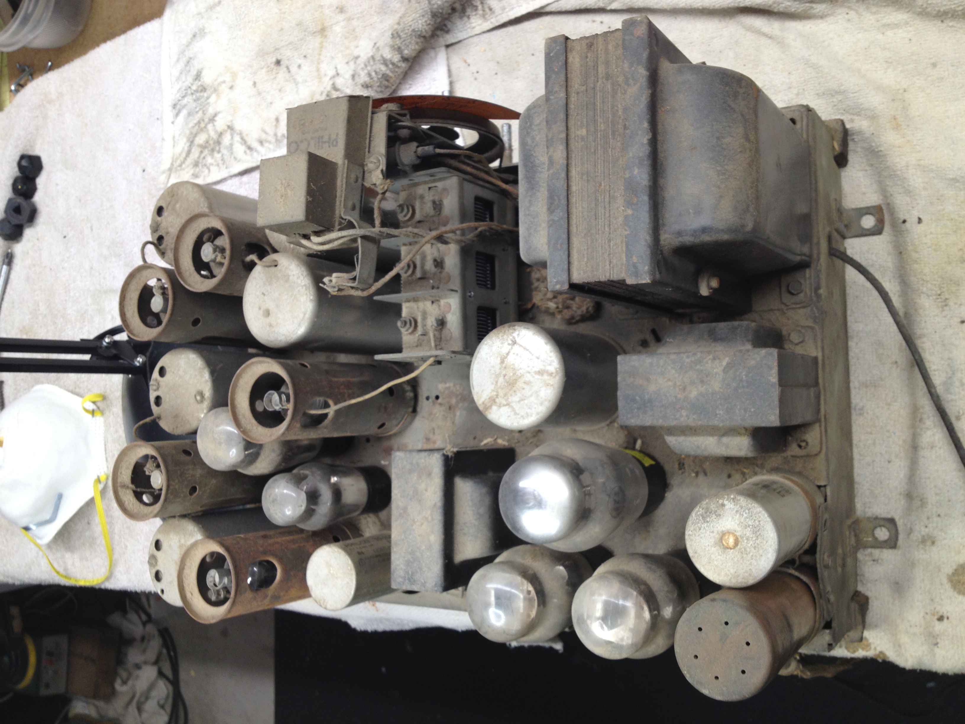

A few photos of the top side
Grungy but not the worst I've seen.

I understand Mike, when I got this out and started looking it over, it quickly became apparent  that this was going to be a project. Apparently when the critter's sunflower seed supply dried up, it decided the cloth on the wire would do. He chewed  a bunch of the wire on the right side and others, Bare. Glade I read the many posts on this site about not plugging these in until checking them out.

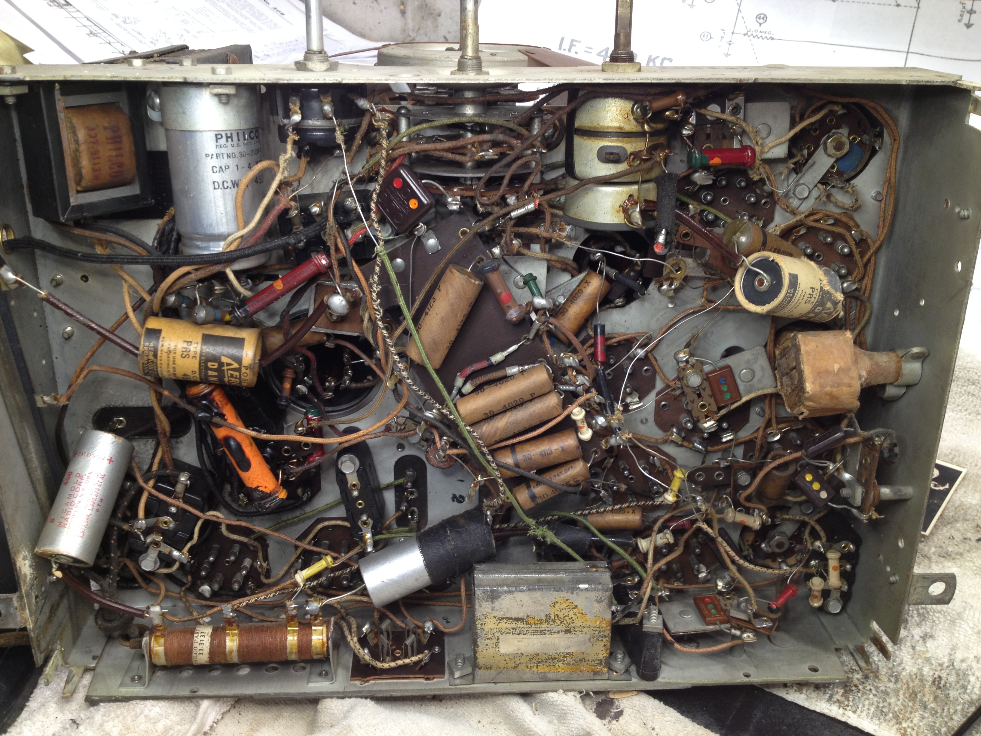

The critter wasn't the only one in there, as you can see, someone must have had a supply of 8mf caps because they replaced everything that was bad with them, including what were only 1 & 2 mfs.

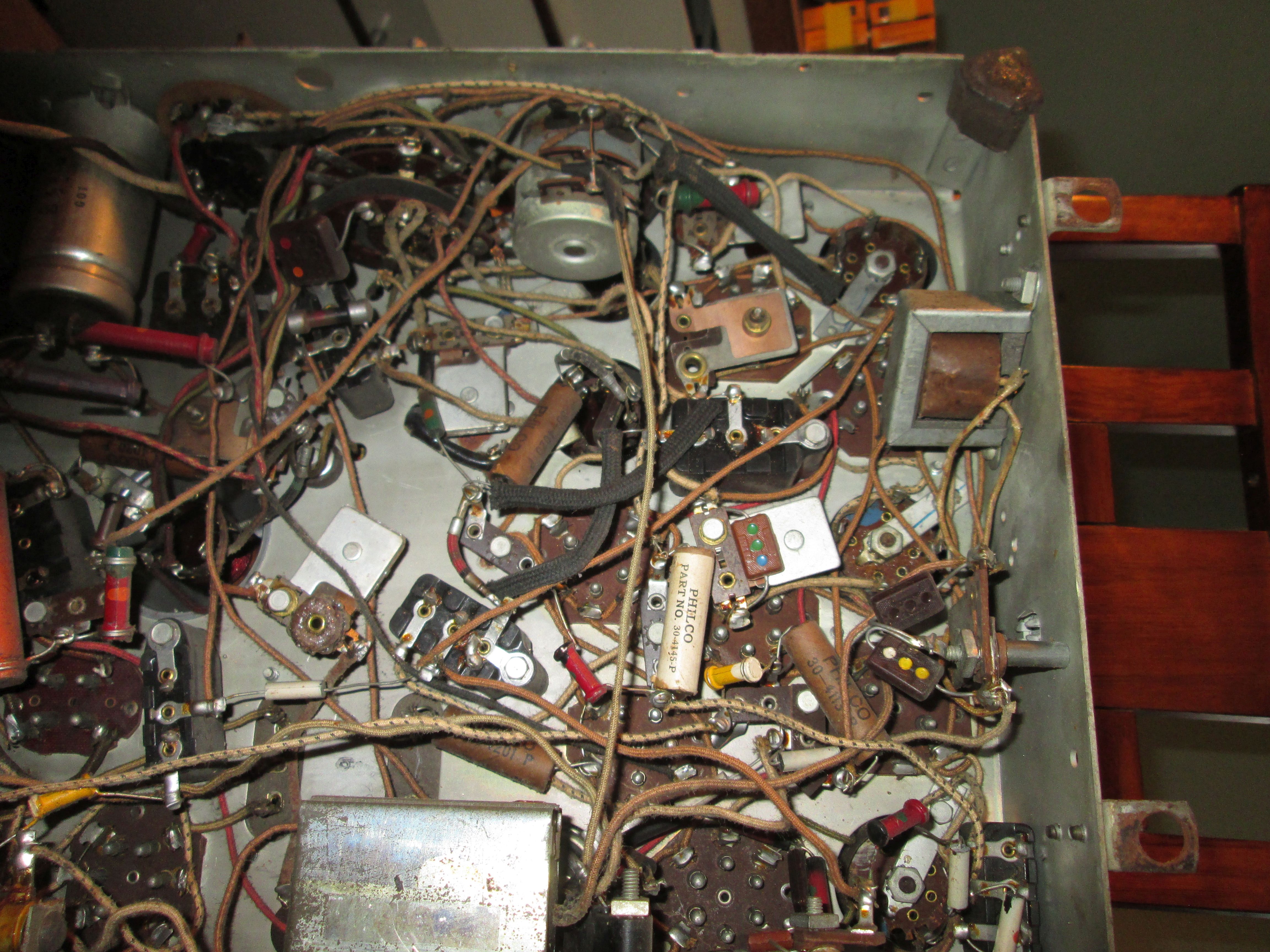

Here's a truncated pic of the bottom of my 201. You can get an idea of the color code of the wiring.
A couple of interesting things about yours. One, I order info on the 201x from Chuck Schwark, one of the sheets he sent showed revisions to this unit and a later revision said that they removed the phenolic board in the middle with all the caps on it, and used Bakelite blocks instead. Is yours that latter version ?

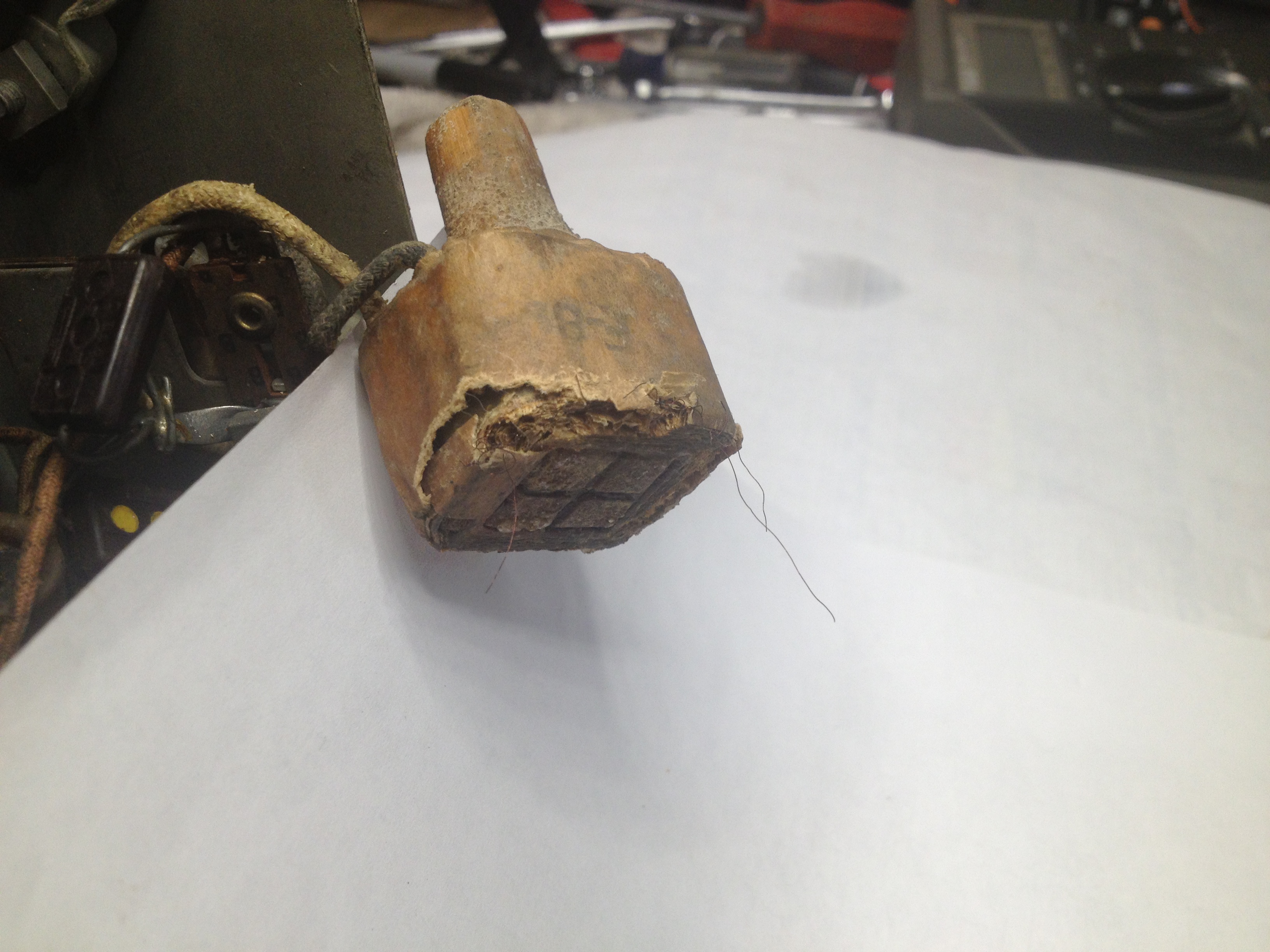

Also, if you look at mine, on the Right side wall of the chassis, is a low pass choke part#70 (see pic) it's part of the 10KC filter trap, after the 75 first audio tube, to keep nearby stations from bleeding in, when using the High Fidelity, as I understand it. It also appears to provide resistance for the B+ of the 75 tube plate.  Is this coil in your unit ??    Also curious to me is why they used a chunk of wood for this  Icon_think
Unfortunately the 4 legged critter didn't stop at the cloth on the wire, but proceeded to feast on the bottom of this coil. What really, really stinks is that he broke through the windings in 6 or 8 places essentially trashing it. Icon_evil I've been debating for sometime what to do about it. I've read many threads on rewinding transformers but haven't seen anyone attempt one of these. My gauge is saying it's 40 gauge wire, very thin. There must be 20 layers or more, with a very thin paperlike layer between each one. This is just one of the dilemmas with this unit I'm hoping to get some advise for. More to come.
I don't have any info on revisions so I'm unsure about the changes throughout the model's run. Mine doesn't have a phenolic board just blocks. I just assumed that since it was in a previous models cabinet that it would have had one of the first of the next models chassis.

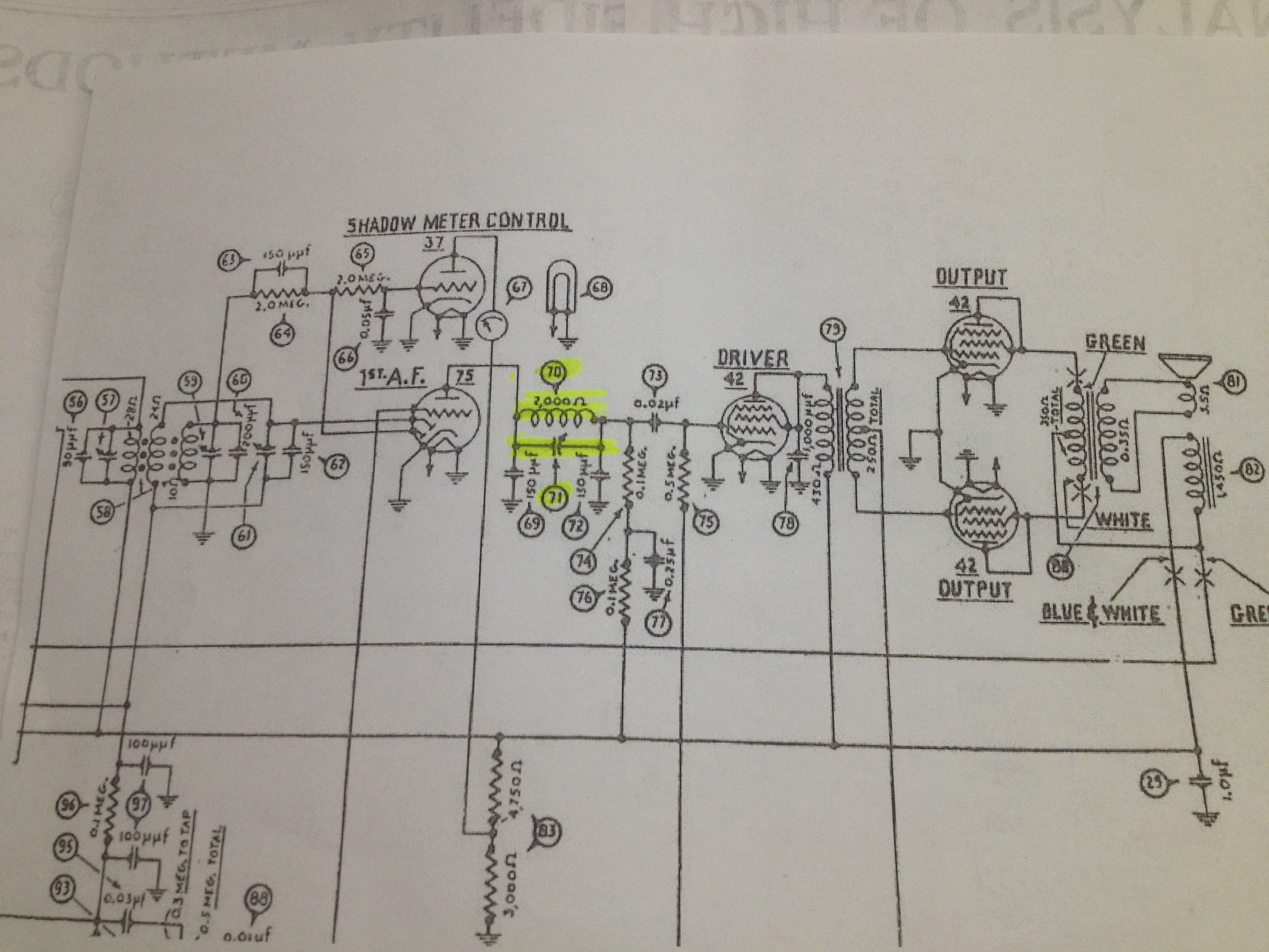

The choke should be relatively easy to sort. Just have to calculate the proper inductor by using the known frequency and capacitance. As to why it's on a wooden form could be that it was cheaper to fabricate. Philco had a few bean counters and this was 1935, actually designed in '33 even worst money was tighter then.

You mention that the inductance can be calculated. but this is where my limited knowledge comes in. Can you help with calculating the inductance with the attached schematic? The coil that got chewed up, is part #70.  It together with the Comp. condenser #71 forms the 10KC trap (Highlighted)  I'm not sure if caps #69 & #72 play a role in it or not.
Also, I assume the coil would need to be close to the 2,000 oms shown, to set the B+ voltage to the plate of the 75 tube  Icon_question  Any help here is greatly appreciated!
