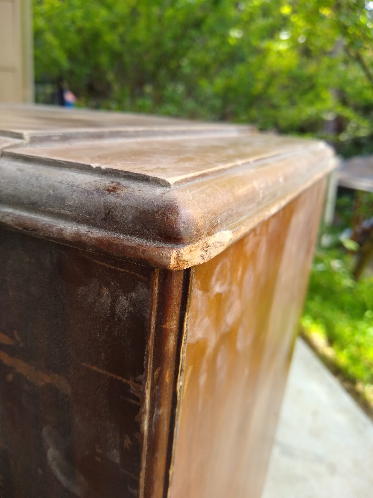

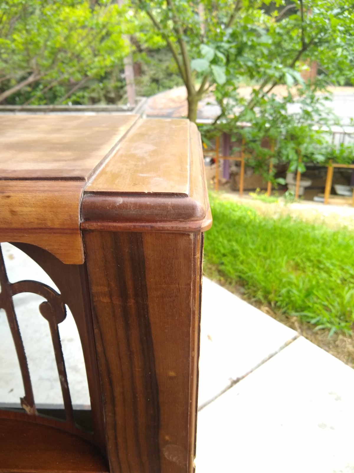

Cabinet work this weekend. I don't object to some patina, but chunks missing are another matter.
The surface was carved and worked flat, to enable gluing of a repair piece.
Careful carving and sanding restored the profile. Staining and detailing will ensure a match. I'm pleased with the results so far.
