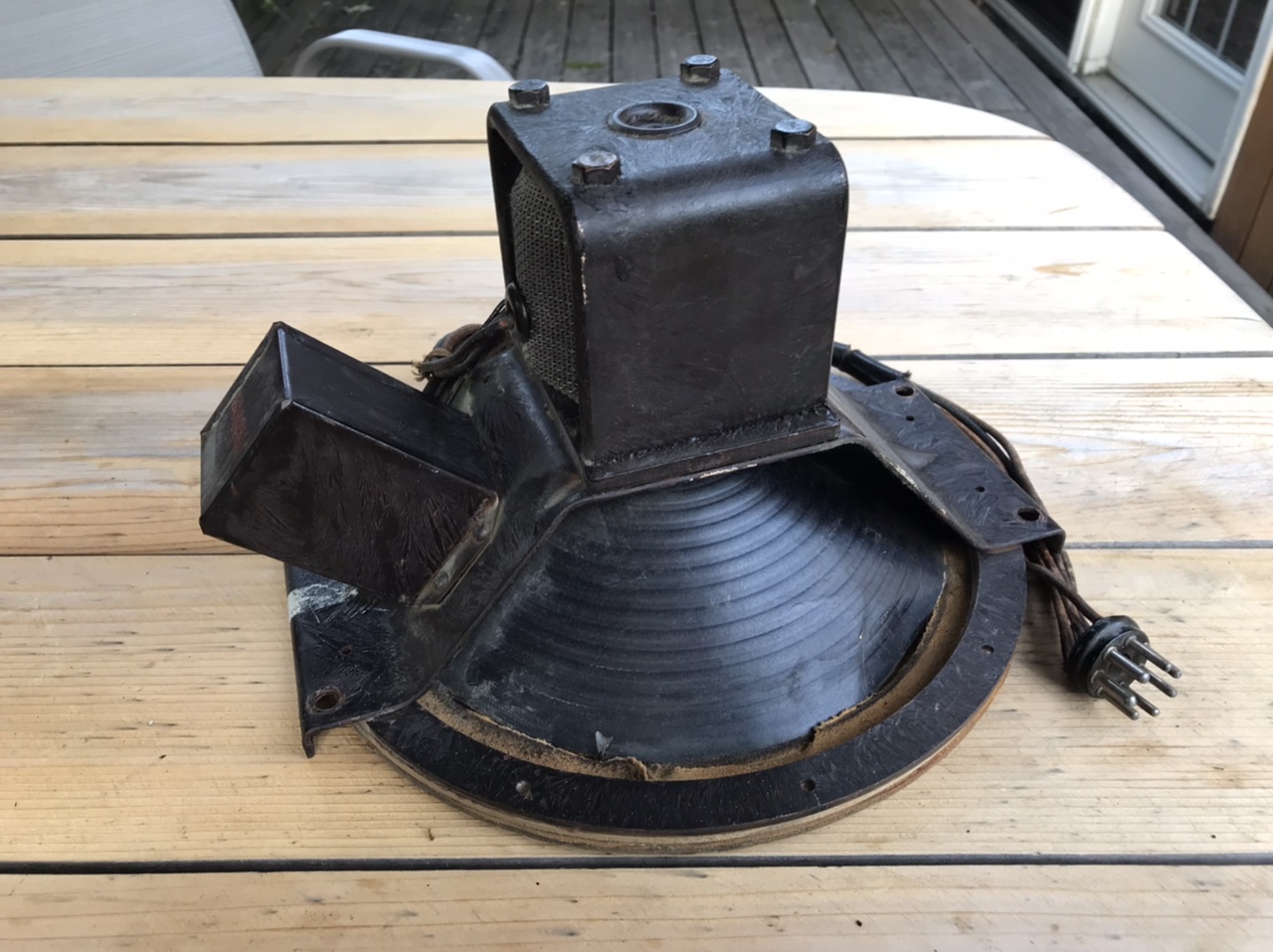

I don’t know how to test a vintage radio speaker. I have read of a “click test” with a 9 volt battery but I don’t know how to do it. I have Stromberg Carlson 62 speaker that I want to test. I have no idea as to where to place a 9 volt battery to do the test. Also I’m unsure as to where to place my multimeter probes when testing a speaker or what the approximate ohm readings should be, to indicate it’s good, if I test using my multimeter.

Looks like you have an electro dynamic speaker. This is a speaker that has a coil of wire that connects to the radio's power supply to create the magnetic field, generally known as the field coil. Modern speakers use a permanent magnet. The field coil is the big coil on the back of the speaker. The device on the side of the frame is the output transformer which sends the audio signal to the voice coil that moves the cone and creates sound. You can use the multimeter to check the field coil which should measure several hundred up to 2000 ohms. The other 2 pins are the transformer primary and should measure several hundred ohms. You can try using a pair of test leads connected to the primary and momentarily connect a battery and you should hear clicks from the speaker. If no clicks then connect your 9 volt battery to the field coil. Then try momentarily connecting another battery on the primary.
Continuation: So when you get this far and still no clicks then double check your connections. All you want to do is send pulses into the transformer primary and get clicks from the speaker. I noticed that the transformer is a push pull which means the primary has a center tap. You can send pulses across any pair of primary wires. When you test the primary with your multimeter be sure to test both halves. They should measure close to the same resistance.
If you don't get clicks then one or more of the coils is bad, including the transformer secondary or the speaker voice coil. Let us know how it goes.

I did get a small shock when connecting the 9 volt to the two wires coming from the field coil but no click from the speaker. The resistance there was measured at 1.05 K.
I’m confused as to what you mean when you mention the two pins to test the primary transformer. I measured between points from 1-2, 1-3, 1-4, 2-3 etc on the photo and the most I got from any combination was 2.0 ohms. I’m not sure where the two pins I should be measuring from are.

You are getting somewhere with the measurements. The field coil should measure around 1000 ohms. Follow the wires from the coil to the connector and measure the coil. If you have a printed copy of the schematic you can note the terminal numbers of the speaker field on the diagram. The remaining terminals will connect to the output transformer.
