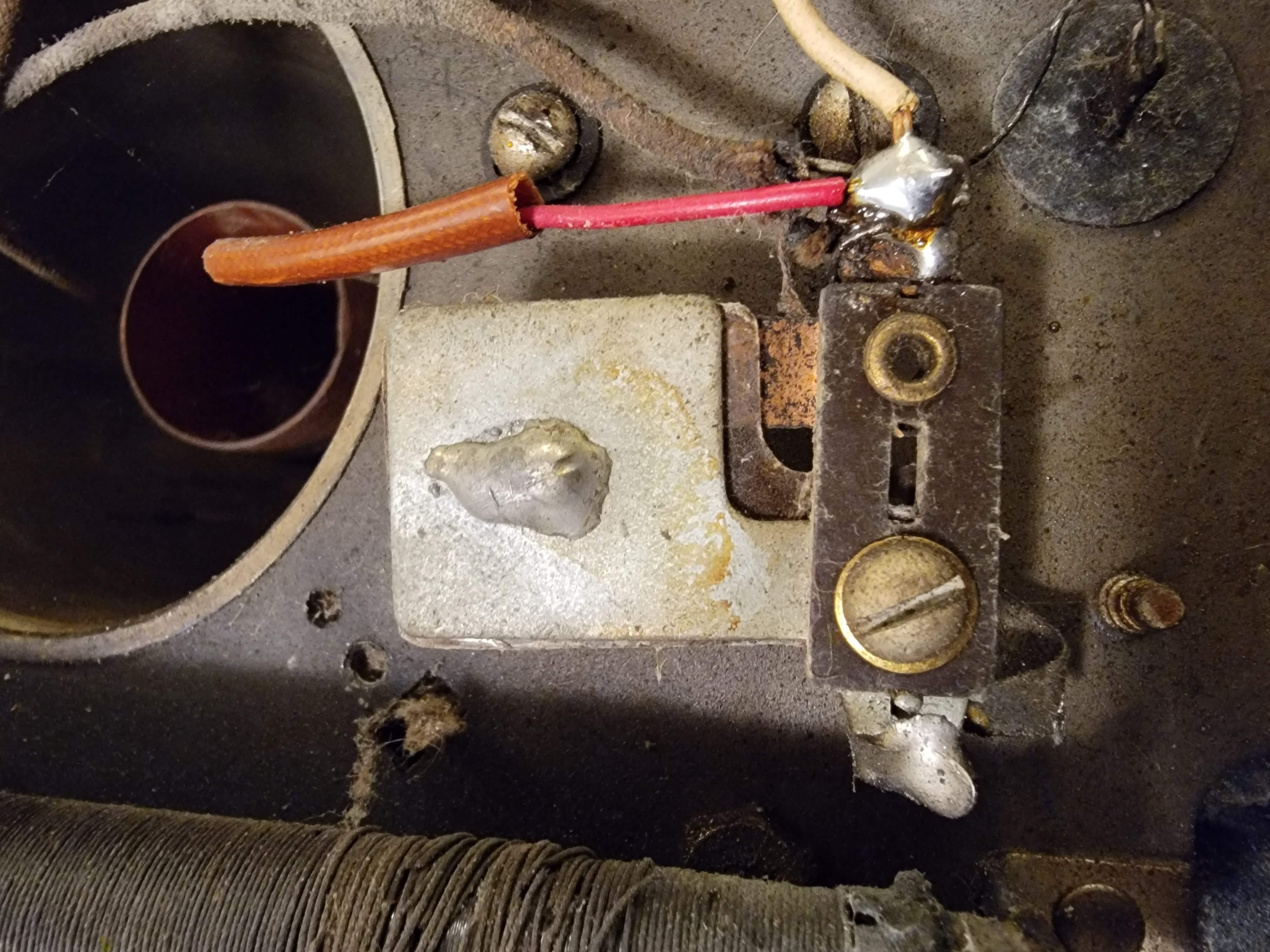

What are these:
The wiring diagram lists them as "compensating condensers", part # 3772-A...
Posts: 1,797
Threads: 55
Joined: Feb 2015
City: Roseville, MN
Looks like a mica capacitor. There's a thin slice of mica between the metal plates. If you trace the wires back then check the schematic to find the correct value. Looks like one side is soldered to gnd.
"Compensating condenser" is correct. Also known as a trimmer capacitor.

Any idea what has been done to the rf transformers? Specifically, it's the first two that I am on now...
They have been attached to the top of the cans, instead of at the bottom (like the other two).
As well, the first appears to have had its secondary completely removed:
In that first pic you can see the bulk of the modifications that were done to it. My knowledge of old AM radios isn't the greatest...but from what I can see, it appears as if the first RF transformer has been turned into an inductor tied to one end of the first compensating condenser (along with the antenna connection) and ground. The cathode connection of the first RF tube has been disconnected.
Any idea what whoever worked on this last is trying to do?

So the modifications done to this set seem to be around removing the antenna transformer. Everything is the same, except the removal of R1 and R2, the primary(?) of the first RF transformer, and an additional small cap between the first and second compensating condensers. I'll try to get a scematic up with the modifications!
I would really like to have this set in full working order! I think I'll have to rewind the primary on that transformer
So...what are my options? Does anyone here know what the correct number of turns is? Is there any way I could figure it out, without prior knowledge?
