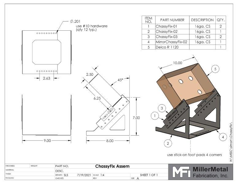

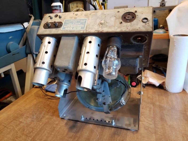

Here's an idea that I hope you can use.  Another engine stand!  But, it is very strudy and (I hope) adaptable. Works good on this little Delco.
Easy for a fabrication shop with an NC laser or plasma and sheet metal brake. I have model and .dxf files if needed. I suppose you could do this by hand with a bandsaw and drill press.
The Prototype looks a little different than the print, because I lengthed the Front 1", and the Back 1" for better Center of Gravity and roll to the top without hitting the knobs.

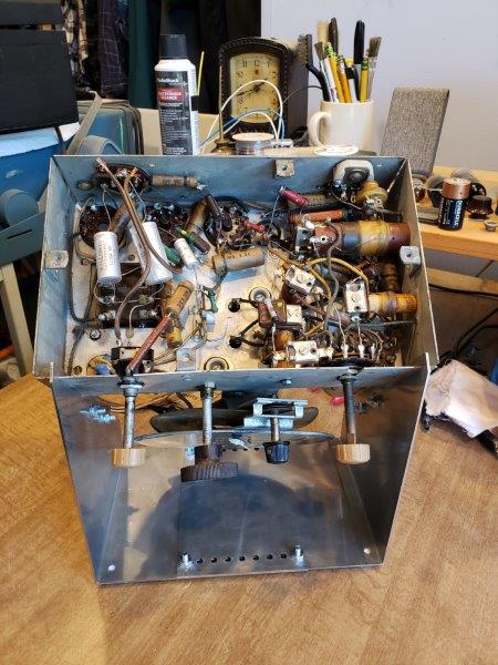

With that stand you could really get your face in there. Careful for getting solder burns on your nose.
Maybe I need stronger glasses (to save my face).

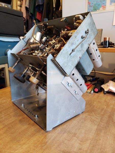

If you see a chassis that this won’t work on, lets see a picture. Maybe I can accommodate.

Thank you Henry; I'm having some made; plus I added some height adjustment (see attached)
