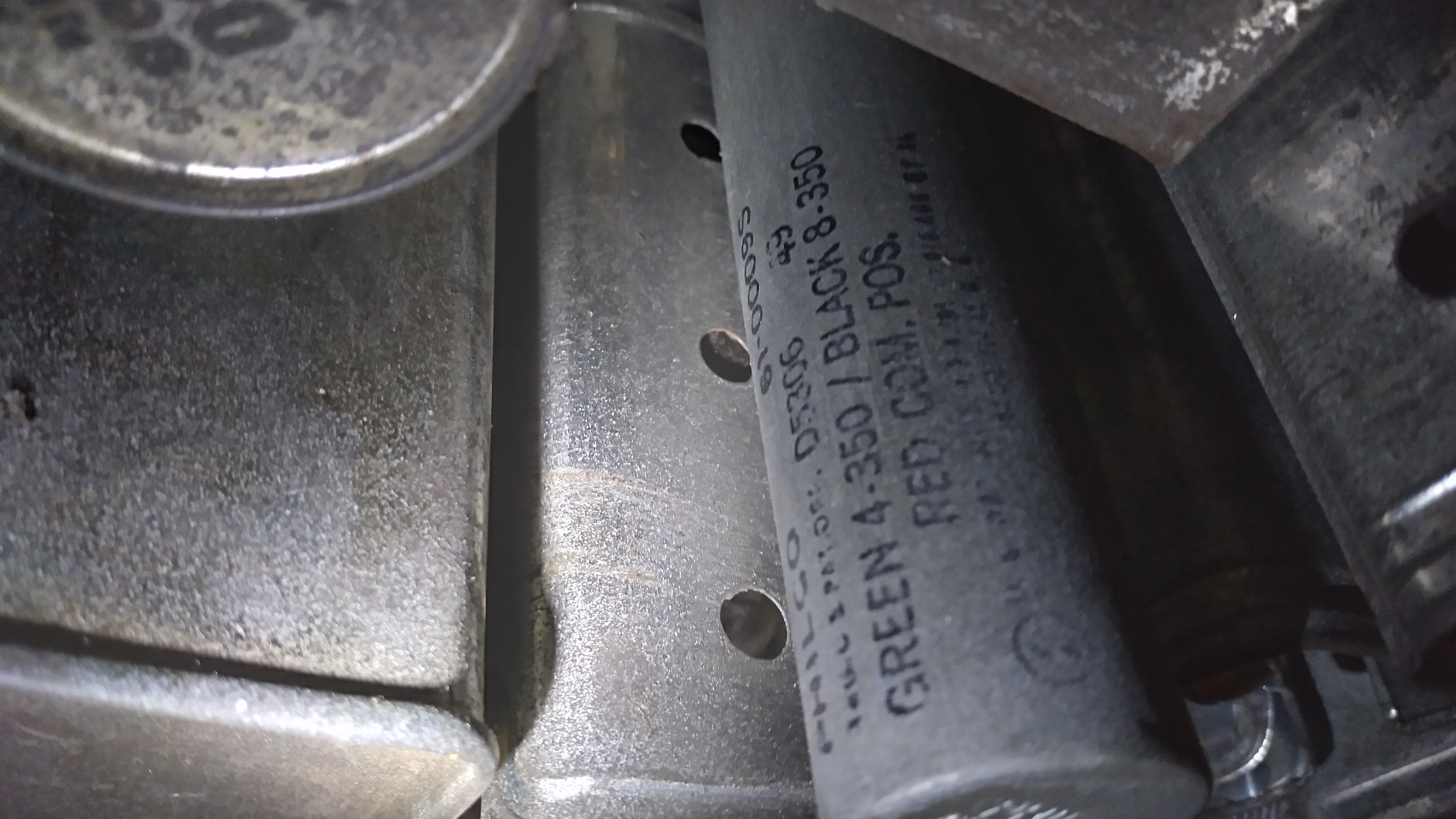

Thanks was wondering if could go up.I meant to say tin can.My bad.Will probably go with 4.7 and 8.The can says 4-350,black 8-350,and red com.pos.

common POSITIVE ? That is VERY unusual in a multi section condenser. What model radio are you working on? I need to see if I can find the schematic. I don't want you buying the wrong kind of condenser and having it explode because it was polarized wrong for your circuit !

I have picture of cap but not sure how to download.ok figured it out.
Thanks for the picture. It is very interesting. There are obviously 3 wires coming out from the condenser, red, black, and green, red being the common positive. The closest match I find seems to be on page 26 of the condenser section of the Philco parts list from this site, page 26, bottom of the page. I looked back through the catalog, but this is the only match I find that meets all the criteria. It would also help to know the model this chassis is in to get a better idea of the date. There is a HUGE amount of data on the main site, of which this Phorum is only a part. Use the LIBRARY there, and you can find the parts lists and find any part Philco used. You can also find copies of the original Philco service bulletins, with the schematics, parts lists, alignment information, notes of changes, and any other needed information for each model.
Accordingg to the schematic for a C1608, the capacitor is indeed a dual section, common positive and the negatives are split by a choke in the negative buss.

I looked at radio and now I understand what you meant.I ordered two capacitors.1 4.7 uf 450 volt and 8 uf 450 volt.Should I put in can or just put underneath?Again thanks for all info.
