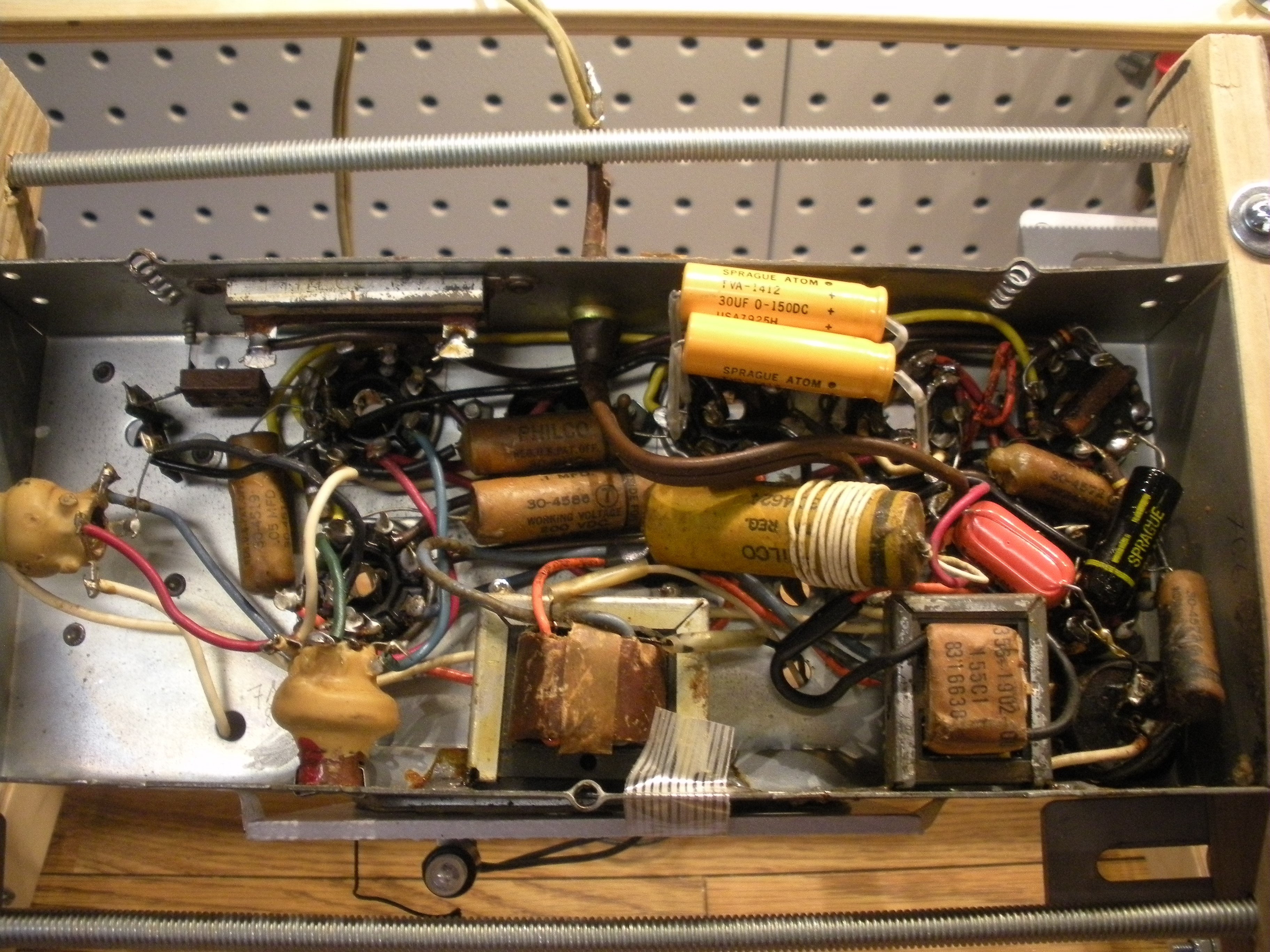

A few updates on my HUM  issue and asking for input.  After changing out all of the tubes after testing and no improvement, I added an additional 10UF to the PS filter caps no help.  My question,, Since the Radio was converted to a PM and the the mod still has a coil in place for the filter caps vs changing to resistors , I decided to check that "choke?" transformner.  The schematic indicates 500 ohms resistance .  Isolated Mine is reading 2 Ohms.  ///  Note this is not the output coil... its a transformer inserted when the EM was removed.  vs doing the resistor mod.

Ok so help me understand what you are saying.
>Since the Radio was converted to a PM and the the mod still has a coil in place for the filter caps vs changing to resistors , I decided to check that "choke?" transformer.
The "coil" you mean the field coil? So you have the back half of the original spkr and the pm spkr together? True be told there is 3 coils on the electrodynamic spkr. Voice, hum bucking, and field.
The transformer doesn't really have much to do with the power supply or filtering. It's there to match the impedance of the plate of the output tube to the voice coil of the spkr. In this case about 2000 ohms to 3 ohms.
If you are measuring the resistance of the field coil and it's 2 ohms that's a problem. It's darn near a dead short. That will make it hum. Replace w/a 500 or so ohm 2 or 3w resistor.
I'm thinking your hum is from that transformer doing a poor job of filtering. Looks like a shorted winding. You should be able to disconnect the winding and temporarily connect a resistor of 800-1200 ohms, 5 watts. Leave the added filter capacitor in the circuit.
Rod
Do you mean field coil rather than transformer?
Did you add the extra 10UF at the first or second Ecap?
Mike, It sounded to me that a transformer primary had been wired in as a substitute for the choke. Probably couldn't handle the current.
RodB  you may have described it better than me.  I am sending the original photo and you will see 2 transformers solderd to the chasis.  1) goes to the speaker and the other is in the circuit between the 2 electrolytics.
