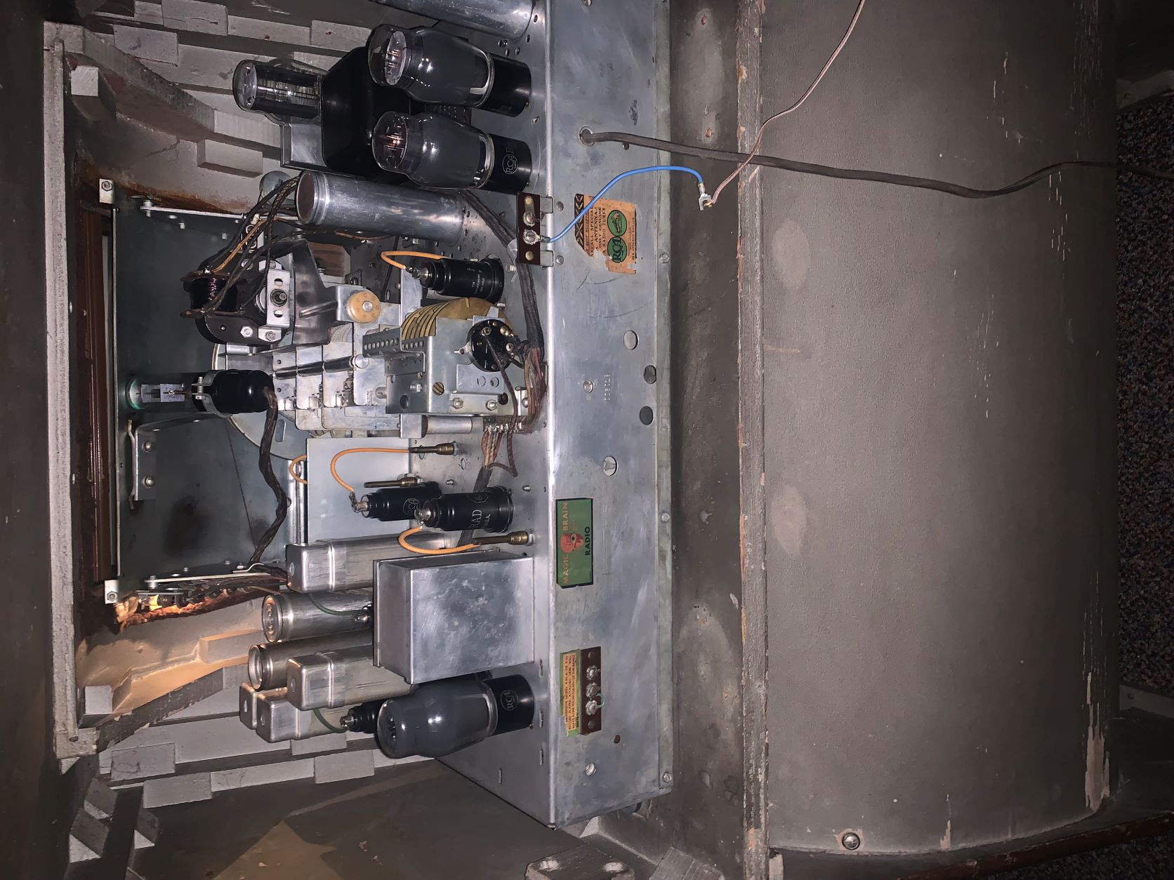

Hello everyone, just got done restoring my latest acquisition a RCA 813K console radio that I picked up in February in northern Kentucky. I normally don't collect RCA radios but I liked the looks of this radio and I'm very pleased in how well it plays--it is loud and has lots of bass. I didn't have to do any alignment and compared the spread-bands dial accuracy with my Tecsun PL-660 and the frequency accuracy was excellent. It did take me 2 days to clean the chassis as it was very dirty and I replaced most of the rotten rubber wiring. Overall, I'm very pleased with the radio and now I need to get a RCA 816K next Icon_biggrin    Ken

Very nice... How did you get the radio chassis that clean? Good job. It must of took some time to get it to look like that.

It took 2 days to clean the chassis using WD-40, nearly 400 Q-tips & a terry cloth--it cleaned up nicer than I thought as it was quite dirty originally. I had to rewire the fidelity switch back to what the schematic called for as someone in the past rewired it and it didn't work right when I first tested the radio. The cabinet is in excellent shape which is good as I'm not good at woodworking. This is the first RCA in my collection as I mainly collect Philco radios and have 2 Scott 800B sets and 2 Magnavox console radios. Now I'll have to find an RCA 816K to go with it.   Ken
