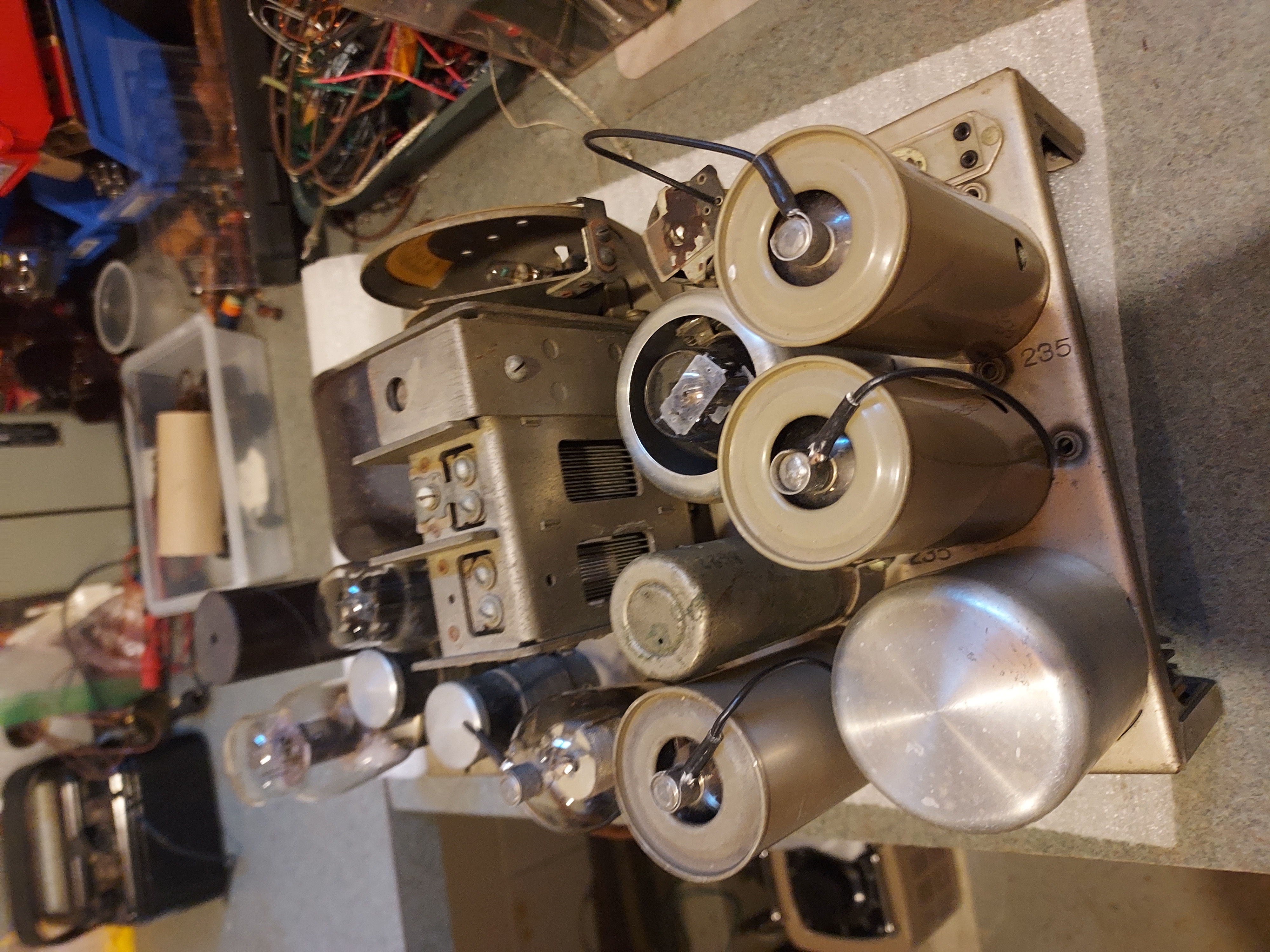

This is the AK82 I snatched at the last Kutztown show from an old guy, within 3 minutes of me having arrrived there.

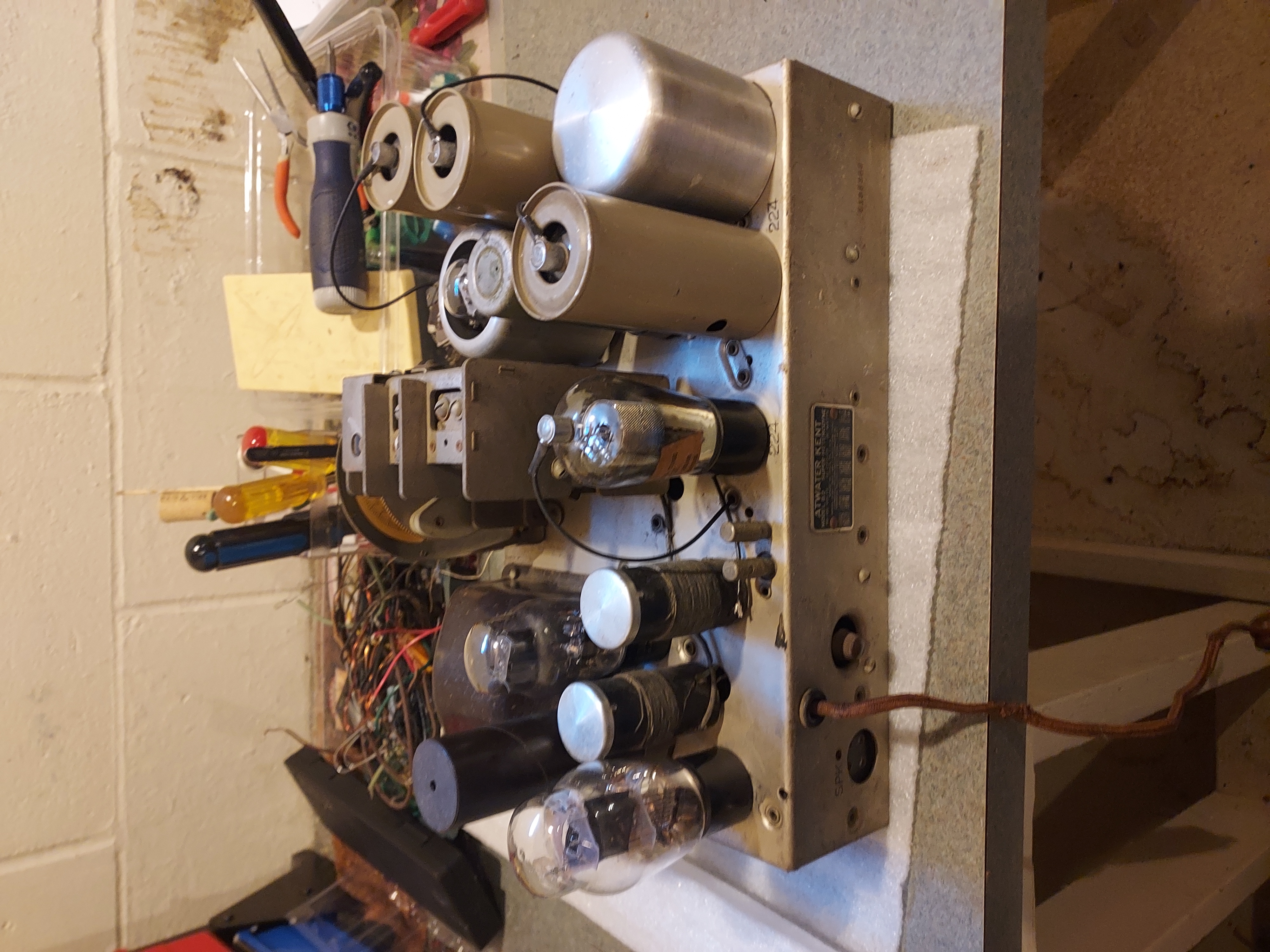

I removed the chassis and snapped some pictures.
As you could see, the radio has been tended to, as the previous owner said; he also claimed it worked. I believe him, but it is not in my habits to turn on radios without having it checked out myself.
The radio was repaired with Philco-Ford capacitors. The original (or what is there pretending to be the origianls) are disconencted.
I also checked the tubed. All are working, but one 35 tube is weak and the other cannot be determined to be eiyther 24A or 35 (they look the same and test pretty much the same). Luckily I have two working good 35 tubes.
The rest will be coming later.

I got curious and looked up the print on Nostalgia Air. Looks like the 82 uses two 35s and one 24. So that is probably your mystery tube.
Jayce
The tube numbers are stamped on the chassis, so there is no mistery. What I mean, without marking on the tube (glass or socket) and people sometimes subbing 24A for 35 I have to go by assuming it is a 35.
I of course could try to see the grid wire spacing, but not sure how well I could tell the difference.

The AK 82 is a beautiful set and you got a fantastic deal on that one! In fact, we should have done a civilian arrest for stealing, but you had your beer cooler that saved you
The AK's do have nice chassis, but I don't think they are stainless, it's some kind of plating. I had an AK 84 once that was a real rust bucket

A-K chassis is heavily nickle plated steel.
Sometimes the plating is porous and there will be rust. In other examples the plating can be polished to a high luster. I once did a chassis up restore of an A-K 55, because of a filter cap meltdown, wax everywhere. Came out really shiny, close rival to a Scott. The chassis was for an A-K Kiel table, so clearly a showpiece.
Chas
Pliny the younger
Chas
The book "AK 1929 catalog says"
"... All steel parts are either cadmium and nickel plated or they are enameled andbaked in immense automatic ovens."
The color looks more cadmium to me (it has a yellowish hue and is not high gloss / reflective).
So, yes, probably not stainless steel. Cadmium is, what they call, a "sacrificial coating" which will oxydized before the steel. Maybe this is why all the chassis' I've seen in AK are so spotless.
