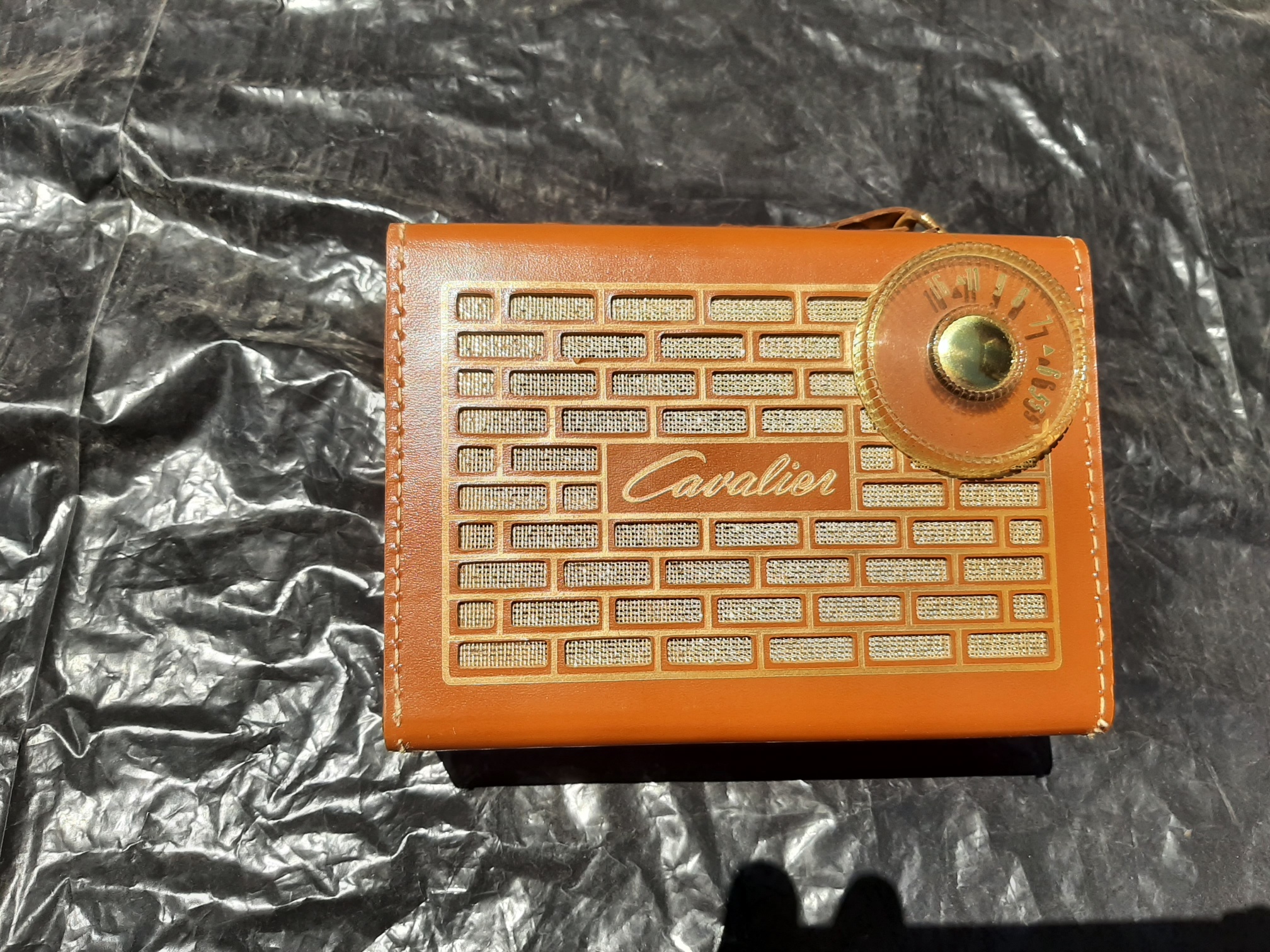

This was brought to my a the family reunion. Don't need to say more .
I've checked and can not find anything about this radio.

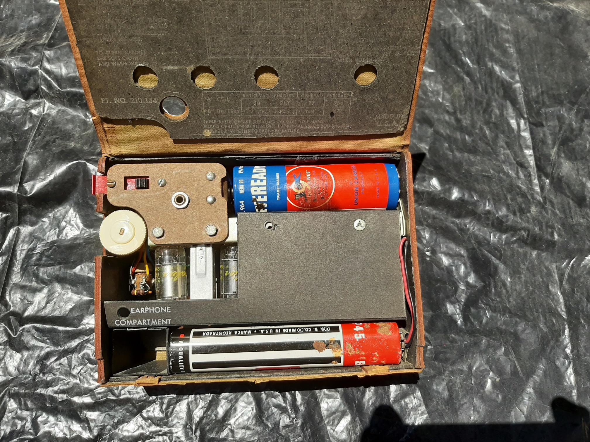

From the pictures it has a No. 964 1.5 volt "A" cell. Looks like a D type 1.5 volt Cell just streched 50%.
The other battery is a P 45 67.5 volt "B" cell.  About 3W X 5L X 1Thick. Luckily neither have leaked and no one has
torn into it yet.

First advice, REMOVE THOSE BATTERIES IMMEDIATELY !!! Save them and measure them for size dimensions. but get them out of the radio. The 67 1/2 volt battery already shows signs of leakage, as does the 1 1/2 V battery. That is the cause of the discoloration. Check the battery clips well too to make sure they are not corroded. If they are, clean them with a baking soda and water paste to neutralize the battery acids. Without being able to measure the battery compartments I cannot give you more advice. You could use a regular D cell with an extender piece for the A battery, and 7 9 volt transistor radio batteries in series for the B battery if they will fit.

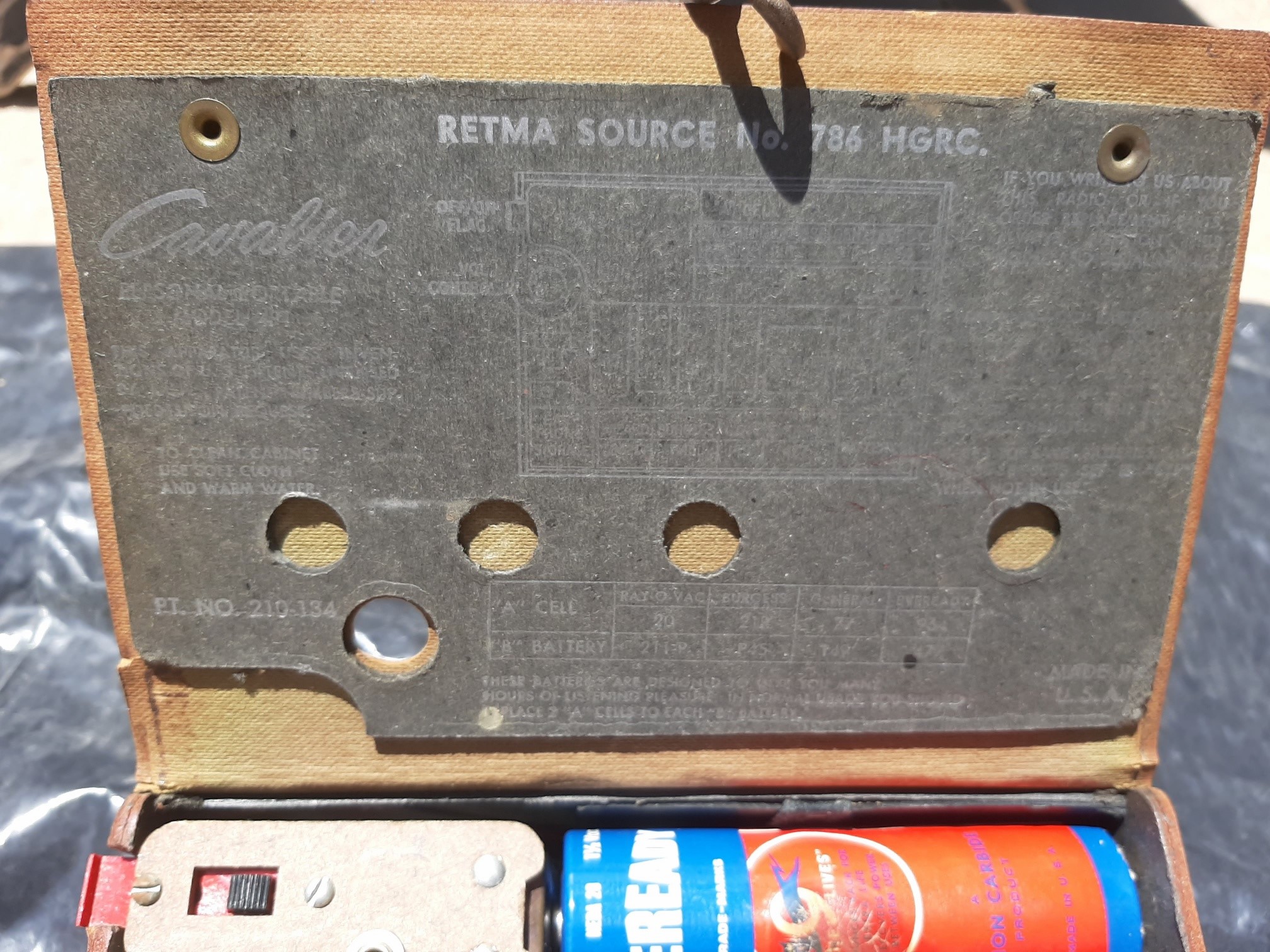

I used the retma source no 786 hgrc and found this at the other site.   https://antiqueradios.com/forums/viewtopic.php?t=300022      More info https://samswebsite.com/en/photofact/sea...d/CAVALIER Made by Hinners-Galanek Corp.
David, thanks for the information. Figures, the only thing I didn't search was the retma number. Has the SAMS as well.

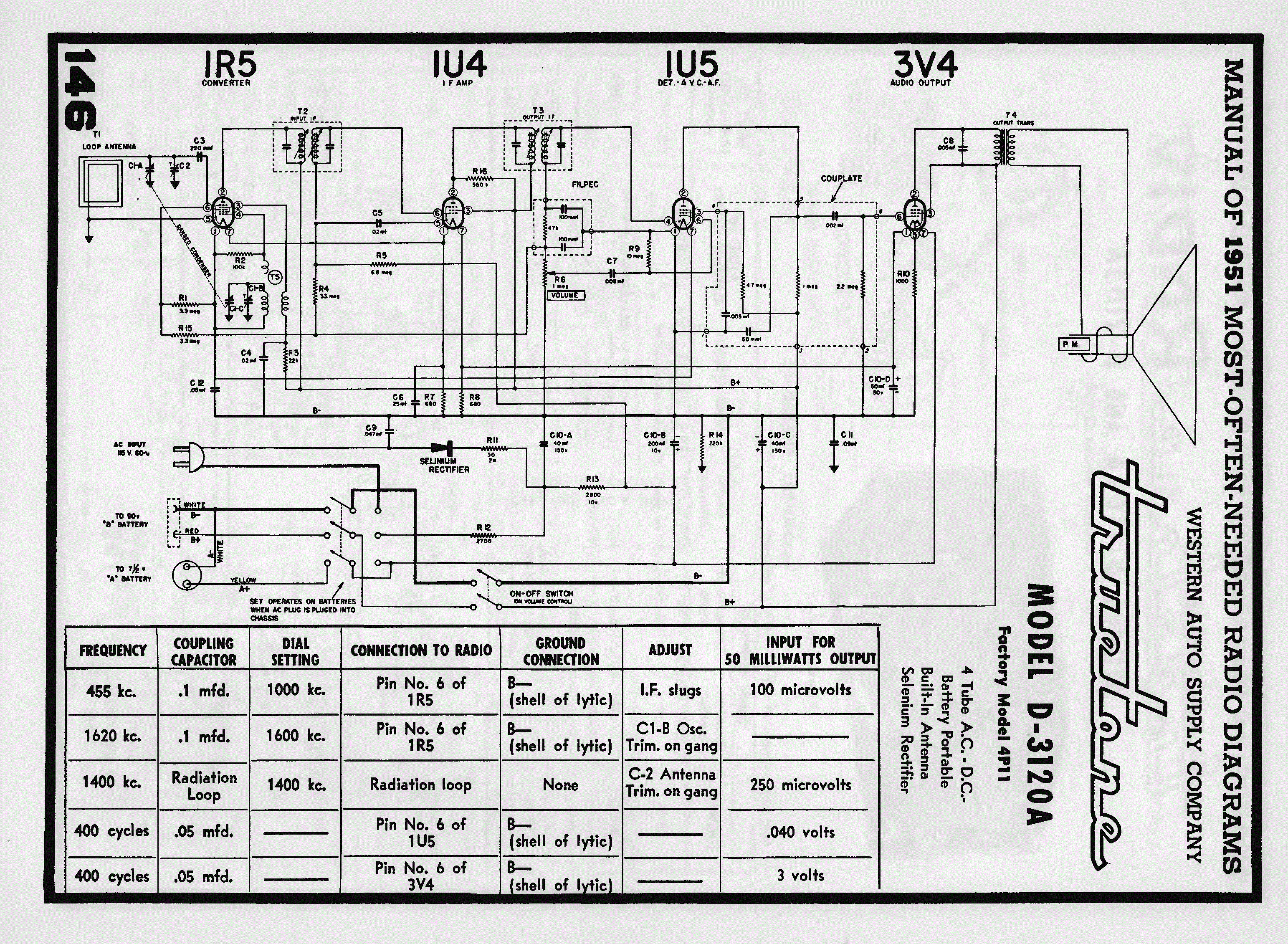

Found another site with info the set has truetone tubes a brand of Western Auto. So started looking at western auto sets at Beitmans from 1950-1955. Link to the site. https://www.doctsf.com/grandlivre/fiche.php?ref=68769   Plus some info from Beitmans good luck.
Another

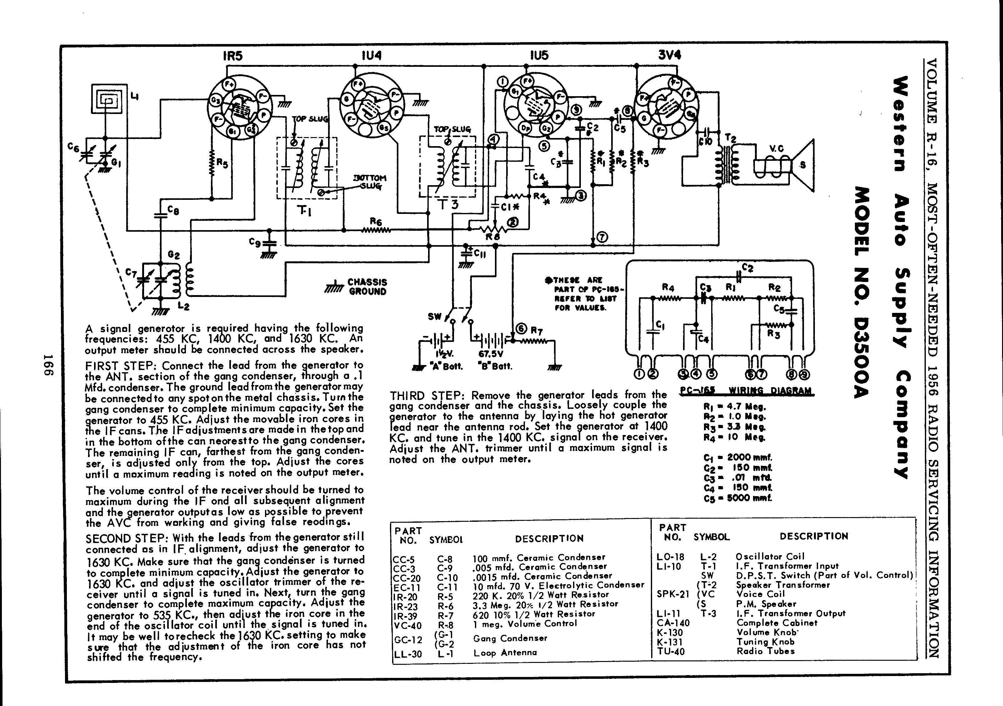

My computer died before completing this. Most of these radios are of a rather standard design. The schematics have only minor differences. Use the schematic for the Truetone D3500A if the tubes are the same. Most Truetones were made by Detrola. Don't use the other schematic pictured, as the Battery / AC - DC Radios usually have the filaments (heaters) in series, while the battery only sets have the filaments in parallel. The schematics are a little small for my eyes but it seems that the D3120 Schematic has series filaments and a 7.5V A Battery

This looks like a 4 Tube Superhet. The circuit is fairly standard with a 1R5 Converter, 1U4 IF, 1S5 or 1U5 Detector /1st Audio and a 1S4 or 3V4 Audio Output Tube.

The A Battery of your radio is probably the diameter of a C cell but the length of a D Cell or slightly longer. You are correct in using a 1.5V C or D Cell with some sort of spacer arrangement and 7 (63V) or 8 972V) 9V Batteries.
In most cases, it is a good idea to change all capacitors, but in this radio, almost no heat is generated. In addition, the "caps" may be ceramic disks which are usually reliable. However, you will find a 10 uF electrolytic cap from B+ to chassis ground (C11 on the D3500 Schematic). This capacitor should be replaced or it may kill your 9V Batteries or heat up the bias resistor (R7 on the same schematic).
