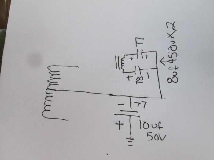

I do have an electrolytic question. The 1st photo shows the two electrolytics #77 and 78. I’m assuming the green box is a common negative and the green arrow is the positive connection for the 10 mfd portion of the duo electrolytic #77.

You have a couple of things going on. #78 should be single unit yours is a dual with the two section tied in parallel. I would remove it rebuild it using a new a 10uf 450v cap inside. 77 the 10uf 50v connects with the - to one of the insulated tabs and the + to the outside tab next to the cardboard insulator. The 8uf 450v + side connects to the other insulated tab and - connects to the outside tab next to the cardboard insulator. I would rebuild likewise and use a 10uf for the 8uf. The can that is under the chassis I would remove.

Thanks Terry but I’m not sure if we’re looking at the same schematic. I’m using the one listed as Service Bulletin No. 220 because I was told it contained the Canadian schematic for my radio, Model 3650. I tried to copy and paste the schematic itself but it didn’t work.
On my 1st photo #78 is the top left electrolytic and it is a 8 mfd single unit. It was the one just below it that is #77 which is the dual unit. I think the + connection of the 10 mfd portion of that dual unit goes to that ground lug where the green arrow points. I was hoping to get a confirmation from someone like yourself with much more experience then I have.

I just assumed since I only saw a red wire and a grey wire coming from the #78 cap that they were the + and - wires. There is nothing on the outside of the canister so how does one determine that this is a duo cap?
Sorry to imply you were incorrect. You’re dealing with a novice here!
