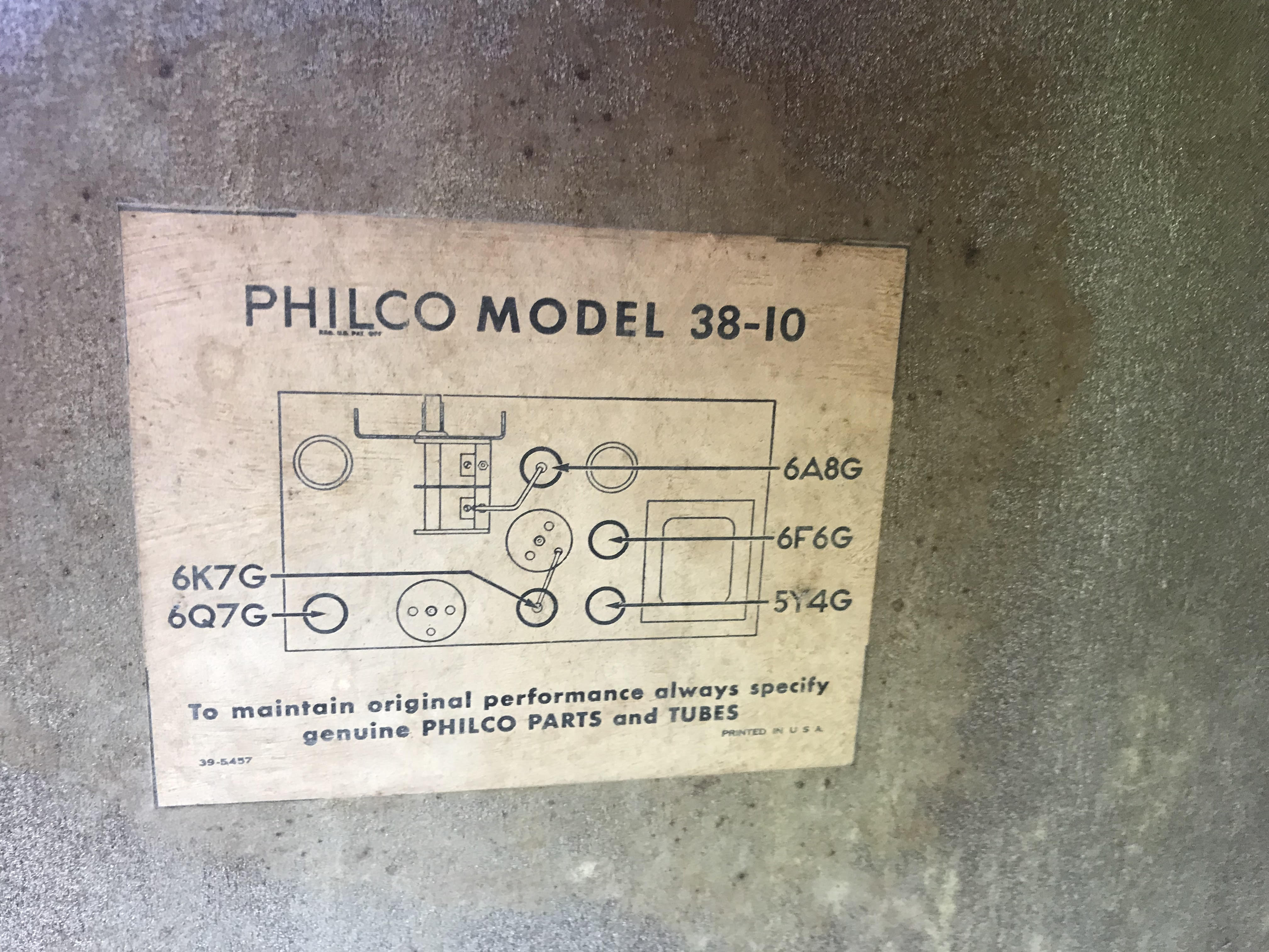

This was in the basement of a property my husband and I purchased and cleaned out.  I would like more information about this Philco 38-10 radio.  I'm not sure if it's a reproduction or not.  The radio appears authentic, but I can't find the exact cabinet in the gallery and the backing on it is a thin piece of Avery cardboard.  We hear static as we turn the dial (new outlet plug was put on cord at some point).  I would appreciate your assessment.  Thanks!
Yes your radio is an original. Looks like it is a Philco model 38-10XF, a 1938 model. See the link to a drawing (we don't have a good photo of this model in our gallery): https://philcoradio.com/gallery2/1938c/#Model_38-10XF
The grill cloth on your radio is not original. It would have had the chevron cloth seen in the gallery. Do not power you set on until you have the radio serviced. All of the capacitors need to be replaced at a minimum. Your tuning dial escutcheon is also missing the outer ring. The cardboard backing is also not original. Most Philco sets did not usually have a back to them.

The chassis in your set is a 38-10 and the cabinet is the XF. That's what makes it a 38-10XF.
