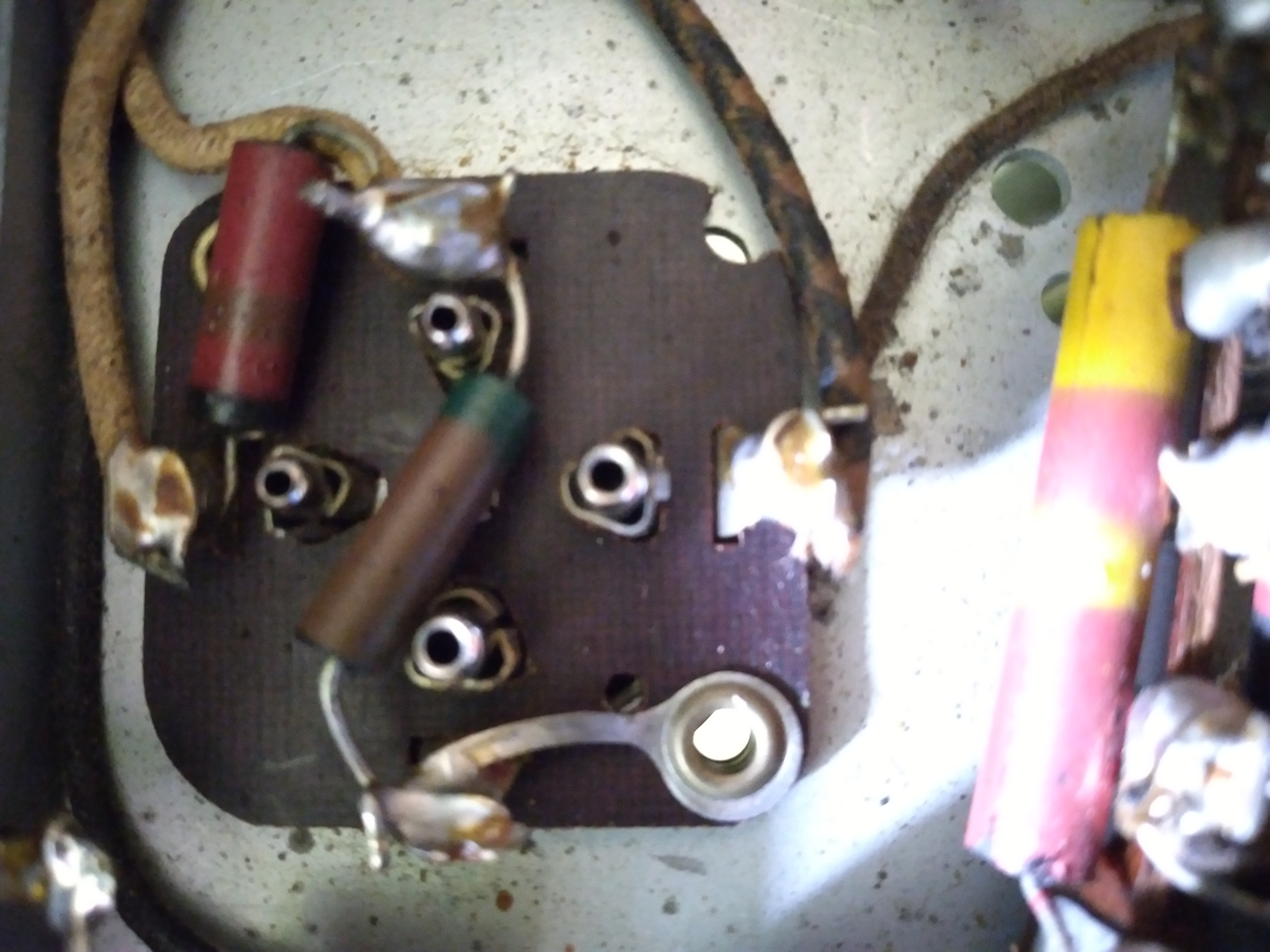

My wife surprised me with aurora design vbx1 vibrator.I want to hard wire to bottom of old vibrator pins but not sure which wires to hard wire it to.I see 2 black and two whitewires coming from transformer.Not exactly sure which wire is what.

attach the contacts labeled TA and TB on the board to the 2 smaller pins of the vibrator base. then connect the contact labeled GND on the board to the big "upper right" pin in my earlier diagram. the one connected to the + side of the battery [= GND]. if you look under the radio, you'll see that the 2 smaller pin sockets are wired to the transformer and the big "upper right" socket is connected to ground. the big upper left socket is connected to 6 volts negative. the aurora vibrator doesn't use it.

So upper right as in pin one?Pin four is also transformer but not used?Sorry I am trying to learn this stuff.

the pin at 12:00 in your picture is the grounded pin. notice the metal strap connected to a rivet. 3:00 and 6:00 are the ones you connect to contacts TA and TB. the 2 tan wires in the picture connect those pins to the transformer. the pin at 9:00 is 6 volts negative, which is not needed for the aurora design vibrator. on the schematic, the 9:00 pin connects to a coil [no.57], a 0.5uf cap [no.58] and the heater of the rectifier tube [the 84] but not to a transformer.
i like to solder the aurora circuit board to a 4-pin vibrator base [with short wires]. that way, you can plug it in or remove it from the radio easily.
