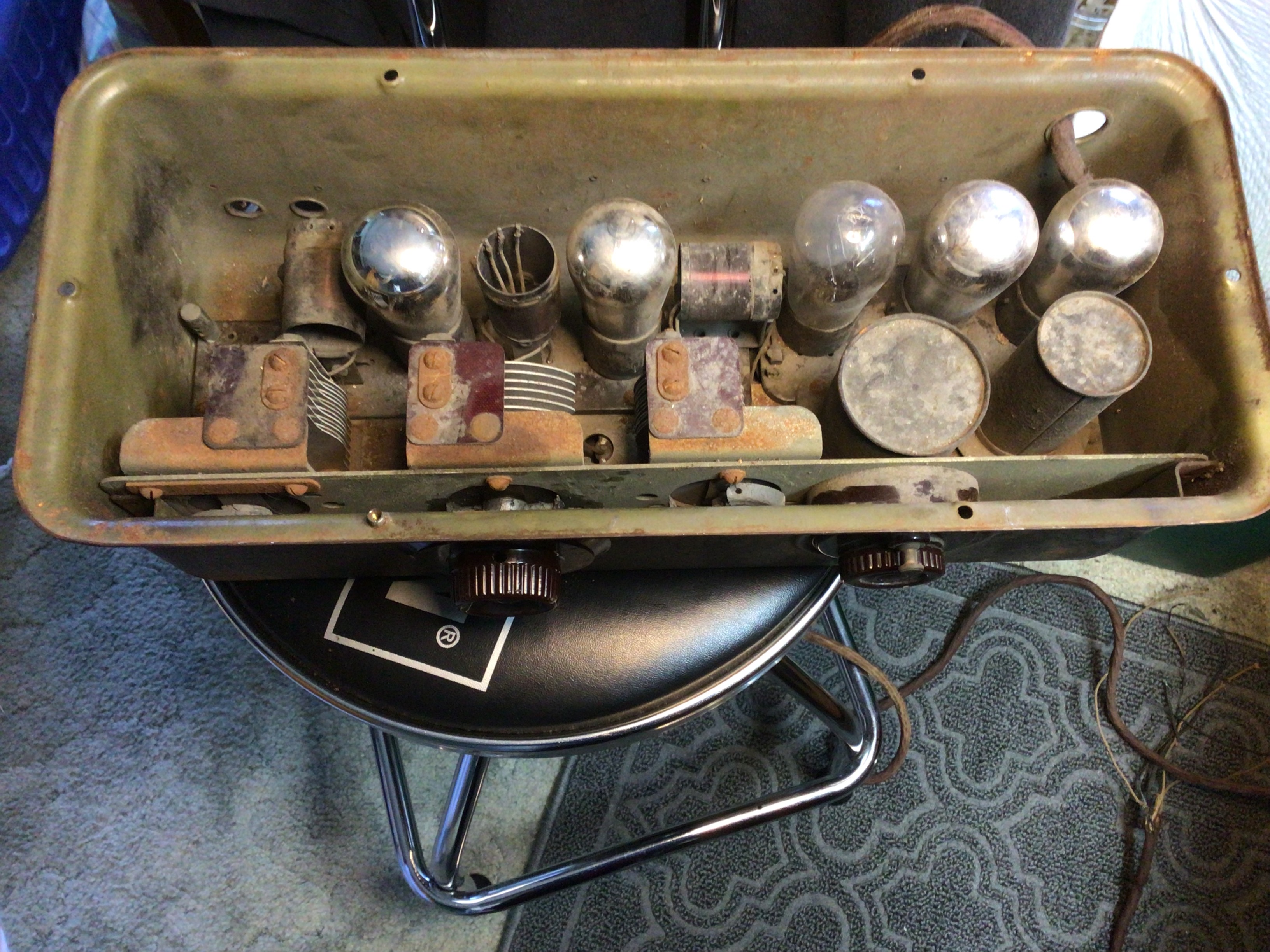

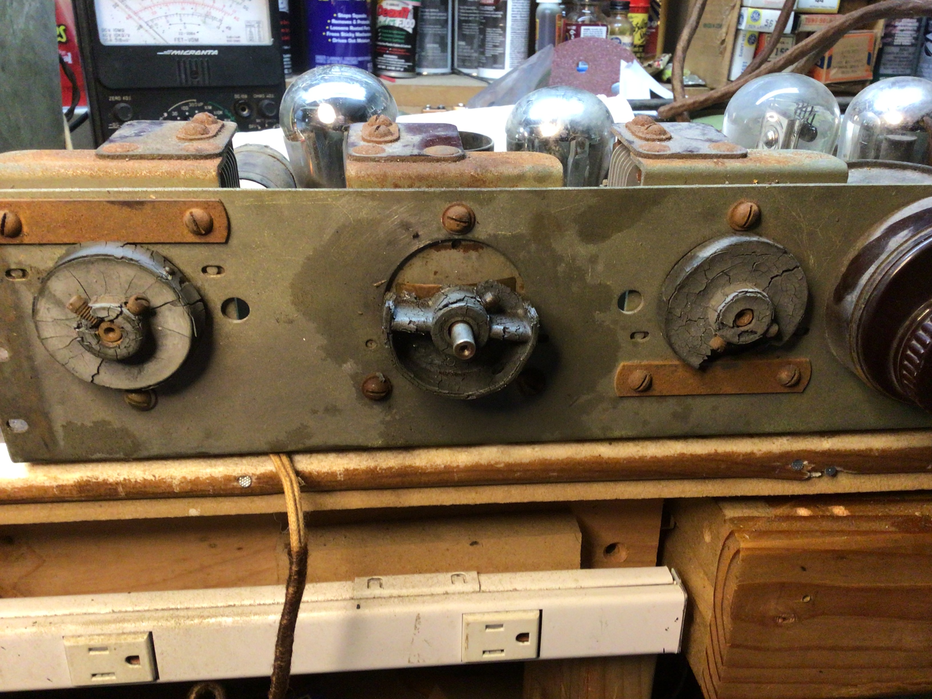

Well after discussing grid leak and power detectors on my Majestic 50 thread and experimenting with changing to a diode detector, I’ve decided to dig out my only other radio I have to be a candidate. It’s a TRF set with a grid leak detector. The purpose being to see if the inherent problem of distortion from a grid leak detector can be improved upon. It should have easy access to the circuitry that I need to work on. First I need to restore/repair the set to working condition. Right out of the gate, one big problem is the three tuning caps have what appears to be pot metal pulleys that are totally crumbling away and metal bands that run between them that are broken. So the research begins!

Atwater Kent started using brass pulleys in later models. I have a model 37 and a 38 that use brass pulleys.
You might be able to salvage a set of pulleys from a model 37 set. It has a very similar arrangement, if not identical to the 35.

You can still experiment, just think of it as a fancy Model 20 3 dial set. Fortunately brass pulley and bands from later sets will work. Unfortunately they go for big bux.
These things are real simple. Similar to earlier AK sets, however, I think that the Radiola 16 competitor to this set is a better set. The things you need to check:
The pulleys and bands for the caps (Oops, you checked that already). I don't think that there is an AK35 with good ones on them. Funny, my 40 is fine. I dunno if they are pot metal or brass. I have 2 AK 35s, a Crosley 601 Bandbox and my dad's Lionels (Standard gauge NY Central, ca 1922), all with bad pot metal. I found wheels for the loco (the rest of the train set bodies are tin), but the bases for the gates and signals are all pot metal and crumbled. Funny, the streetlights are all good. Pot metal is hit or miss re quality. Attics and barn lofts are murder on it. There was an article on the internet from a guy that restored a Crosley bandbox, rebuilding all the caps, making pulleys and even carving the block for the tuning knob pinion and shaft.
The audio transformers tend to open. Ohm them.
The Grid Leak is likely bad. Just tap in a 2 Megohm resistor
The 2 caps for the RF Amps have 1K wirewound resistors that tend to open. These were meant as suppressors for oscillation instead of paying for the Hazeltine Neutrodyne patent.
I haven't found open RF coils on these sets, but it is worthwhile to clean and check them.
This is a rather flexible set as the C- for the Audio Output is separate from the C- for the 1st Audio amp. This is so the user had a choice of using an 01A, 112 or 71 for the output.
You likely know all of this. I expound incessantly in the interest of anyone else working on their first AK or similar radio.

Egad! As all ready stated brass pulleys are the way to go. As far as I know they are interchangeable w/the pot metal ones. The issue maybe finding the brass bands to connect the 3 caps together in synchronization.
I have a 1925 Crosley set that the caps, pulleys, and gears were shot. Badly warped (pot metal ). Did a restomod job by using AK caps and pulleys. Was a tight fit but was able to get them in. Now the belts were the problem. The AK ones were too big and only had one. So I had to make them out of a three liter soda bottle cut into thin strips and perforated at the end. Worked great.

Thanks Terry. I watched a YT video where a guy made new metal bands by cutting a section of a tape measure lengthwise to get the right width. If I do find the pulleys, I might try and experiment with some kind of elastic bands/belts as replacements but that’s a ways off yet.

Just PM'd you with a few possible sources for AK tuning capacitor / brass pullys. Also a Model 37 chassis, which has the same pully and belt set-up as the Model 35 - but it's an AC-powered model vs. the DC Battery Model 35 version.

Hi MrFixr, well I ohmed out all the coils and audio interstage transformers and it looks like it’s a go. Mbhdesigns put me onto a model 37 on eBay which is very close to my 35. It’s the whole chassis minus tubes and cabinet and has my much needed brass pulleys and bands and as an added bonus the interstage transformers and coils if ever needed. Should have it by Thursday. I do have a power supply unit kicking around from a computer I scrapped long ago. I will look into seeing what voltages it puts out. I think there are 90, 67.5 and 22.5volt requirements to run this radio. More decisions to make. Thanks for the input!

I'll mention in passing that if you are into the aesthetics when you have it apart you can flip the two end tuning caps around. Then the top will be on the bottom. Most of the time it's not as rusty.
