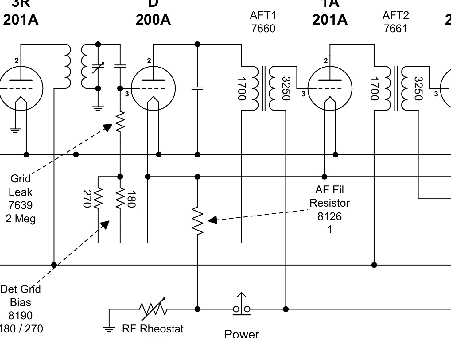

Hi Ron,
Totally love W3LNB's redraw. They are much clearer than A-Ks drawings.
One possible source of the distortion is that you are using a UX200 or 200A as an amplifier. They make horrid amplifiers, as the tube has gas. It is meant solely for use as a grid leak detector. Its claim to fame is that it is more sensitive as a detector than a 201A. However, 201s and 112s can be subbed as a detector without mod.
Per the RCA Receiving tube Manual RC13 (1937?), both the diode and grid leak triode detectors load down the previous RF Amp, thereby changing its sensitivity. I dunno if there is a difference on loading with the diode vs grid leak circuits and if that difference changes the resonant frequency of the tubed circuit. That has to be taken into consideration. Otherwise, the circuit looks great. Guess maybe it is better to try this on a 3 dial radio. Maybe restore the wiring and finish restoring your 35 (U r almost there) and wire up the 37 chassis as your test bead, using a 201 in the detector, biased as an amp, using 67V on the plate as well as using 67V on the RF Amp plates.
One thing that drives my interest in this experiment is that there are articles on the internet extolling the crystal or diode detector as a high fidelity detector. There are experimenters that discuss the biased detector (not so easy to do in a battery radio) as a higher fideity detector because of its supposed infinite input impedance.

Hi John, I got to thinking that the reason the alignment went way off on the 3rd RF tank circuit could be that in the original factory version if you look both the tuning cap and the cold end of the transformer went to chassis ground, basically the two were in parallel. In my modification, tuning cap still had a chassis ground but now the transformer cold end only has an RF ground through that 100 pf cap, so now the tuning cap is in series with the 100 pf, throwing resonance out of whack. I redid my mod by putting back the ground to the cold end of the transformer thus restoring the original configuration. Then I ungrounded the cathode of the 1N34, and attached it to the 27K/390K divider. That brought the alignment much closer to where it was before. Still, the audio is weaker than the factory design and no real improvement in distortion. I did experiment with changing the original 25V supply to the 200A and found it actually sounded better by going lower, even works down to 9V. Next time I get to working on it I’m going to use your suggestion of swapping out the gas tube for a 01A. If that doesn’t cut it, I may just return it to factory design and call it a day! Thanks for your interest and suggestions.

Congrats on the progress so far. I read somewhere that the less voltage on a 200A the better. I read also that a 200 is more sensitive but less loud. That is strange, as the amplification factor for a 200 is higher than a 201. The spec for plate voltage on a 200is for 25V as a detector. For a 201 as a grid leak detector, the plate voltage should be 45V. Despite what might be put on the box, I can't find any specs for use of a '00 or 00A as an amp or for any other use than a grid leak detector.
You may also want to use a headphone coupled by an AA5 transformer, as a 201 puts out about 10mW of power. make sure that you are using the correct negative bias on the Output tube depending on the tube used and the B+ voltage used.
The first radios marketed by Westinghouse (Aeriola Sr.) and GE for commercial use, as well as the IP501 marketed to the US Navy used a single tube as a superregenerative grid leak detector. In the case of the Radiola II and III, the Westinghouse RC, the GE 1300 and 1400 pair (Radiola V) and others, there was a stage or 2of audio after the detector. What negated the need for RF stages was the regeneration. Regeneration was covered by the 1914 Armstrong patent.
There was very little use of diode detection till about 1933. An interesting departure is the Philco Model 3 auto radio, which used a 71A (of all things) as a detector, with the plate tied to the cathode as one element and the grid as the other, making it a diode. I wonder if no one used diodes until the Fleming Valve patent ran out. The history of RCA is the history of lawsuits, as they were primarily a marketing and patent holding company until they actually started manugfacturing radios.

Interesting history John on these old sets and RCA, history I don’t know nor have ever read. I guess I really should bone up on this and the peculiarities about these early tubes that Chas mentioned as it is interesting and is relevant to my AK. Anyway, I don’t have any headphones but I am using an output transformer and speaker from an AA5. I also have an old output transformer lying around that I’m not sure what it came from as I think it was part of the stuff my dad had when he did radio/tv repair in the late 50s early 60s. I tried it and it seemed to be a tad louder so this leads me to wonder how much the distortion has to do with a mismatch of impedance here! As a last ditch effort, I did swap the 200A for a 01A but I didn’t notice much difference in distortion. Maybe this experiment might be better done on a superhet set with more amplification and known performance. I’m leaning towards reverting back to original factory design where I was getting a few more stations and let it be!

Also, I forgot to mention, I don’t have any spare tubes for this set so when I swapped out the 200A detector and put in a 01A, I had to use that 200A in the socket that I stole the 01A from. I’ve already undid my mod and returned this set to factory original but one last thing I will try is to put the 45V to the detector that you mentioned when I have the 01A in there! I will see if that changes the volume or distortion.
