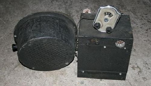

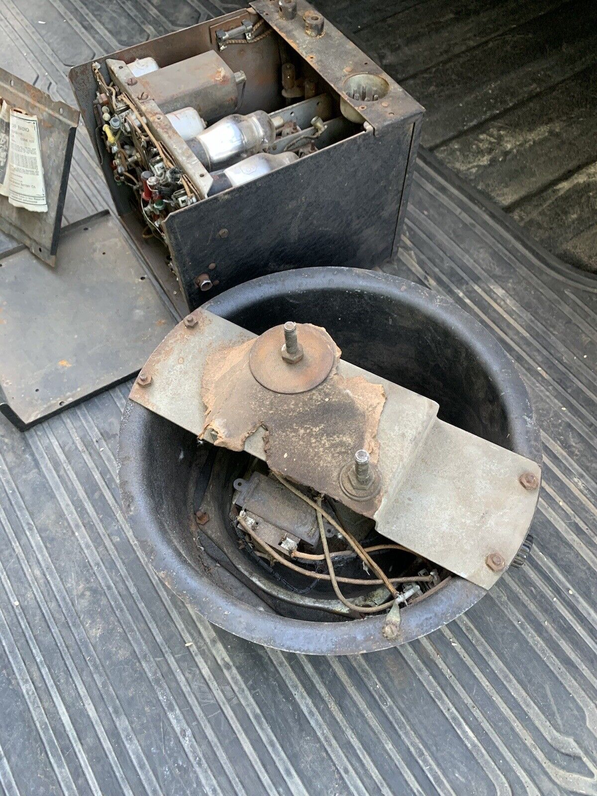

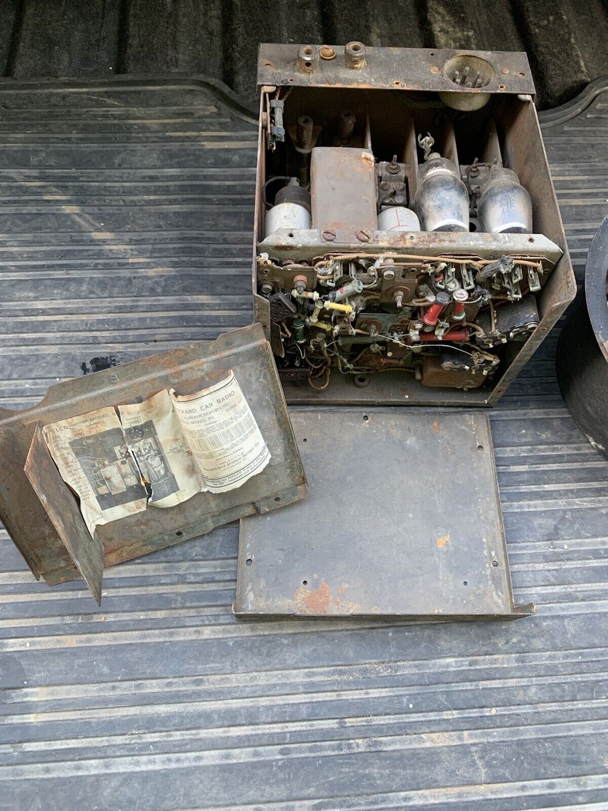

Hi
I have this old radio with a PACKARD tag but it says on the original torn paperwork it is a Transitone model 8 F ?
From what I have found out on the net this set ran from a Dynamotor, model EA. I found a circuit on Nostalgic Air.
I would like to find out what the Dynamotor looks like , and the dimensions of the Dyanamotor  box , if possible.
I think I need the remote head as well.
Some of these sets may have been imported here with expensive cars , or sold by radio dealers.
Thanks from Mike

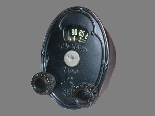

Here’s a link to a 1933 Packard Service Sheet that mentions the “new Packard radio” and shows a (grainy) photo of the control head. It’s on page 4 of this PDF.
https://packardinfo.com/xoops/html/downl...OL7NO2.pdf

Thank you Michael
That information is very useful. I had not seen those documents. Looks like they had at least two different control heads , one type is on the steering column, the other is in the dash panel.
I have the radio, now I need to buy a 33 Packard   Icon_lol I would need to win the lotto
Yes, it looks like two different control head installations that might be Packard car model specific.
You don’t own the ‘33 Packard? Darn. That’s ok, neither do I.

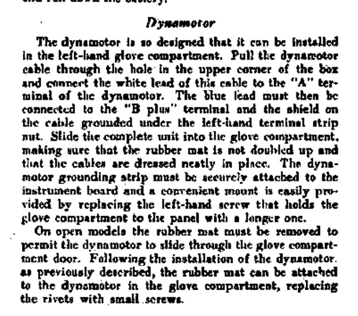

Getting back the PA Packard receiver, the document you found for that installation mentions that the Dynamotor is placed in the LH glove compartment of the car.

Yes it looks like the Packard car used either of two control units , one fits in the dash and another type on the steering column.
From what I read it’s the same case control unit with different face plates available from Packard to match different dashboard styles.
On car models without provision for a radio, the Philco faceplate (supplied) is used and the whole is attached to the steering column.
So I think there is only one control unit after all.

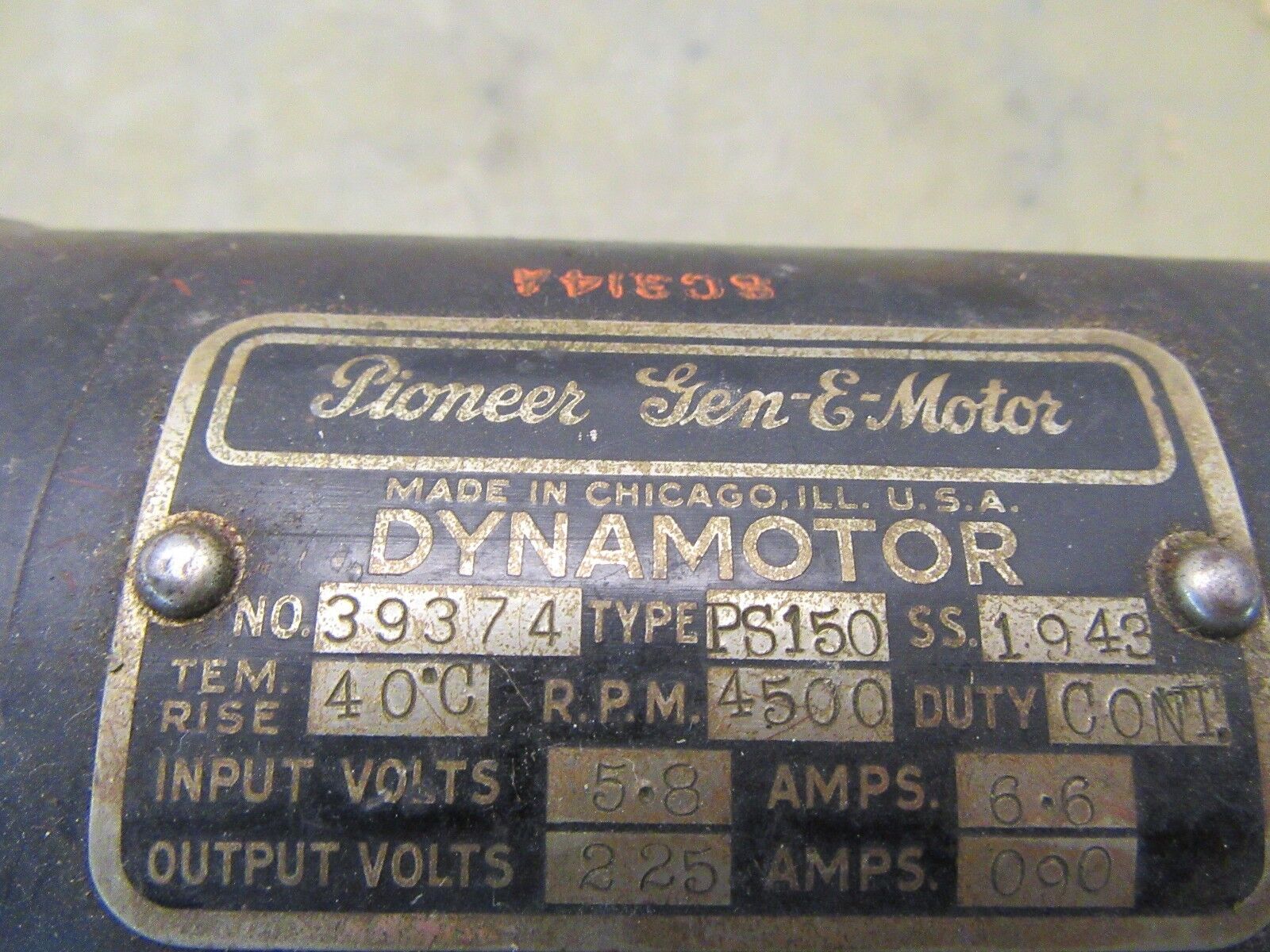

This type of military (?) dynamotor would be suitable.
I wonder did Philco manufacture their own Dynamotors or use a outside brand ?
Neat stuff for 1933. PP41s, this thing should put out 5W if they are fed from 250V. Dynamotors are cool.
The limited experience I have had with Dynamotors tells me they are noisy things, they whine like a sick cat. The military liked Dynamotors because they are generally reliable.
