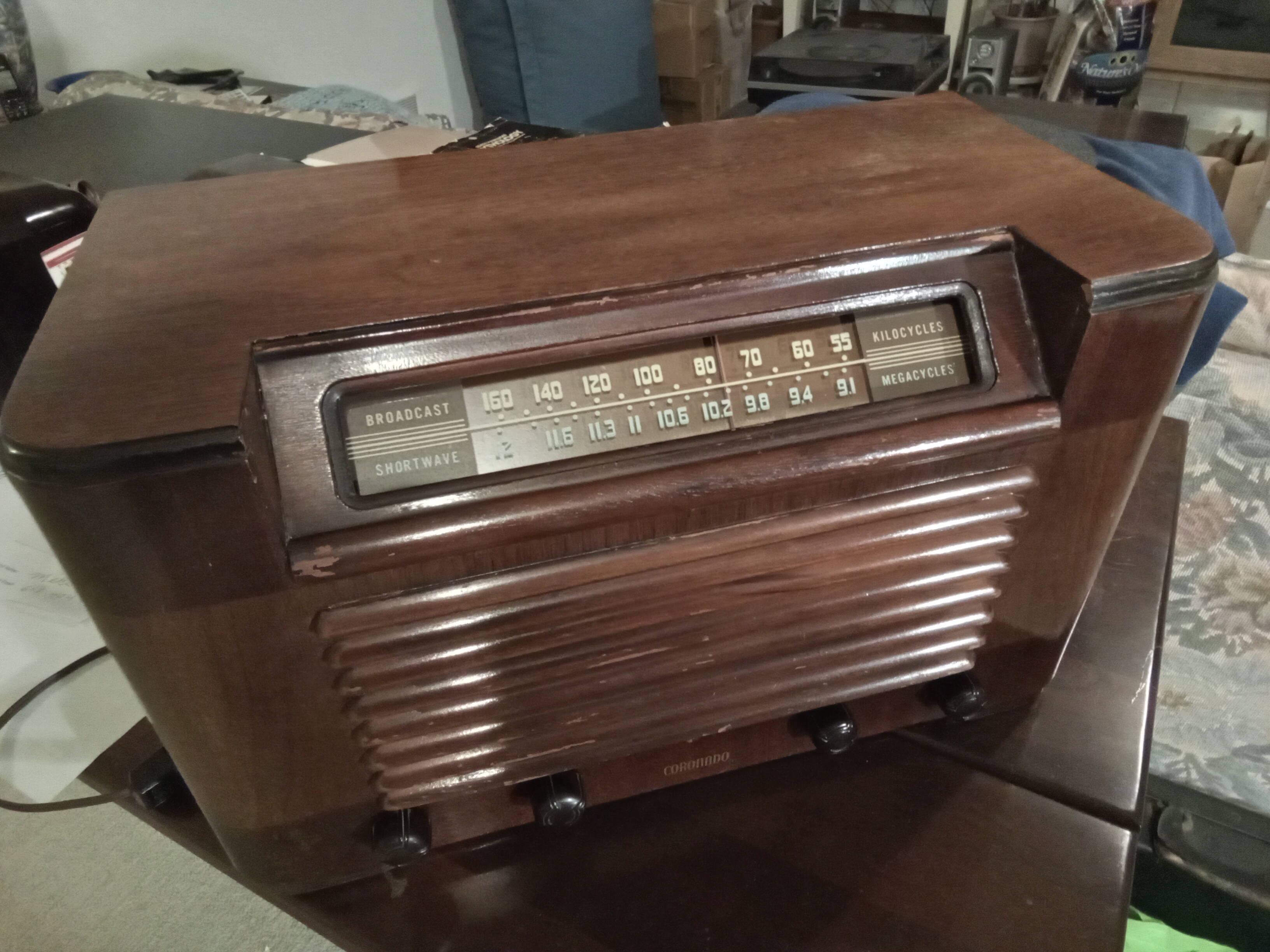

This past week I did a quick recap and repair of this 7 tube Coronado 1682. Also fixed the loose veneer on the top right rear corner and constructed a back with loop antenna from a scrap piece left over from a TV set. Has 2 bands and 3 tone settings. Nice SW spread from 9 to 12 MHz. Another one saved from the scrap pile. Owner and wife are very happy.
