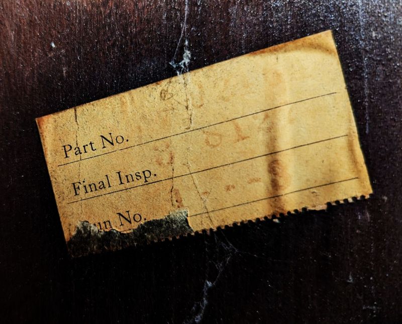

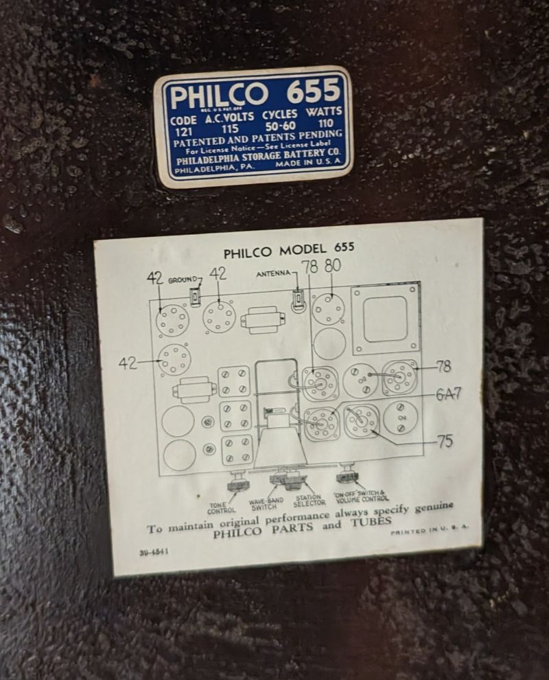

More: The part number of the "655" label is 39-4541. 1939???
No,
39-4541 is the Philco part number for that label. It has nothing to do with years.
From the mid-30s through 1942 and to some extent after WWII, Philco parts were sorted with two-digit prefixes. In this case, part numbers beginning with 39- were chassis or cabinet labels.
As to which model - Ah! You have yet another of the end-of-the-model-year Phactory Phranken-Philcos, where the Philco factory stuck leftover chassis into cabinets of a different model to clear out inventory in preparation for the coming of the then-new 1937 model line.
Count the number of tubes in your radio. If it has eight tubes, it is a model 655. If it has seven (with two 42 tubes instead of three), it is a 645.

No. That's the part number of the label itself. The 655 was a revised chassis. It's very possible they ran out of 645 chassis but still had cabinets. Just my guess ... others may have more details. The 645 was a 7 tube chassis, and the 655 chassis was 8 tubes. Quick count will verify what model you have. Take care and BE HEALTHY! Gary

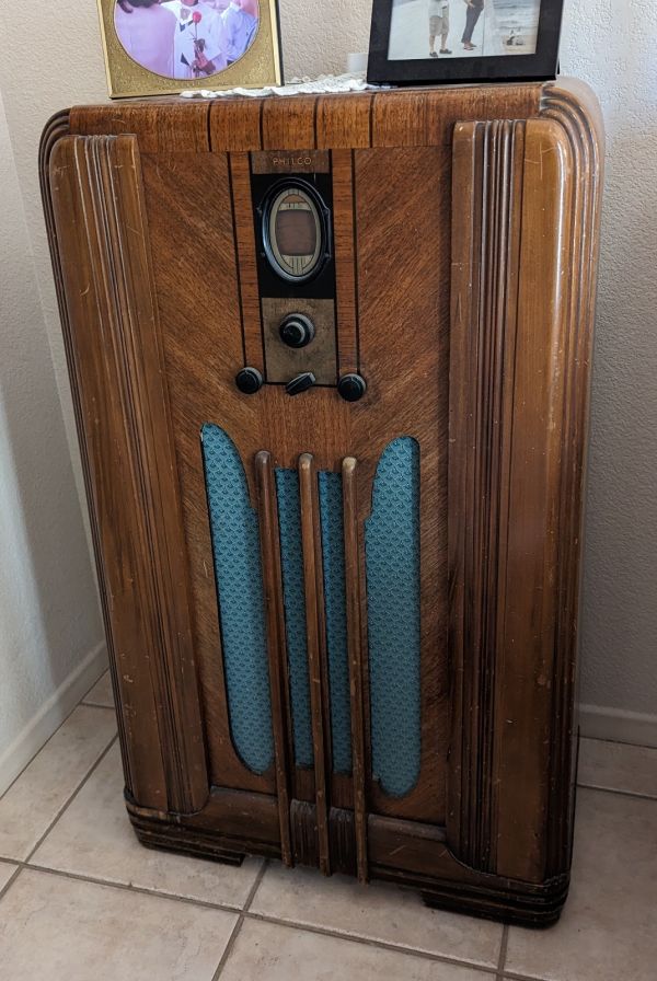

A Phranken Philco!
Um, so it's special and super collectible you say?

I would classify it as being unique, but.....
and I think others here will bear me out....
not any more collectible or worth anything more than any other 1936-37 seven or 8 tube Philco console.

I agree with Greg.
Edit: A Phactory Phranken-Philco is not more valuable than a regular Philco factory issue.
