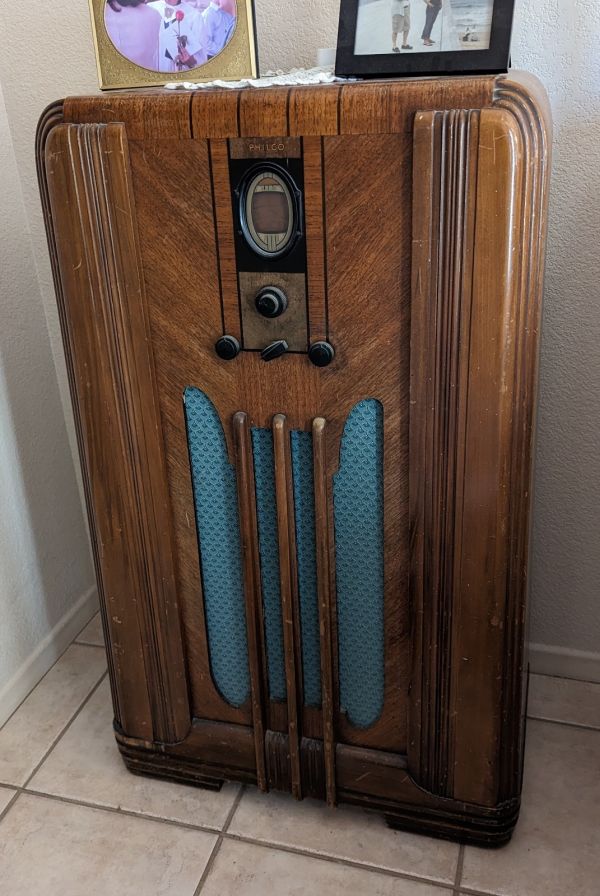

More: The part number of the "655" label is 39-4541. 1939???
No,
39-4541 is the Philco part number for that label. It has nothing to do with years.
From the mid-30s through 1942 and to some extent after WWII, Philco parts were sorted with two-digit prefixes. In this case, part numbers beginning with 39- were chassis or cabinet labels.
As to which model - Ah! You have yet another of the end-of-the-model-year Phactory Phranken-Philcos, where the Philco factory stuck leftover chassis into cabinets of a different model to clear out inventory in preparation for the coming of the then-new 1937 model line.
Count the number of tubes in your radio. If it has eight tubes, it is a model 655. If it has seven (with two 42 tubes instead of three), it is a 645.

No. That's the part number of the label itself. The 655 was a revised chassis. It's very possible they ran out of 645 chassis but still had cabinets. Just my guess ... others may have more details. The 645 was a 7 tube chassis, and the 655 chassis was 8 tubes. Quick count will verify what model you have. Take care and BE HEALTHY! Gary

A Phranken Philco!
Um, so it's special and super collectible you say?
Posts: 1,531
Threads: 242
Joined: Sep 2012
City: West Bend, Wisconsin
I would classify it as being unique, but.....
and I think others here will bear me out....
not any more collectible or worth anything more than any other 1936-37 seven or 8 tube Philco console.
Greg V.
West Bend, WI
Member WARCI.org
I agree with Greg.
Edit: A Phactory Phranken-Philco is not more valuable than a regular Philco factory issue.

As a retired Ford engineer, I can tell you that few of those shenanigans would fly today. Too much tied up in certifications, plus just in time inventory control decreases chances of having excess stock to use
The radio (let's call it Phrank) does operate, but I don't know if Phrank operates well. Sitting in the middle of my stucco home, with no ground and just 10 feet of straight wire for an indoor antenna, I can get a couple AM stations with a lot of noise.
So I'll have to sort out the antenna situation before deciding if any parts are in need of renewal. And hoo-boy, is there a list of symptoms and possible fixes so I don't have to randomly change parts?

That is does sound like the radio is working sum and I have found sometimes a ground makes it better or worse .
I have one wards Airline tabletop which when connecting earth ground to it the stations do not come in as strong .

Hi PatMat,
IMHO, the best way to check out Phrank (Love the name) is to do the following:
-Remove and inspect the chassis. with an 65 year old radio, it is important that the electrolytic filter caps and all paper caps be replaced if this has not been done in the past 20 years (modern mylar or poly aps and good 'lytics were common 20 to 30 years ago. wax-paper caps will fail.
If the radio has a phono switch and input, use it to inject audio from a CD, MP3, etc., (Set the volume control on the radio and the device low and raise to best sound). This will verify if the Audio is good.
If the Audio is good, lengthen the antenna wire, find a pipe ground and turn off as many computers, CFLs, LEDs, TVs, etc. as possible to lower the noise level.
Operate a known good AM radio in the same area and compare performance. Note that more modern AM radios with ferrite antennas may pick up less noise.
