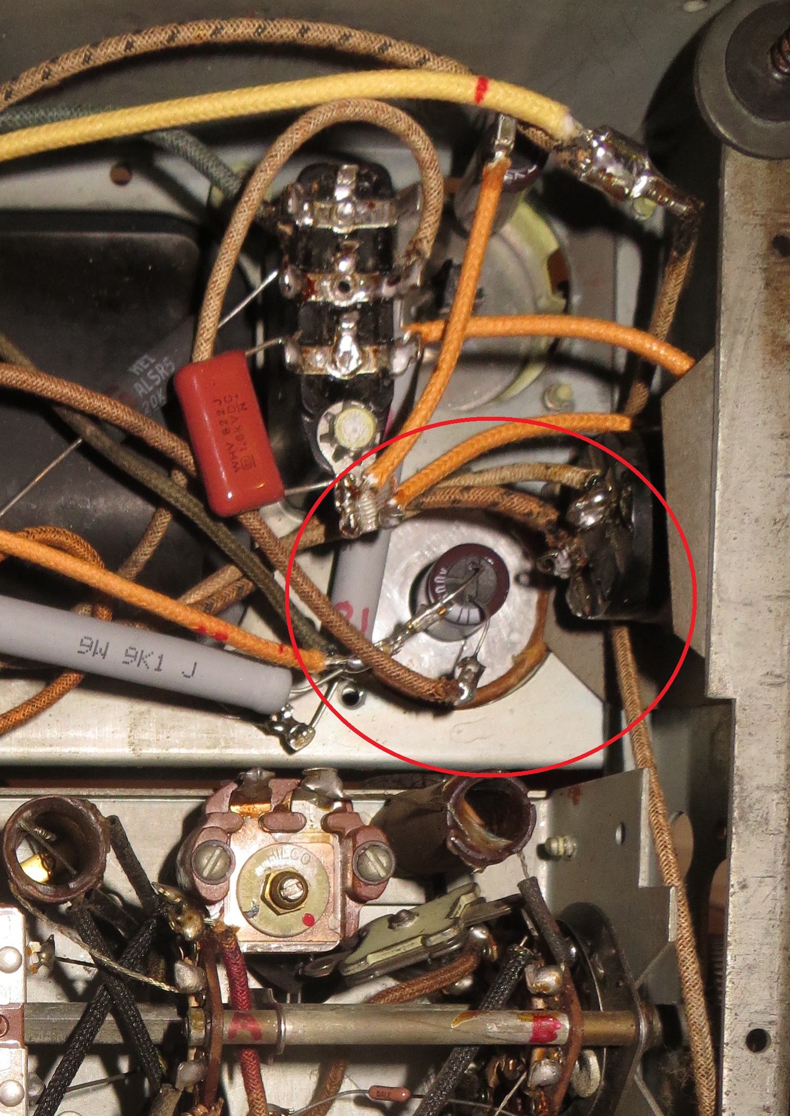

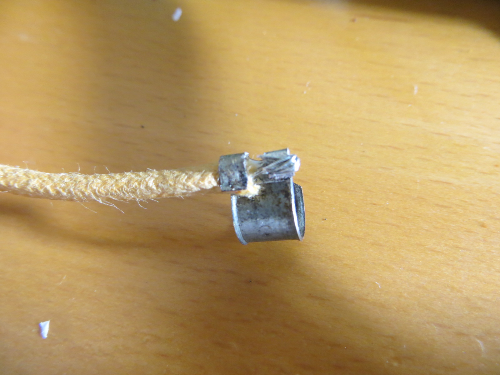

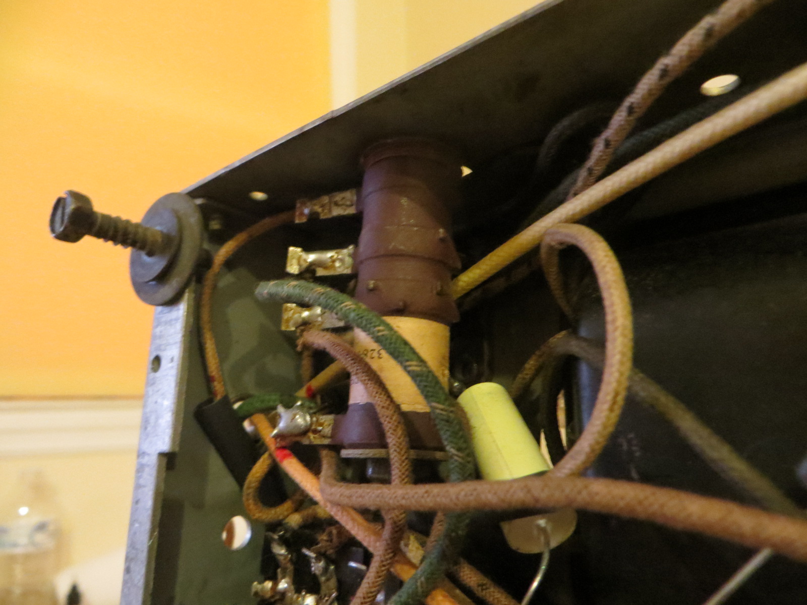

Did a little more today after some yard work.  Re-did 2 solder joints on the power switch. Also added a new wire to one of the tubes. Picture is before I soldered the end. Seems the sections of wire heated by the tubes dry out and crack up, very brittle.

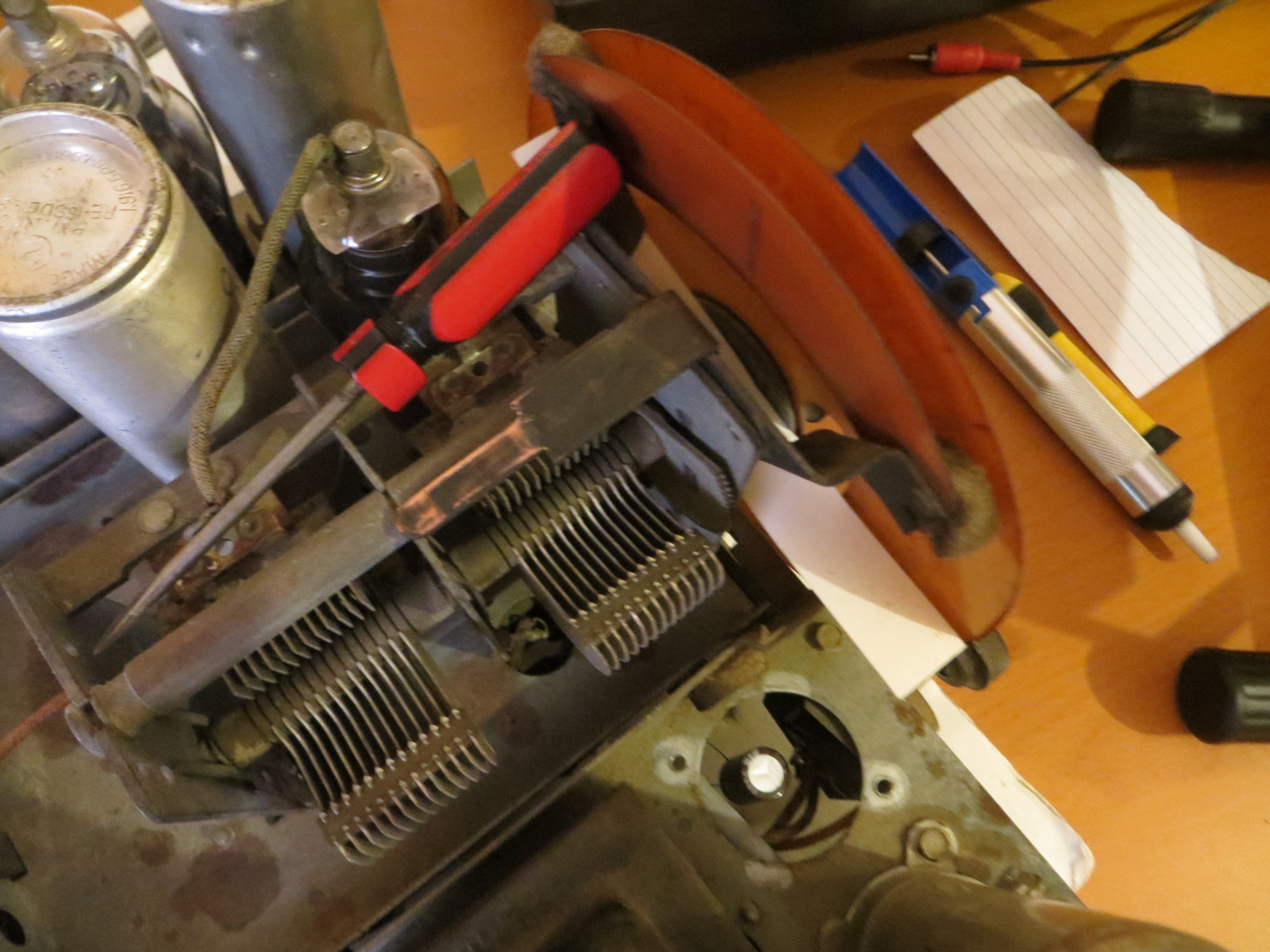

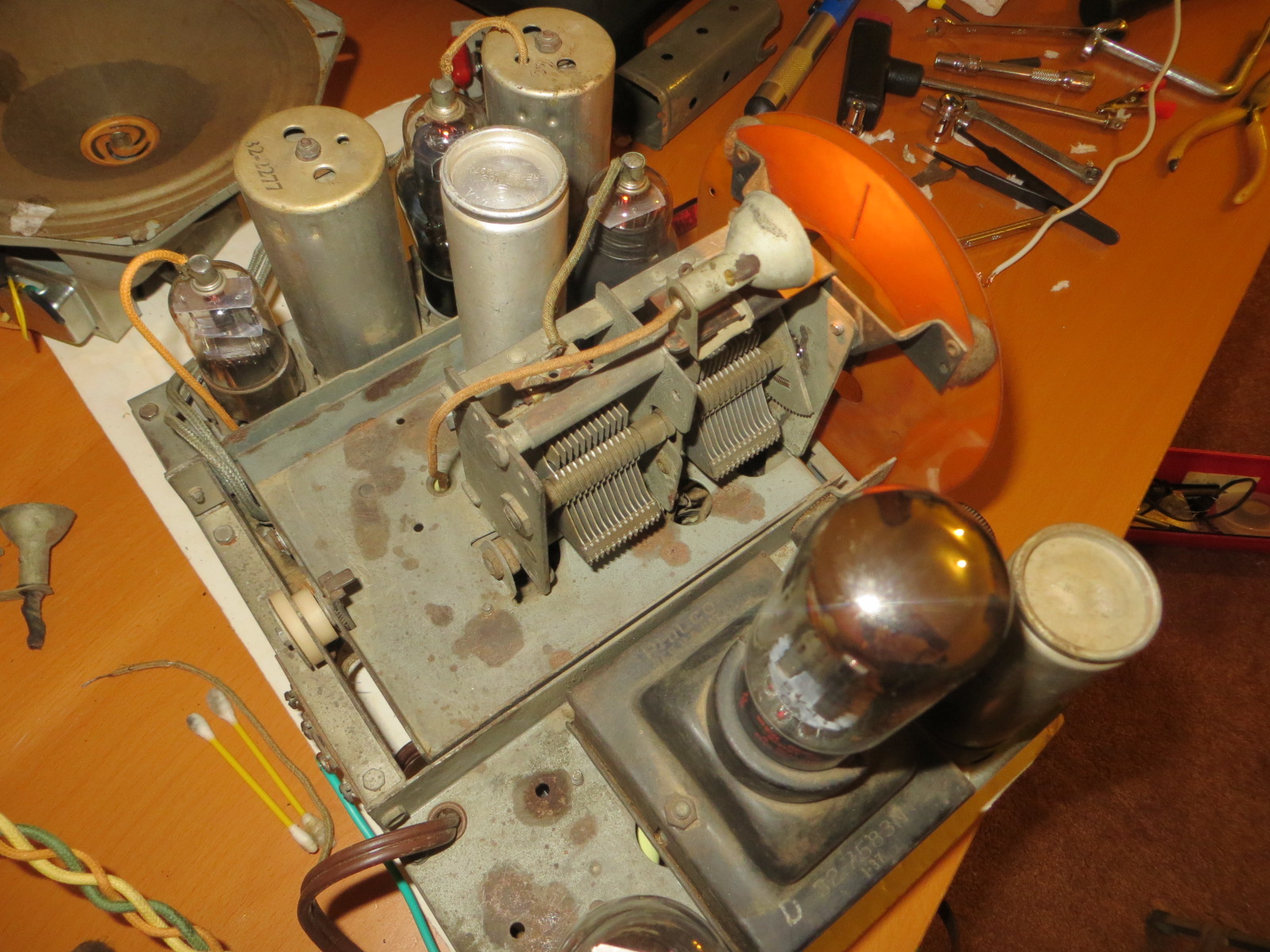

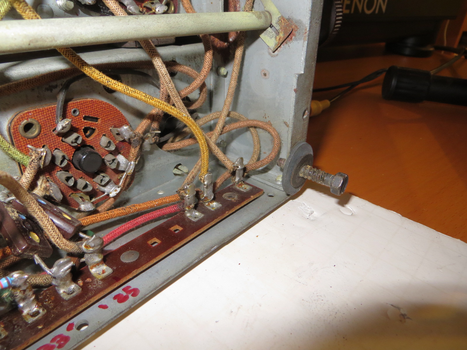

Tried the chassis mount bolts to see where the ends of the bolts went. Had to move some wires.

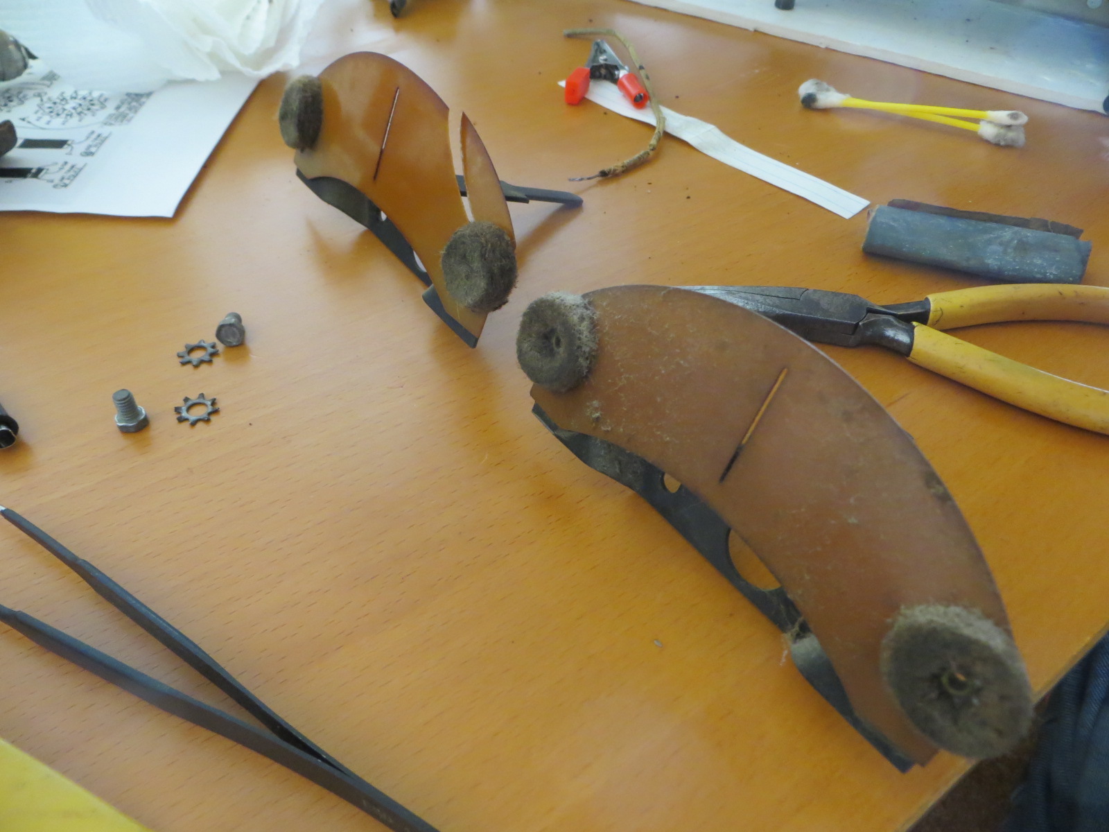

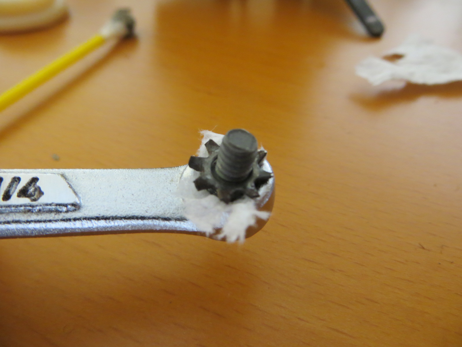

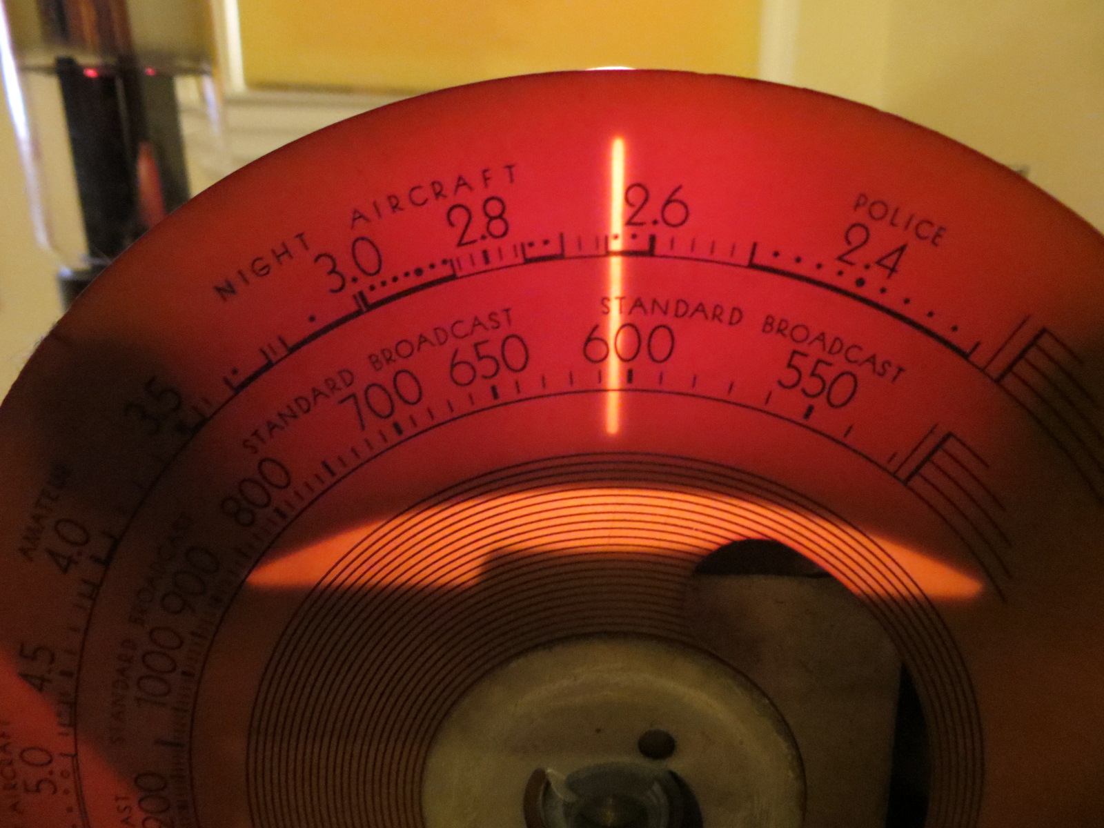

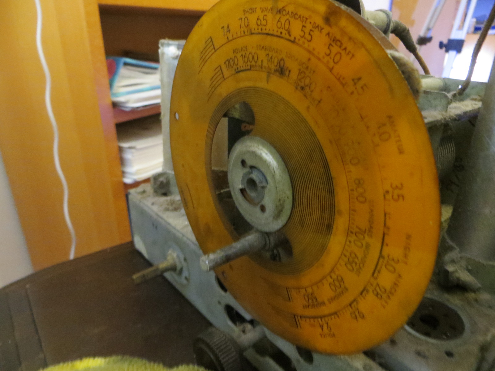

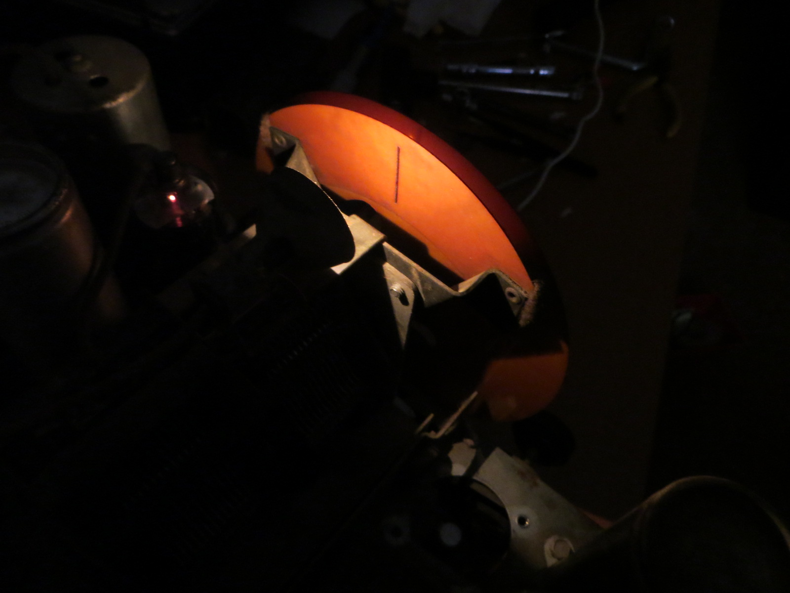

There's no words for the person that designed the back plate that projects the light slit on the dial. 2 hour off and on cursing spree and finally got the replacement on.  They could have made the groove that the dial lets the knob pass through about an 1/8" wider and a socket on screwdriver would have worked. Closed end wrench, had the bolt push through and fall out. Packed TP in it. Had to get my little finger up in there and hold it.  Icon_crazy Icon_evil

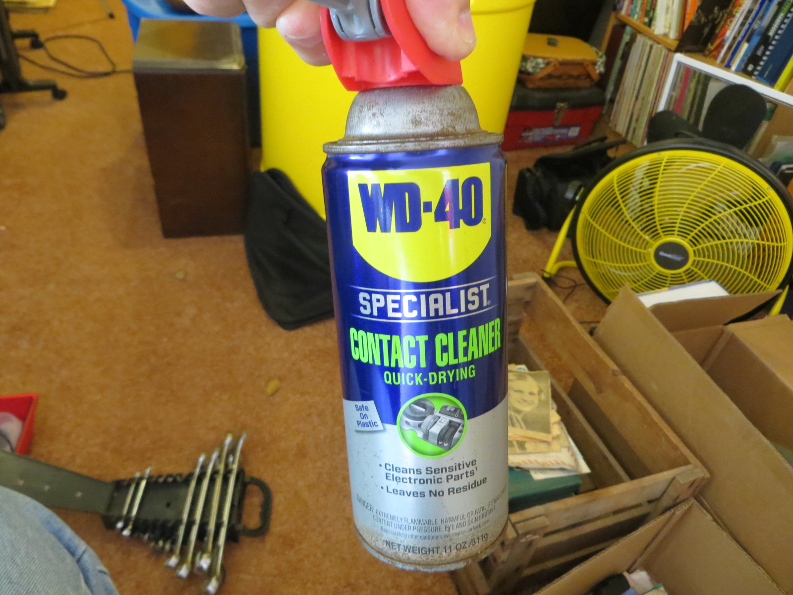

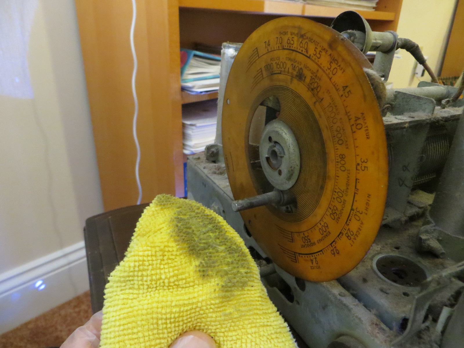

Was testing cleaning the dial on the radio I had bought for replacement parts. The "mineral spirits" I have leaves an oily residue. The dial was filthy, looked like it had dried grease spots on it. If you rub long enough the print will come off even with the mineral spirits (the brand I had).  70% iso alcohol is about the same, seemed more agressive.   WD contact cleaner seemed to do better.

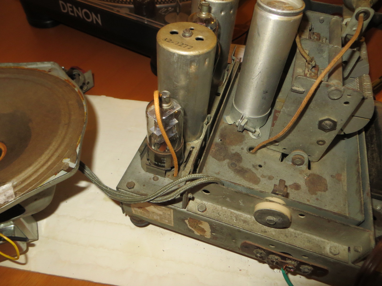

Drilled out the other electrolytic capacitor and inserted the head of the new one that had been hanging. Probably will leave the last one alone.  Other new cap is rather stiff in air where it's at, not floppy like the other one.
Lookin' good!! I do the tape or toilet paper trick on bolts and bods wrenches or sockets all the time! Expletives aid in disassembly / assembly. "If at first you don't receive, curse at it and try again!"

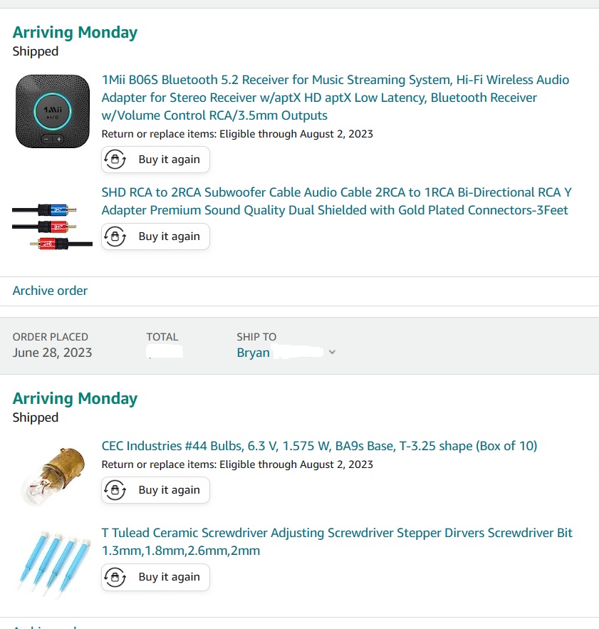

Thanks !   I already ordered a Bluetooth receiver that's Alexa compatible with RCA outputs, and a Y connector. I'll just get Alexa to play 30's - 50's playlists.
