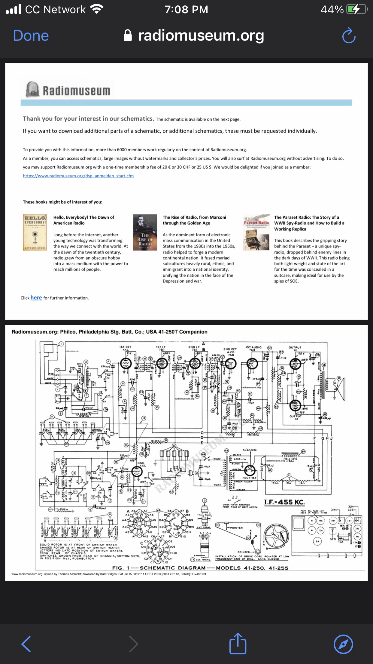

This has the original 84 tube. As I’m reading the schematic the positive side of the 12mfd capacitor
goes to pin 5. The schematic symbol in the Philco schematic doesn’t match the tube data sheet I have. More to think about
The cathode of an 84 is pin 4. Pins 1 and 5 are the heater pins. Connect the positive of the 12 mfd cap to pin 4 and the field coil lead. One of the first things I do to the schematic is number all tube pins (in pencil).
Thanks. I was having a time figuring out the tube diagram.

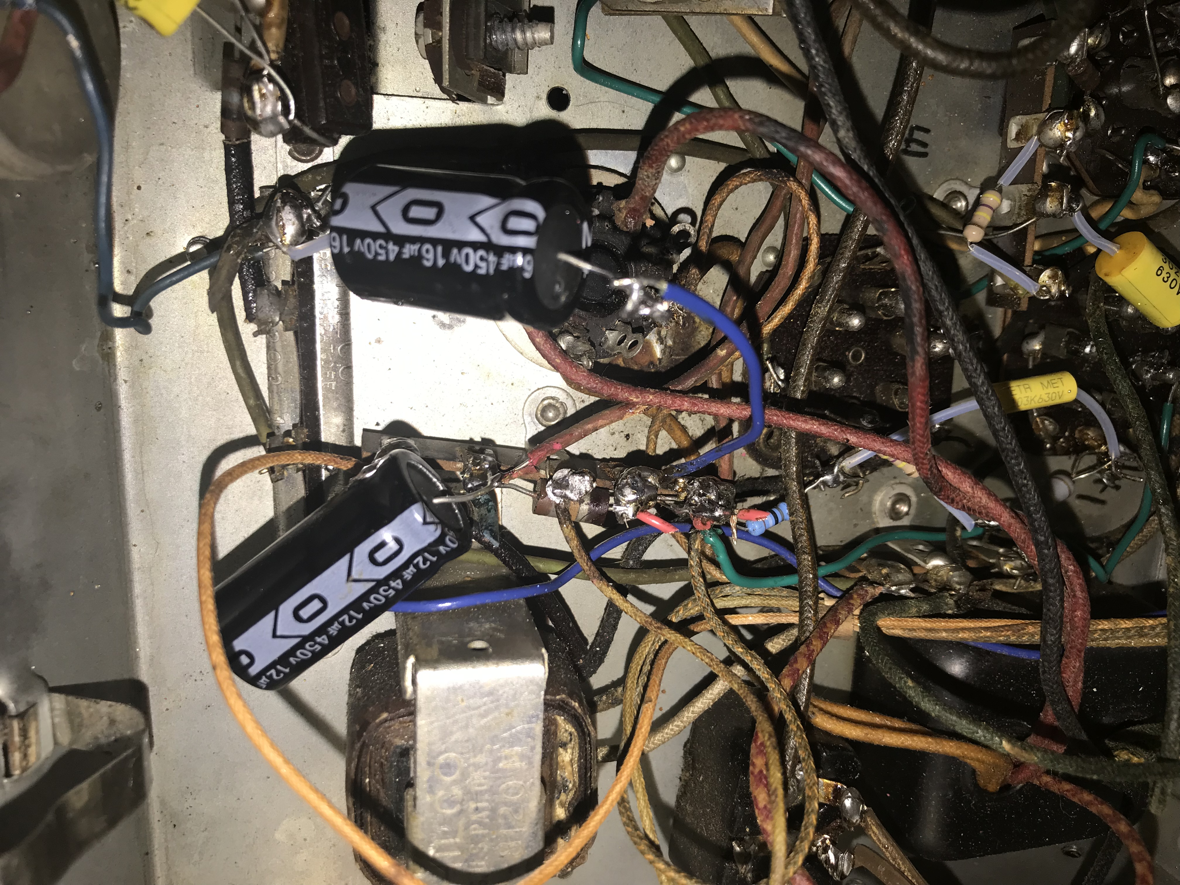

For some reason this person connected a cap to the 41 tube. Plus two 20 mfd caps - one connected directly up to the bakelight block. I’m not sure how this even was working. And two 20 mfd caps in series.
I’ve got an 8, 12, and 16 mfd cap on order so I can make this all correct. Parts 27 - an 8-16 dual cap and 62 on the parts list - 12 mfd

Clearly the radio was powering up so it’s fundamentally sound. My thought is that some of that crumbling wiring just shorted out.
My 41-250 works - and I recapped it according to what was there. It appears to be wrong. I started looking at this and see it’s all miswired.
I plan to recap this with the correct values. I still need to figure out where the 8mfd goes to ground. The chassis I think judging from the schematic.
I plan to assume going forward that every radio I touch has been wired incorrectly.
I’m sort of wondering how this even worked wired like this. I plan to take a week while I wait for my parts and consider this further. There is a 5Y3 substitution for the 84 but I don’t understand yet what difference that would be making in the circuit.
Did you know you can find the 41-250 service information, along with all other prewar Philcos (and many postwar Philco models as well), right here on this website?
And they are high resolution scans, also, not low-res like you get on that other site you obtained your schematic from.
Just click the Philco Library link at the top or bottom of any page in the Philco Phorum.
Then, hover your mouse over Service Info on the top banner, and pick the year range you need.
From there, pick the schematic you need.
Simple as that Icon_smile
That may be a typo somewhere.  The 12 uF cap + lead and the input to the field coil (also serves as a choke) should be going to the cathode of the 84, Pin 4 per the RCA Receiving Tube Manual RC12 (1934).  Pins 1 and 5 are the filament (heater), which is insulated from the cathode.  Pin 5 will either be chassis ground or 6VAC above chassis ground, as this tube is heated by the same winding as the rest of the tubes are heated.  So, if the input to the filter is actually connected to Pin 5 instead of Pin 4 of the 84, then the radio will not work.
The "other guy" put 20uF caps in series, likely to lower the capacitance to somewhere near the spec.  Back in the day, electrolytics were rated - 20% / + 100%, so a 12 uF cap could be anywhere between 10 and 24 uF.  I don't think that using 20uF caps in the power supply would be too much of an issue.  It would raise the voltages a little.  The only issue here is that both RCA and Sylvania indicate the cap value for a cap input filter is 4uF.
I know. I just included it by habit since I’m used to getting yelled at on Facebook when I forget to include a schematic. I’ll grab that schematic you suggest. Thanks.

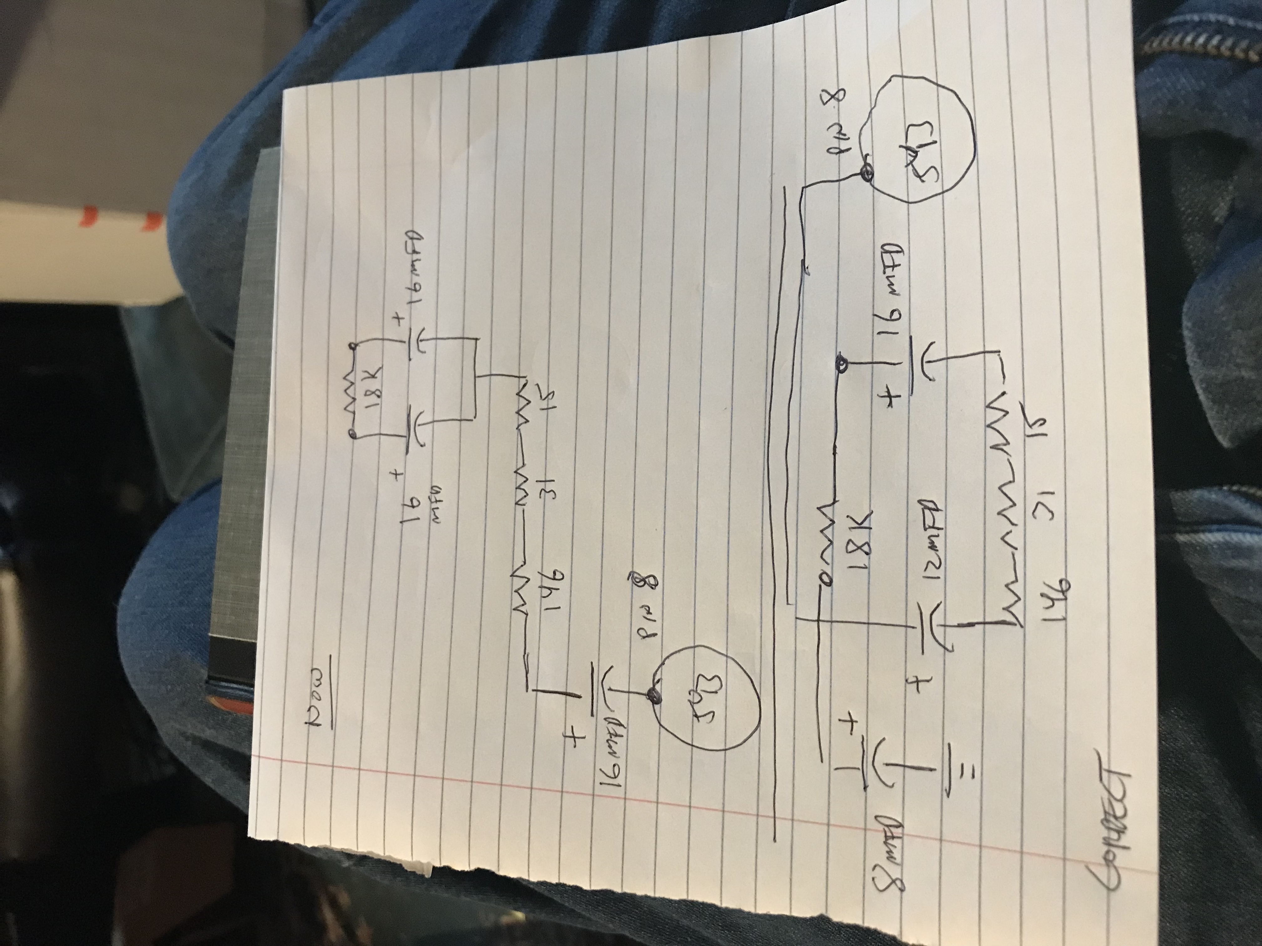

The "Now" drawing of the 5Y3 circuit is incorrect and will not work. A cap can't couple DC.
The "correct" version may be slightly incorrect, though much better. The junction of the - terminal of the 12uF cap and the 146 Ohm resistor goes to the center tap of the HV secondary of the power transformer. this connection is NOT grounded. The - terminal of the 16uF cap and the 15 Ohm resistor is at chassis ground. This series of resistors between chassis ground and the B secondary center tap was a common method to get the bias required for the audio output tube and some others.
The filter circuit as drawn in the actual schematic 41-250 works with either the 84 or the 5Y3.

@Bridkarl, you will get this to go. In terms of the "correctness" of having modified the circuit, this may have occurred during WWII when new radios and even replacement tubes were not available (although this radio should have been rather new). For the lack of being able to get an 84, replacing the transformer, so the tech could use a 5Y3 may have been a bit extreme but, hey, you do what you can do. Bottom line here, if you look at the 41-250 schematic, duplicate that exactly, except hook up what ordinarily went to Pin 4 of the 84 to pin 8 of the 5Y3, you should be good.
Thanks for the encouragement. As it sits I have a 12 mfd and a 16 mfd connected negative to each end of the candleohm resistor.
I have the positives connected to lugs 2 and 4 of the terminal strip - counting from the top with the chassis lying on its back.
I connected the positive of 20 mfd cap to pin 8 of the 5Y3 with the negative just alligator clipped to the chassis.
All I’m getting is a buzzing noise. I’m just going to think about this for the work week and try again. There’s something I’m missing about the 5Y3 setup.
