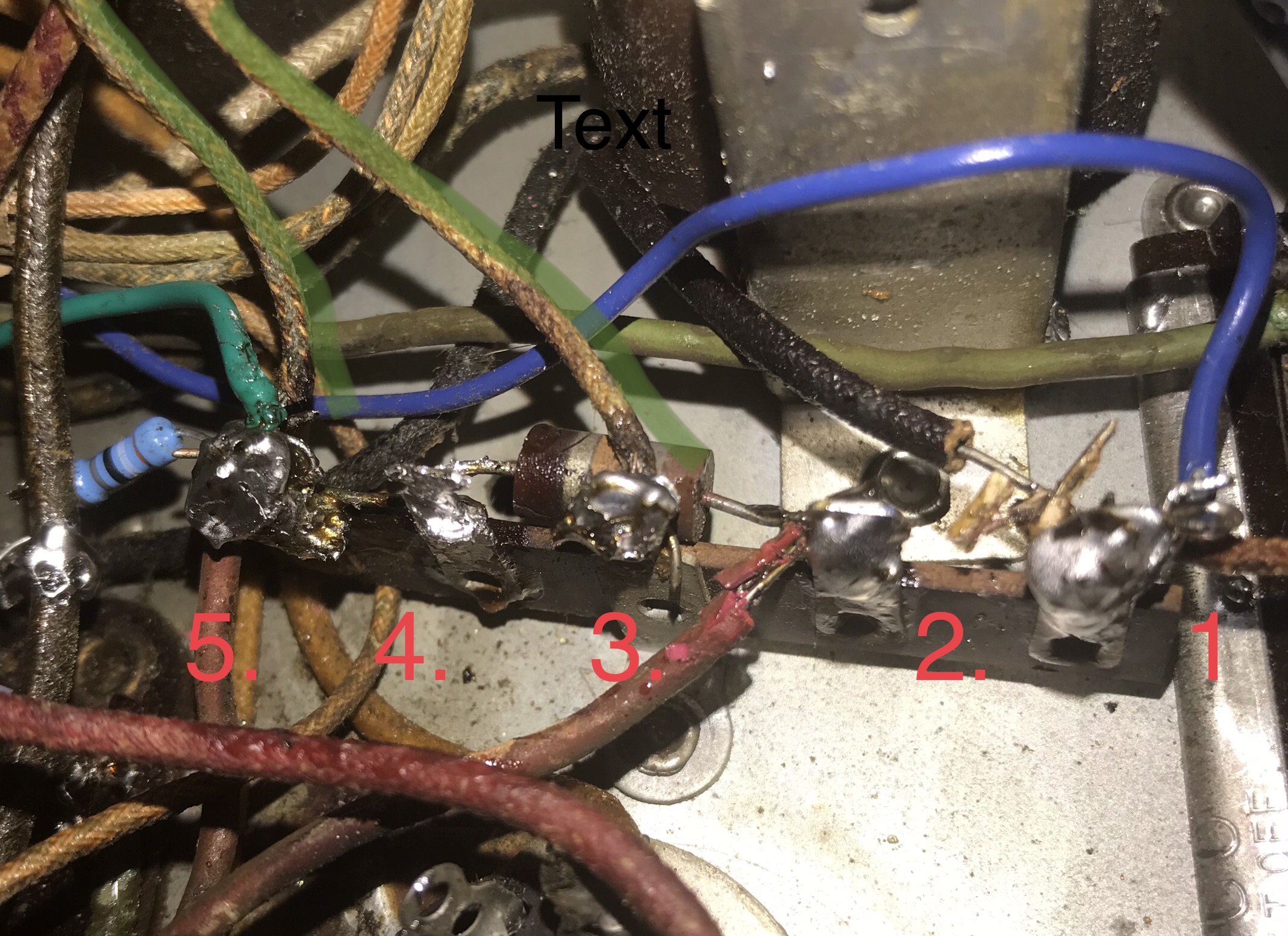

I’ll be sure to add the part numbers. I add a picture of the terminal strip. I’ve since cleaned this up, but it might be helpful for someone doing this. This is how I am understanding this based on what people here said and an afternoon working on this.
I’m reading this as part 27 - 8 mfd positive- going to 5 on the terminal strip and 27a - 16 mfd positive going to 4.
The tab 2 on the terminal strip is the red wire going to the 2nd IF transformer. That’s one side of resistor number 28 with the positive side of 27 on the other side.
The negative common ground goes to the 15 ohm end of the candleohm. Right side of the candleohm.
 Part 62 - the 12 mfd cap has the negative to the
146 ohm end of the candleohm with the positive to the pin 8 of the 5Y3. This negative will be on the left side of the candleohm with the chassis front away from you.
Pin 8 is the same as pin 4 on the original 84 tube.
The picture is some other Philco like a 41-280 I found but it seems the same layout. Obviously more to do - I need to put some heatshrink tape on some of the wires. Once my new parts come I can check out my understanding of this and see if it actually works.

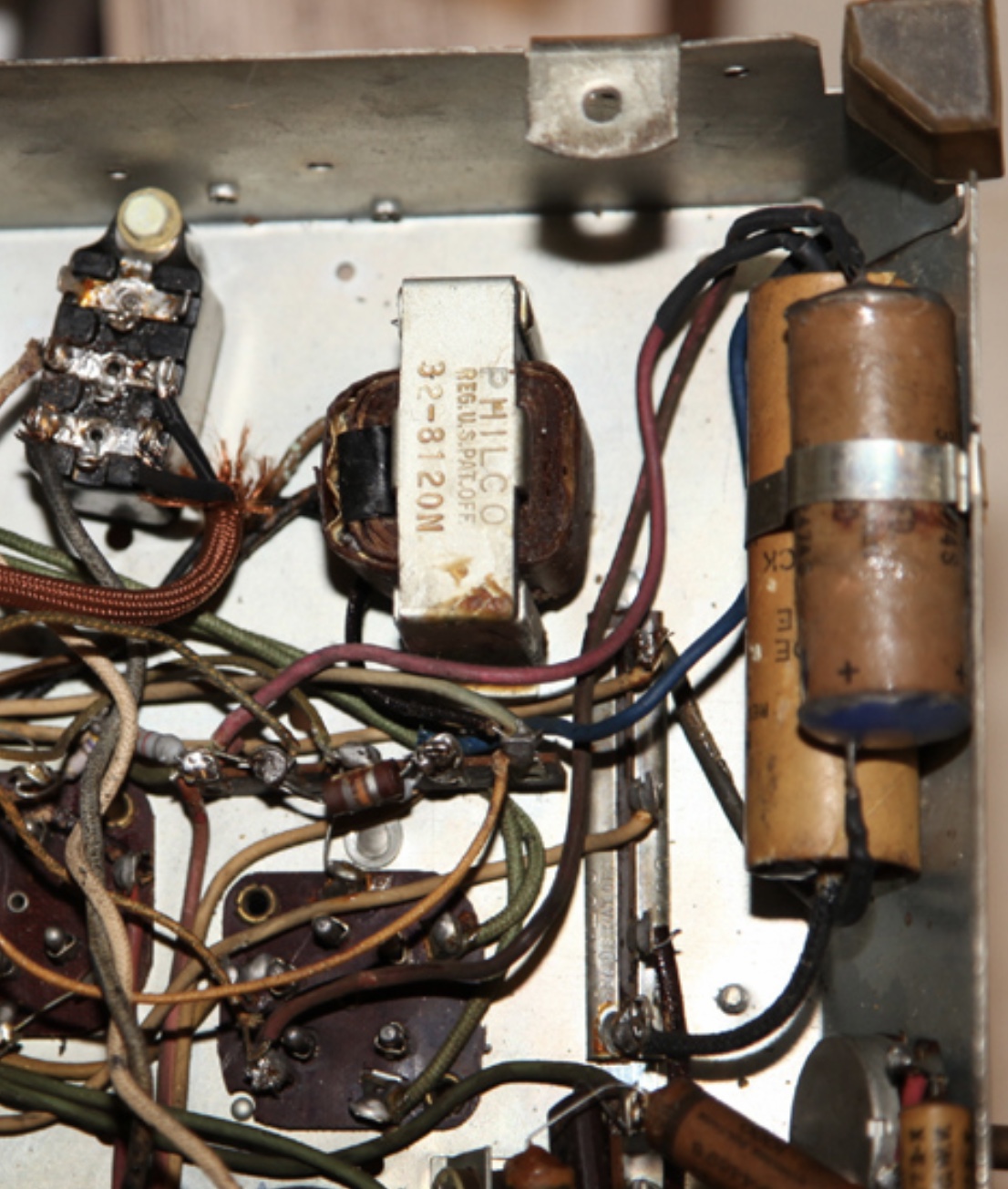

Hi Bridkarl,
Thanks for the pictures, they are helpful.  On first view, if the 16 uF cap appears to be soldered to pin 8 of the 5Y3.  If this is the case, then the 2 caps may be swapped.  This is not horrible, it is just not per the schematic.  Make the following checks:

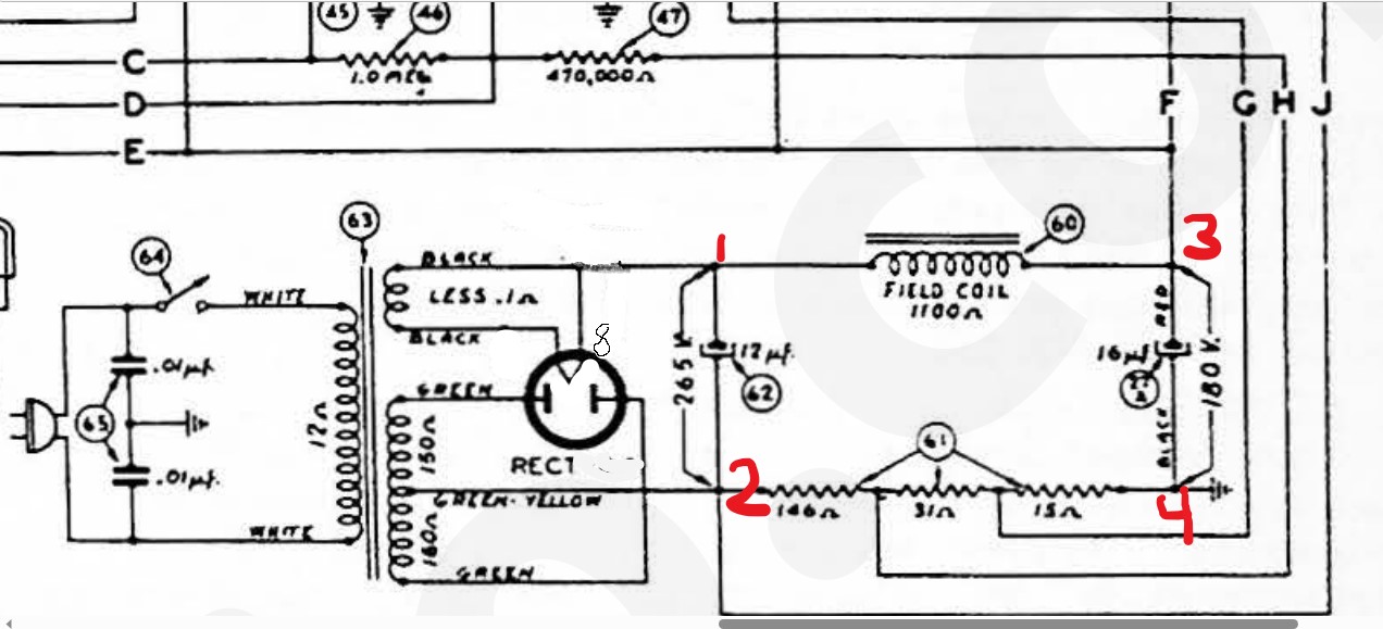

I modified the schematic for you to reflect a 5Y3.  Refer to the pic attached below:
Note that only the 5Y3 heater and HV windings are shown. The heater winding for the other tubes are not shown
Note the red numbers for the following instructions:
    1. This connection is the junction of the 5Y3 filament at Pin 8, the input to the field coil and the + terminal of the 12uf cap, (#62 on the schematic).
    2. This connection is the junction of the - terminal of the 12uF cap (#62), the center tap of the HV secondary winding of the power transformer (This is the winding that feeds the plates of the 5Y3), the 146 Ohm end of the Candohm and Line J. (Line J connects this most negative point of the power supply to the grid bias resistors of the two 41 output tubes.
    3. This connection is the junction of the + terminal of the 16uF cap (#27A) and the B+, Lines E, F to the rest of the radio, feeding the audio output transformer, the 41 screen grid, the 3700 Ohm resistor to the other 41 screen grid, the IF input and output transformer primaries, the plate load resistor for the 1st AF amp, and a voltage divider consisting of resistors #28 and 26.
    4. This connection is the junction of the - terminal of the 16uF cap (#27A), the 15 Ohm end of the Candohm and chassis ground.
    5. See the next diagram.

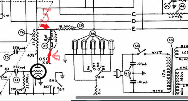

         This is + terminal of the 8uF cap (#27) and the junctions of resistors #28 and 26. This point provides the B+ to the       mixer tube and the screen voltage for the IF tube, and, through the other leg of resistor #26, the 40VDC to the
         oscillator plate.  The - terminal of the 8uF cap is connected to chassis ground.
    Voltage between points 1 and 2 should be about 260VDC.  Voltage between 3 and 4 should be about 180VDC.
