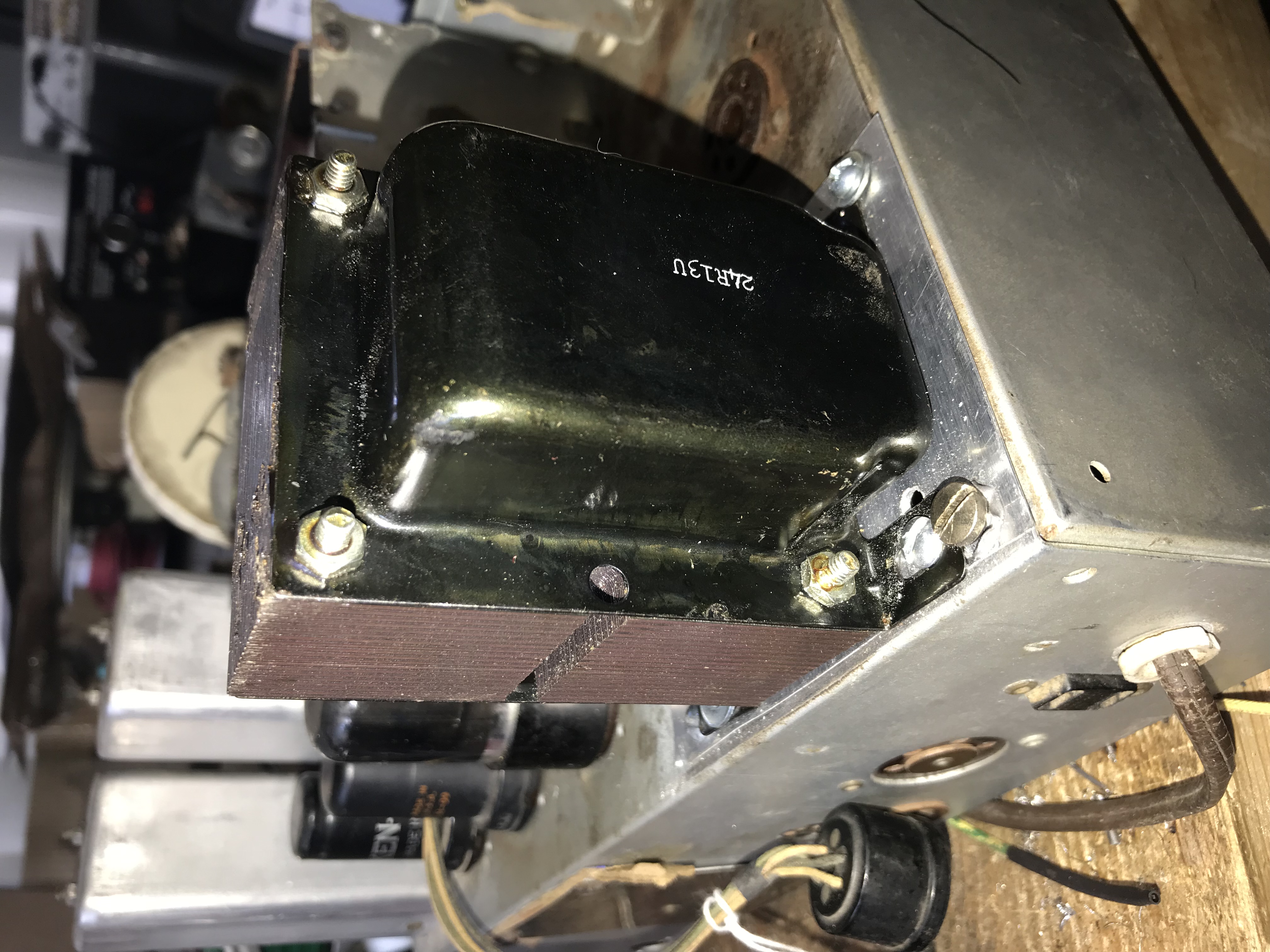

I’m working on this Midwest 88. I put on a replacement transformer. I used an 11 gauge plate to mount the unit on - this preserves the original holes for later replacement if needed.

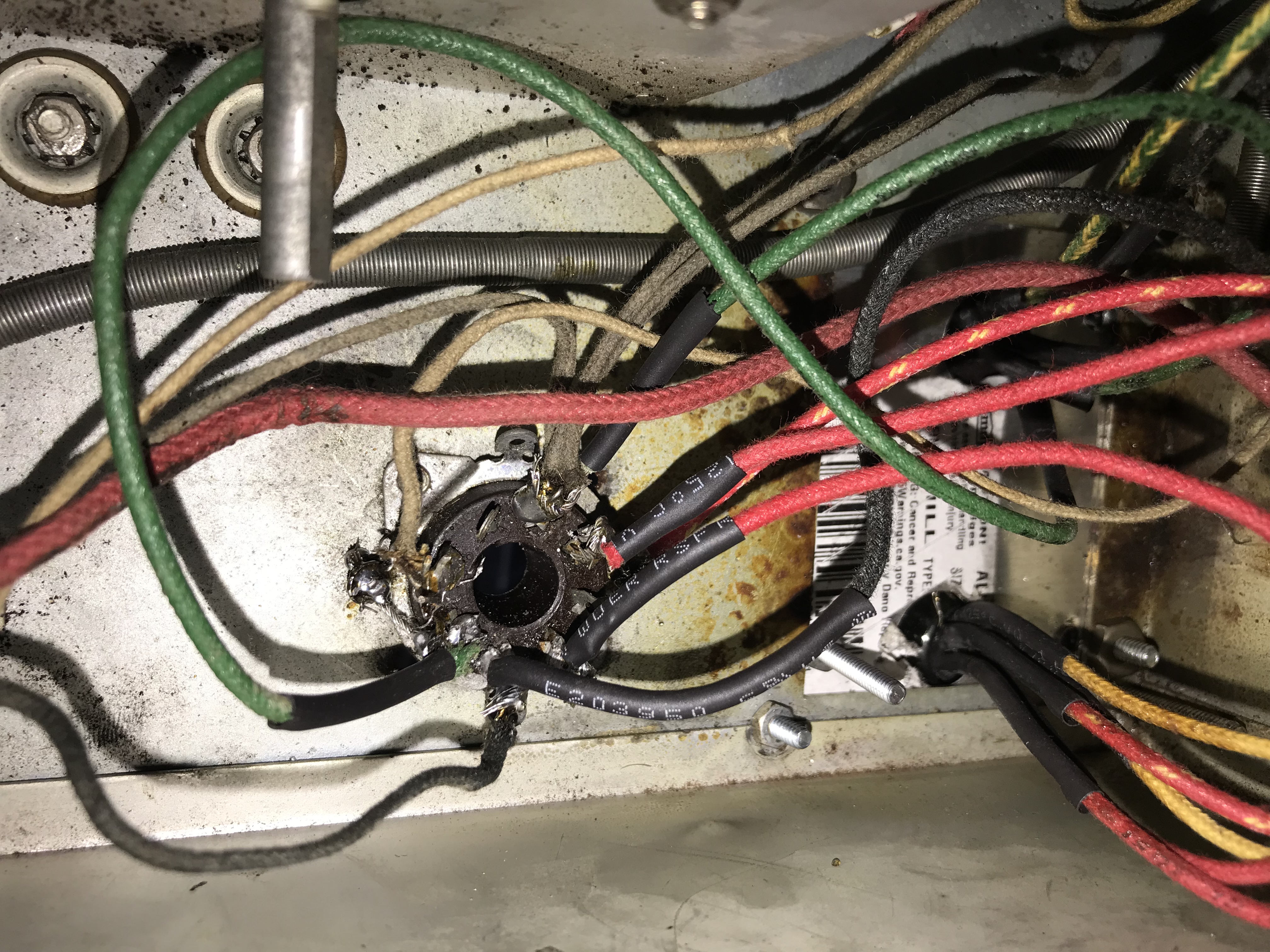

I put heat shrink near the transformer bell to protect the wires from the sharp edges of the metal hole. I did the same on the other side by the socket  just to add some stability.
My soldering is all shiny - the stranded wire sticking out makes it look bad but there is a solid mechanical connection.
I get this may not be how everyone uses heat shrink.
I don’t see what’s wrong with doing it this way. My reasoning was that, from what I’ve seen, over decades normal movement of the radio, vibration, heat, normal deterioration of the cloth insulation causes issues. This preserves enough of the wiring near the transformer that wiring could be replaced - it gives an inch or two to work with so maybe you don’t have to take the transformer apart. It’s just also a way of protecting against a short.

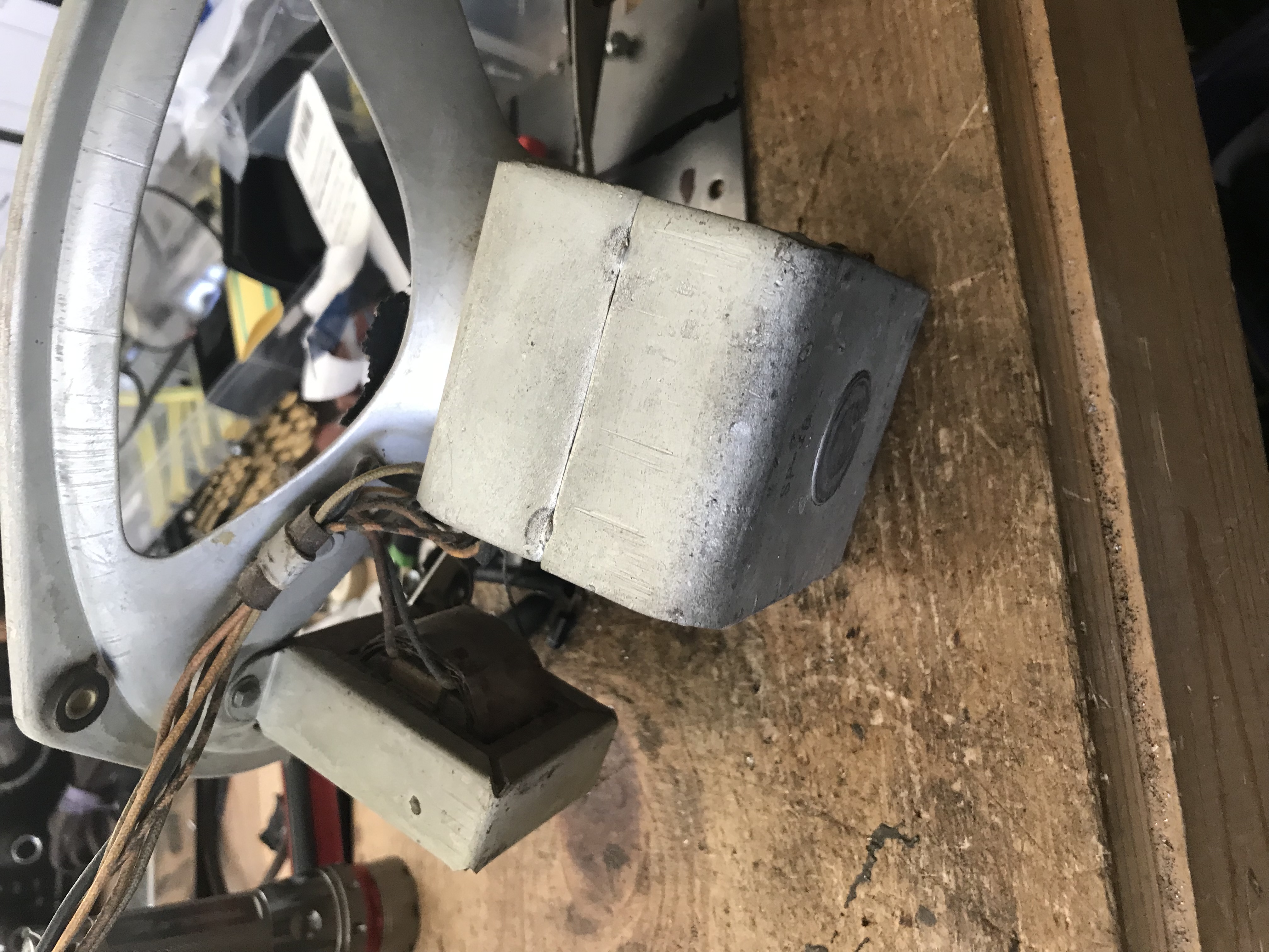

If there’s something fundamentally wrong here I’m happy to listen. My next problem is fixing the speaker.

+1 on Morzh's comments. You have Phriends here. My only suggestion is to clean up the socket, especially of that stray strand. Heatshrinking the wire where it enters the transformer case, even if NOS is a best practice. there was this plastic centipede type stuff that they used to use on one of the instruments that I serviced that you could work around wires threaded through a sharp hole, even after the wiring was installed.

Thanks. I usually clean up all the sockets and tubes last - blow the whole chassis out with an air compressor, use deoxit on the sockets, and also clean the sockets underneath with isopropyl alcohol. That way I know this is all clean and hasn’t been messed up by some other debris, etc. There’s also some greasy residue which is probably nicotine.
I’m planning to touch up all those solder connections so it looks better. I should have tinned the leads before I soldered them in. I will note that these were not tinned originally.

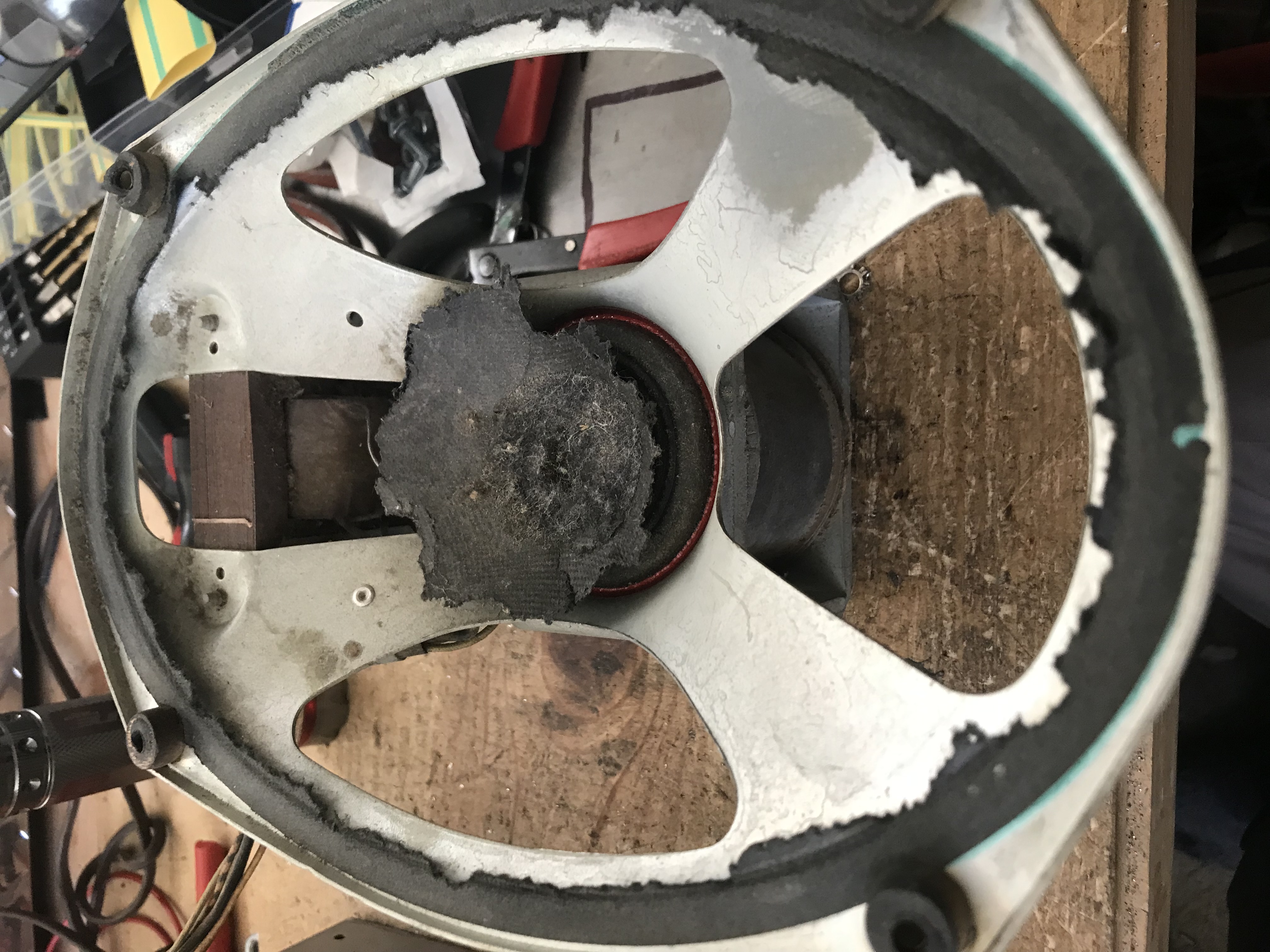

I see your speaker has been converted to a tweeter Icon_sad
There still is a vendor on eBay who has NOS cones and spiders. Your speaker is very salvageable. It is the skill (easy), materials and technique to re-cone. Choose wrong materials and awkward methods and the repair may be mediocre.

Try pre-tinning stranded wires first, do use 63/37 solder so larger strands don't get too stiff. The heat also causes insulation retraction. So wires are not bared when soldered or splayed on bend when soldered. Use LOTS of active liquid solder flux, and 91% alcohol to clean the rosin mess.

On soldering stranded wire. I twist it well befor I tin it. If I need to bend around something.....well, there is no good solution here and this is why I prefer the solid type if I need to.
I do not use acid flux. Rosin, rosin in alcohol, or rosin core solder wire, eutectic Tin-Led type only for my home electrical needs..
A lot of radios had a rubber, or brass grommet in the holes where they routed wires so as not to chafe the insulation. The horizontally mounted power transformers did not usually need this of course, leaving a rectangular hole in the chassis. I've been pointing people towards the power transformers AES sells as replacements in tube guitar amps as many of those are horizontally mounted, and for some reason cheaper then the generic replacements Hammond offers, which are all vertical mounted. I've found that preparation is more important then a steady hand for soldering, I have a habit of using fine sandpaper to polish up leads on components, and the ends of wires, using flux seems a good idea too. Soldering cloth wires is nasty sometimes, the rubber, or whatever it is inside, gets between the strands, and likes to melt black goo into the joint, one time I had to clean them with lacquer thinner just to prevent this with a transformer I was re-using. I never did bother with Fakebook, or Twatter, it's just not my thing, the number of "retired" Feds Elon Musk had to fire from Twatter was disturbing, meanwhile Meta seems to be lurching from financial failure to failure, not that I care.
