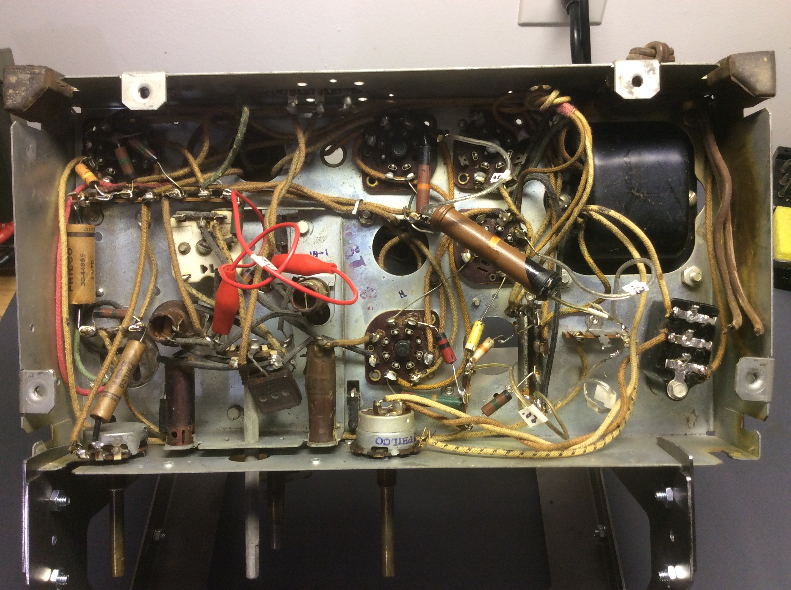

Hello Guys,
Here is one of the coupling capacitors that I stuffed with the new one.
.015ufd at 630 volts
Hello Everyone,
Well I am still hoping someone has Philco part no. 30-2210 electrolytic can it is 12ufd .
since mine is missing .
I did order some parts including no 16 which is a 10k 3 watt power resistor .
I got the dual electrolytic which is a 4ufd and 8 ufd I used film capacitors rated at 630 volts .
Hello Guys,
Here is the a photo showing the progress on the radio !
First one shows the rest of the coupling capacitors that I re-stuffed and in the second photo you can see the first two capacitors installed plus the one dual section filter capacitor .
Here is a closeup of the two coupling capacitors and the filter capacitor as you can see the new cloth covered wire .
Nice.
Hello morzh,
thank you it's been slow going with everything else going on !
That red gator wire isn't permanent, is it? Icon_lol
Hello Morzh,
"That red gator wire isn't permanent, is it?:
I thought it would work as  a good fusable link !
saturday I worked on getting the second Filter can no 45 on the diagram ready to re-stuff .
I am Using Film capacitors to replace the Wet electrolytic with the original capacitor value was 12 ufd I decided to use two 4.7 ufd's and one 3.9ufd capacitor because of room it meassured just over 13 ufd .
P.S. I will post photos later sunday .
Hello Guys,
Here is a few photos of that Capacitor !
I ended up using a couple layers of heat shrink for added protection .
next step is to fix some of the original owner or repir guy named Jerry's nice floating connections and wires when they did repairs in the past .
P.S. Darn Jerry why do they love old cars and radios so much  Icon_lol
