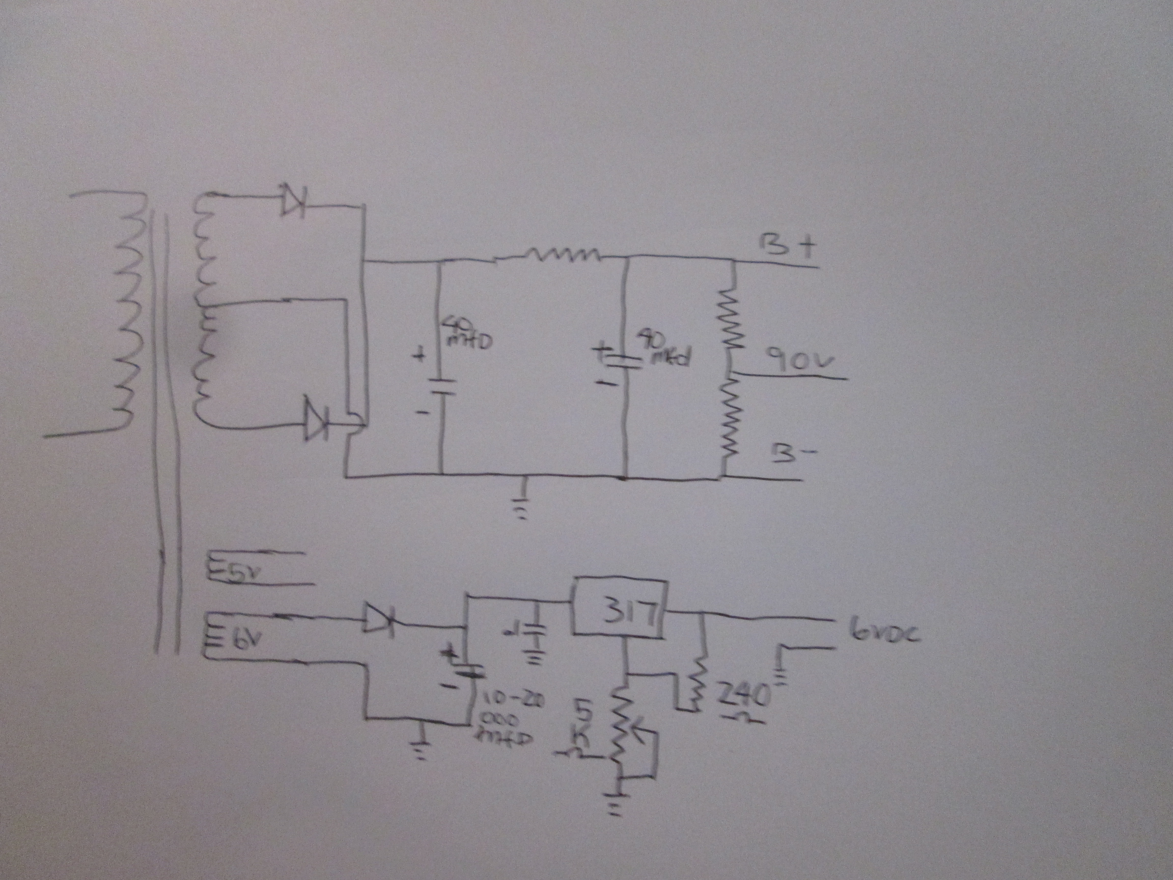

Living in the power outage state (Florida) Farm sets were around until transistors came alone. I know a number of people who have sets that have been in the family a long time. Myself I do like a good outage gets rid of all the line noise. Plus I can play with the generator. Were are looking at 40-50 MPH winds tomorrow will be using a farm set powered by a solar generator and a 1.5 volt battery. The B battery is 90 volts have a converter as shown on Phils old radios.  https://antiqueradio.org/bsupply.htm
That transformerless design is a little dangerous with the line connected to the B-. If the ant terminal ever came in contact with ground it's bye bye antenna coil poof gone in a flash.  You may want to consider something like this:
It allows adjustable A voltage from 1.5v to abt 6v @ 1.5A.

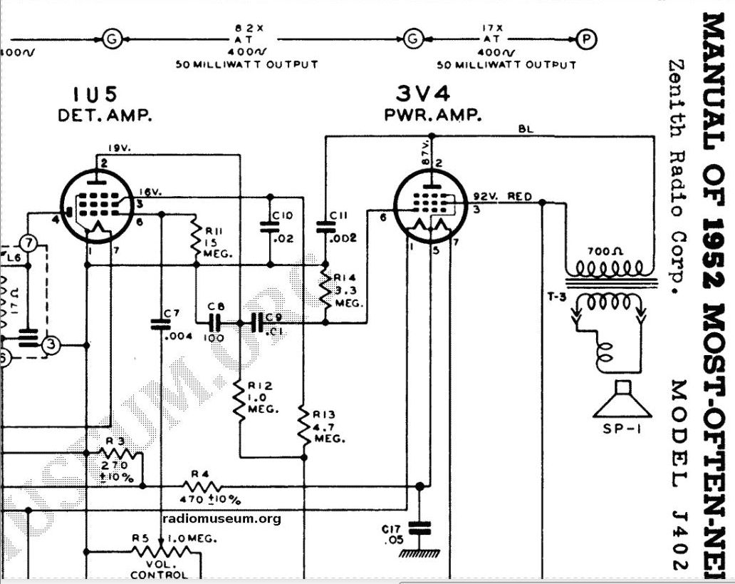

I have have another audio transformer from another battery set (a 1950 Zenih) and I am wondering if it can be used to replace my toasted transformer. See attached photo. the primary DC resistence is 727 ohms and the secondart is .6 ohms.

You should compare the 3V4 plate load impedance to the one in your radio. If it's close then it should work well.
Chip,
How you solve the mystery is to ignore the dc resistance of the opt. Lookup the plate load resistance of the tubes that you are comparing. Since that set had a 1Q5 you're looking for something around 8K.
There is also the 1T5G/GT which has similar specs to the 1A5G/GT https://frank.pocnet.net/sheets/127/1/1T5GT.pdf except for the fact that the plate load resistance is only 14,000 rather then 25,000 Ohms, and the 1T5 is a beam power tube.
I looked up the load resistance for the 3v4 and it is 10k
I looked up the load resistance of my 1q5 and it is 9k
So I do think I will use the audio transformer from the 3v4, it should work.

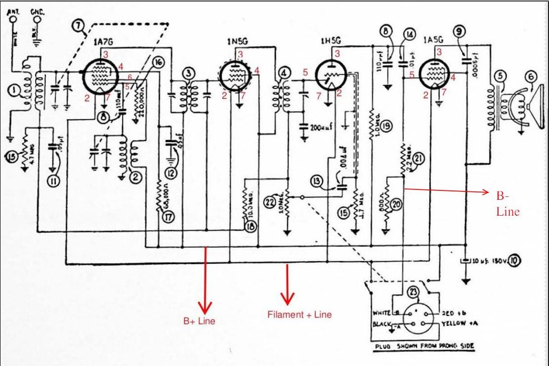

I am now looking over the power supply section of the schematic. I labeled the Voltage line of the B and A battery's.  Looking at the B- line on the schematic (marked with a red arrow), is that the only place the B genitive goes?  See attached
The process of learning is to fix something that is not broke.
A= filament voltage B= plate voltage.
so yes.
