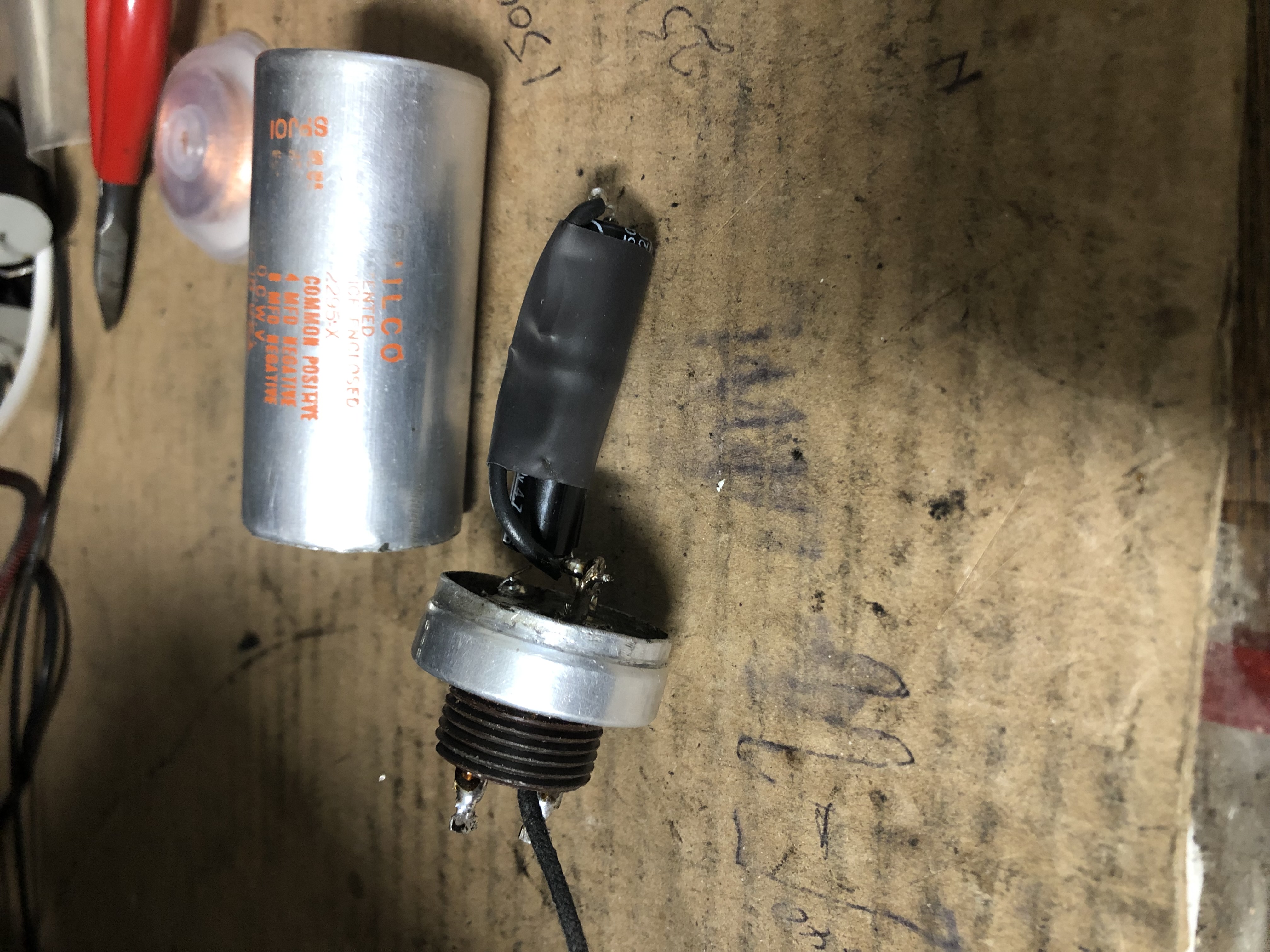

Progress continues on the 1540 with a small patch to a tear in the speaker cone. I cleaned out the dual electrolytic can and installed 4.7 and 10 mf caps adding a wire through the base to pick up chassis ground. Attached picture.   It worked pretty well cutting the cap around a the neck just above the base.  I can slip the top of the can over the narrower piece left on the base and it looks original except fo the extra white coming out of the base on the component side.

I saw the words "common positive" on the electrolytic can. Did you join the plus wires of the caps and connect them to ground?
RodB
That twisted my mind up a bit at first and I was scratching my head for longer than I want to admit but it eventually sunk in with what they were doing.  Let’s put it this way… I’m glad I bought a few set of caps.
I had some nice French non polarized made caps I temporarily wired under the chassis so I could press on but they were a bit too big. And I did not like the way I had to scab them in.   I liked the end result re-stuffing the can once I understood the configuration.  Getting that old cap out of the can was a but time consuming but a little heat was my friend.
F-1540,
RodB commented, I saw the words "common positive" on the electrolytic can. Did you join the plus wires of the caps and connect them to ground?
I sure hope you didn't connect the positive leads to ground. The caps will likely explode!
Take a look at the schematic. Counterintuitively, the NEGATIVE lead of the 8uf cap is connected to the positive ground of the radio. To the radio chassis, that is. The chassis IS negative relative to the cathode of the rectifier tube, where the positive end of the cap connects. By more than 200 volts! The can itself rests on the case and is grounded also.
The 2 "common positive" leads of the 4uf and 8uf caps are connected to each other and to the cathode of the rectifier tube. In any event, neither contact on the bottom of the cap can connects to ground. Only the case itself is grounded.

Also, the filter electrolytic can part #62 does have a common positive as the earlier image of the OEM can suggests. The negatives are respectively connected to each side of the filter choke that is in the B- of the power transformer. The chokes resistance also serves as the bias source for the output circuits.
