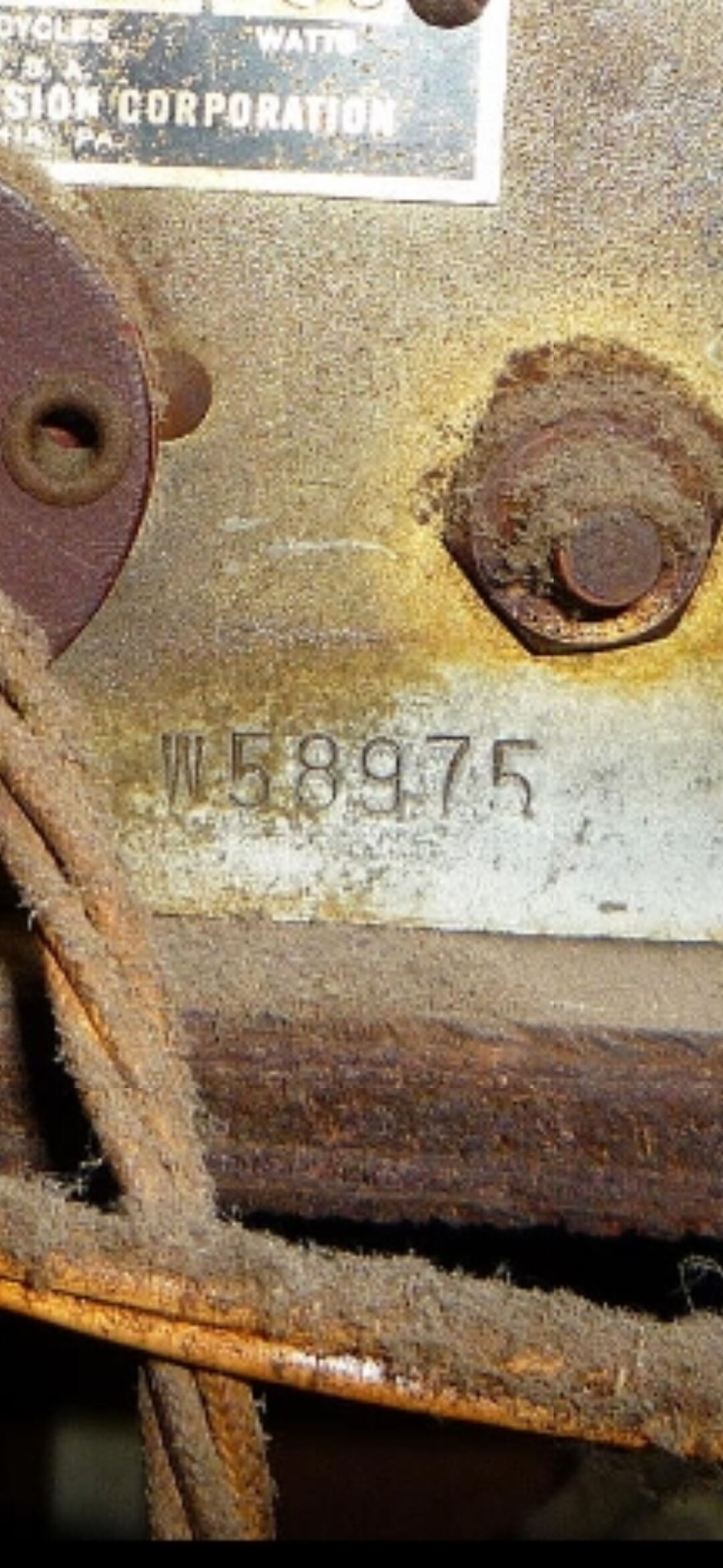

I have attached photos of the chassis that may help. The plate shows it to be a 16E chassis.
I called the company that became the successor to the one that sold it, but they have no info on what was sold in the 1930's or whether the cases were locally made.
I'm by no mean a Philco Expert, but I believe seeing a metal tag on the chassis ID's it as a Canadian model.....   It's a great looking console. I would buy iy unless it was way over priced.

The model plate also says 230 volts. I'm thinking export radio for Europe perhaps. Take care and BE HEALTHY! Garyl
