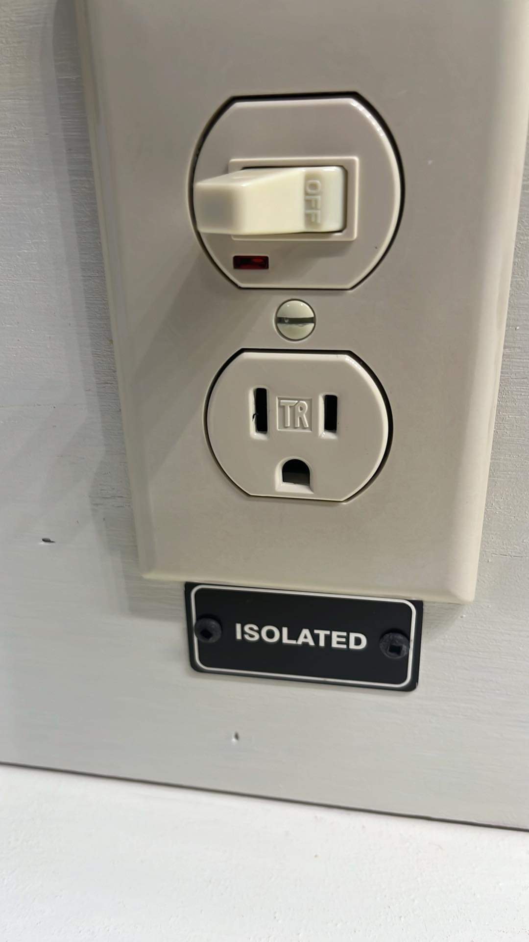

Well, after months and months of on-off work on it, my test bench rebuild is almost complete. Waiting for a couple more escutcheons, a replacement gauge and maybe some metal trim along the edges of the back. What do you think?

Peter,
I installed:
-Isolation transformer
-Variac
-Dim bulb tester
-Antenna/ground connections
The transformer has an isolated plug, and also feeds the variac
The entire bench is controlled through a switch, so it can be shut down easily.
I built it because I got tired of setting up equipment each time I needed to use it, and cords...cords...cords running everywhere! Plus now I have much more usable bench space. Icon_smile

You could build a bench with both 120 and 240 volt outlets, plus the variac I used was capable of MUCH higher voltage. But the isolation transformer is only 120v, at 2.18 amps max. I don't really need more than that usually...
