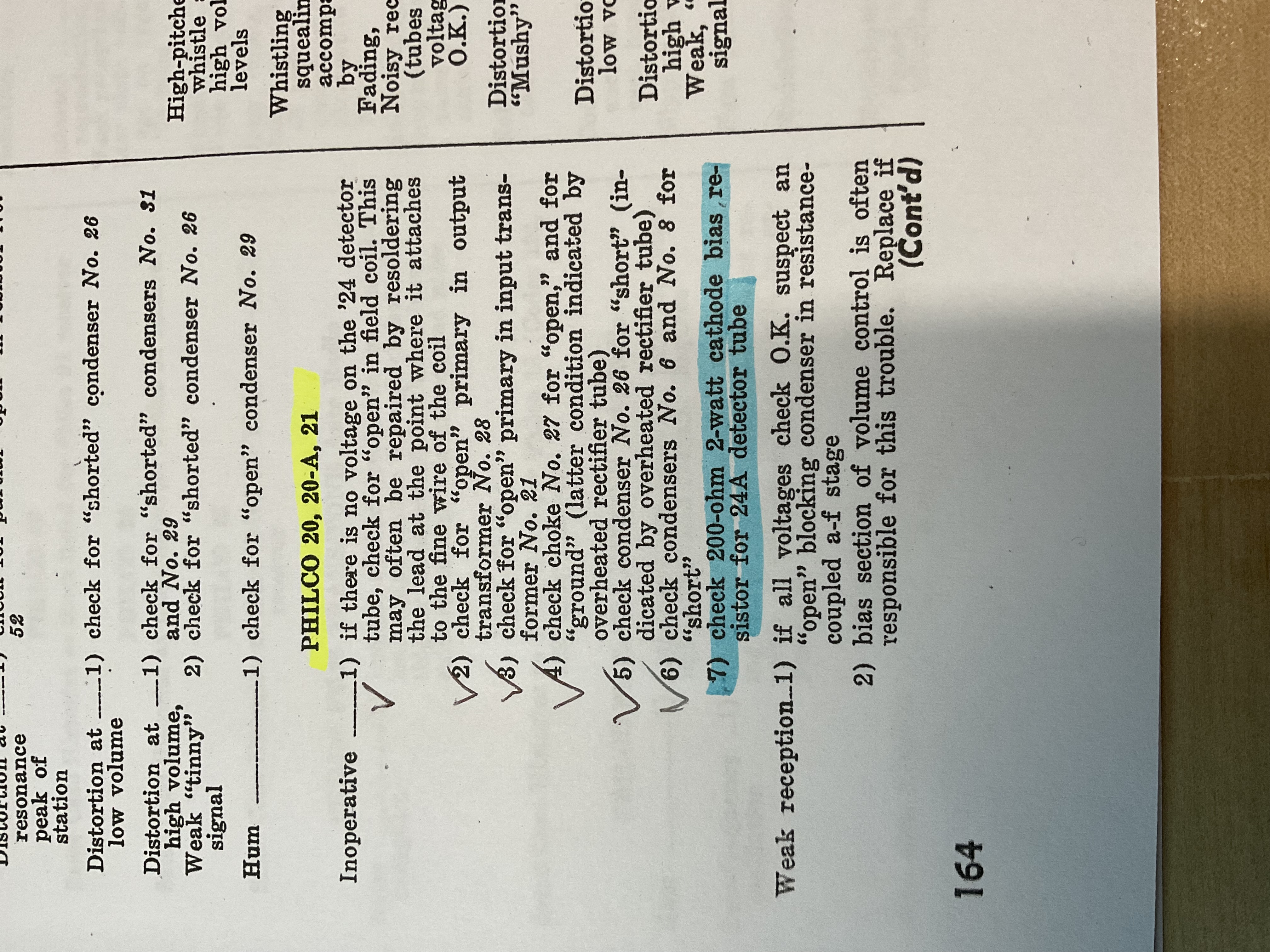

Then to confuse me more, I looked in the Radio-Troubleshooter’s-Handbook (I like to look at the case-histories on models I am working on).  In RTH for model 20 it referenced checking the detector tube cathode bias resistor to ensure it is a 200 ohm, 2W resistor and isn’t open.
How can I determine if there was some change done to reduce this resistor value from 50K down to the 1K installed or to the 200 ohm noted in the RTH?  Anyone run across this and have any insight?  I can replace it with a 50K and see what happens or leave the 1K.  (I’m still preparing for re-cap, I discovered this during all my initial checks prior to power on)

Maybe they referred to the part of the dual volume pot, which is also a cathode bias, which is 250 Ohm.
Attached is a pic of the resistor installed. Brown-black-red, assuming 1K?
Also attached is a pic from the RTH page, note 7.

The resistor in spot 12 is marked as 1K and measures 1.2K. But schematic says 50K. I can easily replace it, just wondered if anyone knows of a reason it would have this value, particularly with the notes in the RTH. Thanks.

As you could see, the resistor there is Orange, and the document will say "12     50,000     Orange"
Good deal, thanks @morzh. I’ll replace it with a 50K. Appreciate all the input.
