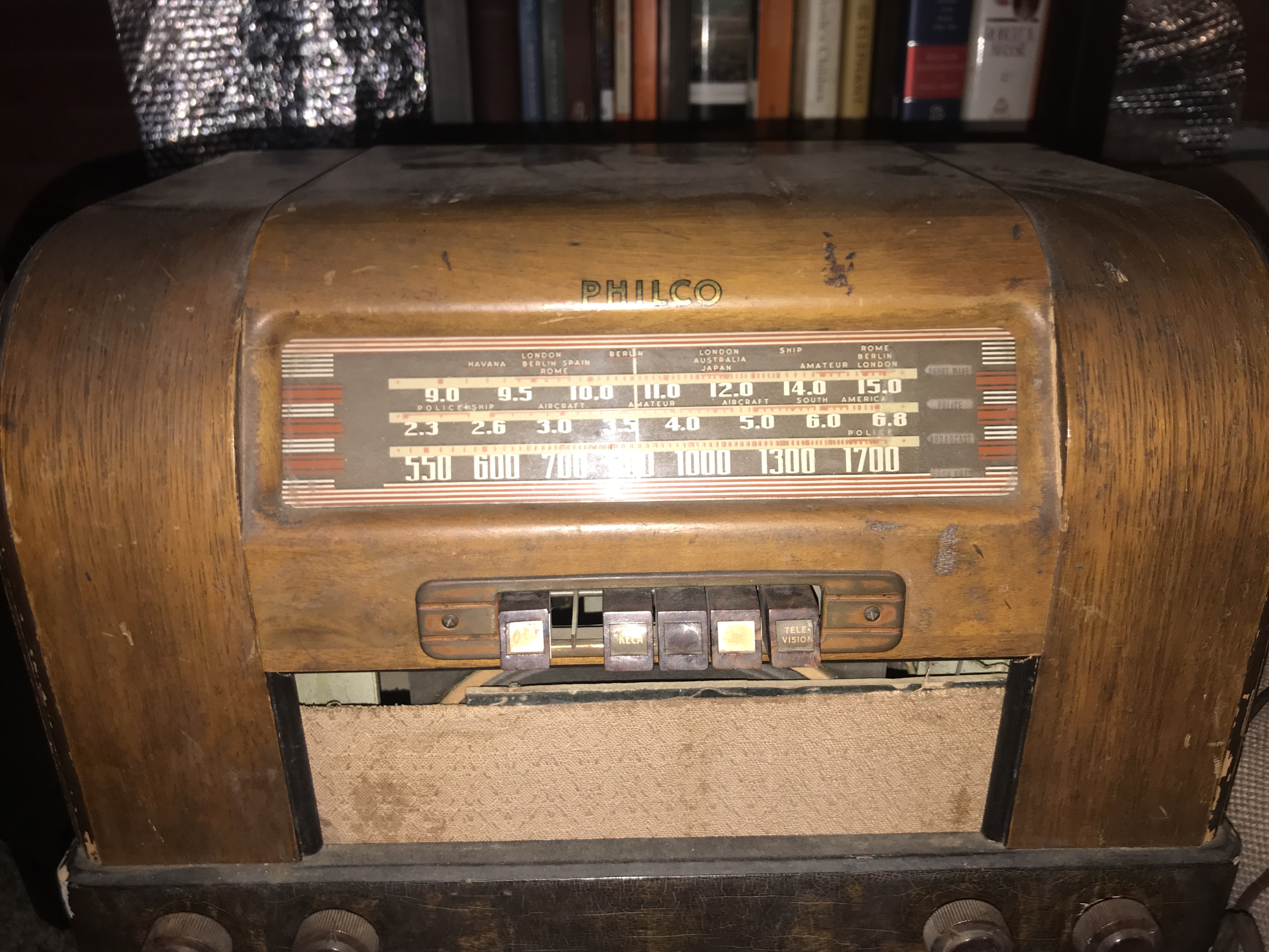

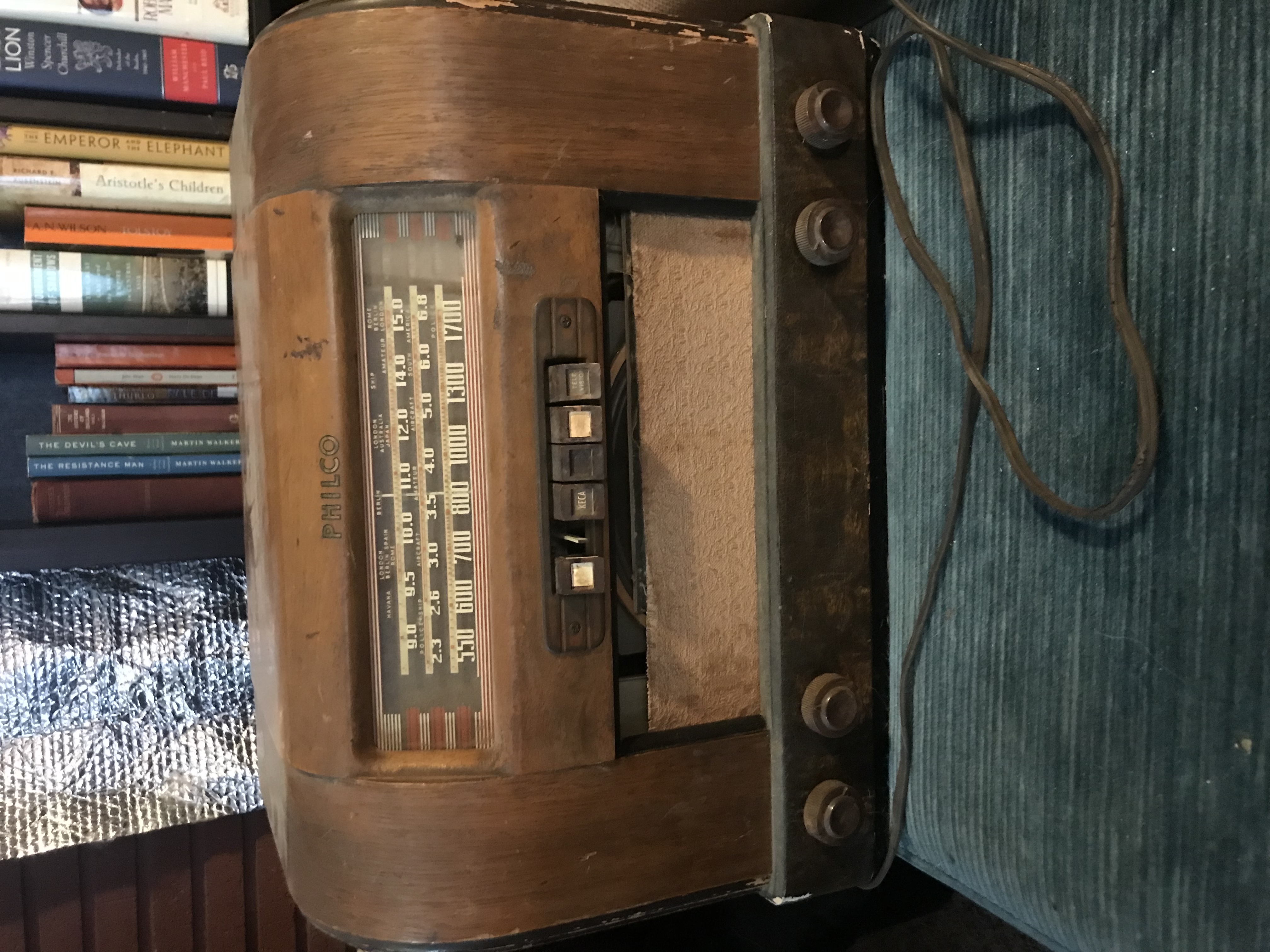

This appeared on my porch this morning for $30.
Appears to be completely original and intact down to the Philco tubes and the original grill cloth. The 7Y4 rectifier is missing and the power cord is trashed.
Case is in excellent shape. Advice on proper cleaning/polishing procedure would be appreciated.

You have received what should be when restored a very fine receiver, I have that set. It used to pick up SW with just internal antenna in the daytime. I use it now for AM and AM DX. I may have that tube for you if you need one and most likely any others if they test bad. LMK. BTW you paid 9.95 less than it was originally priced!Icon_smile.

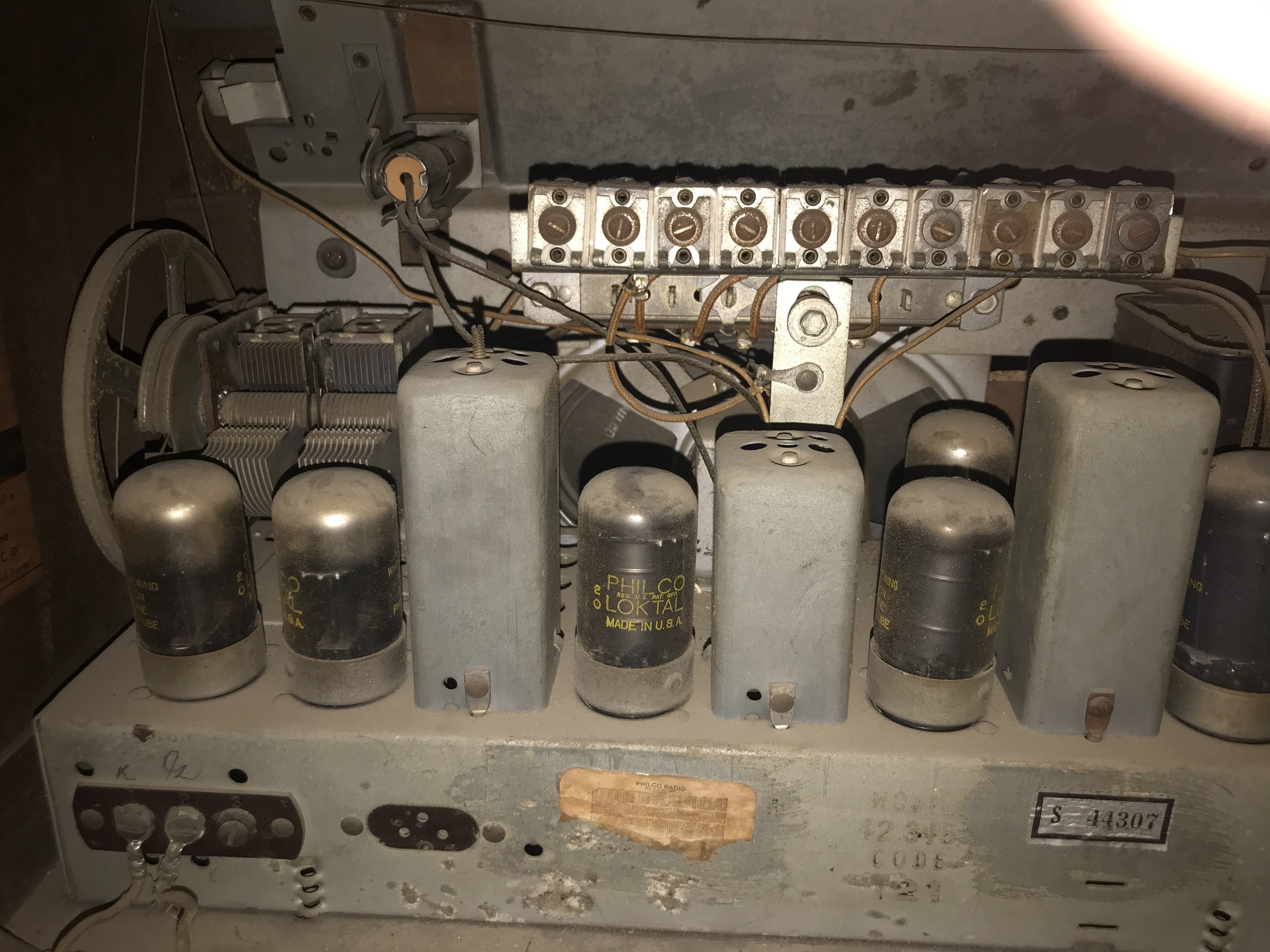

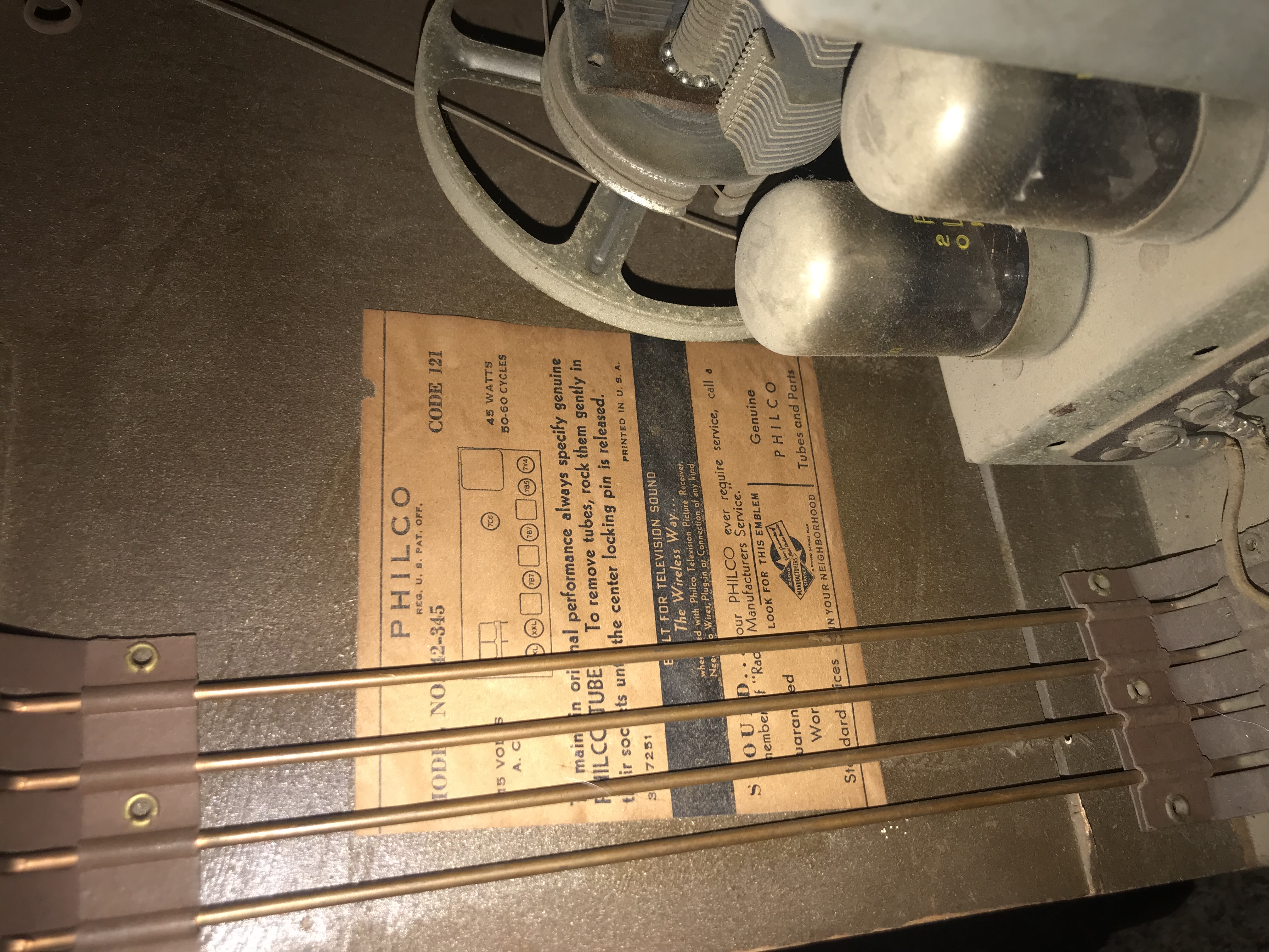

I found the missing tube stuck in the back of the radio. A complete set of Philco branded tubes.

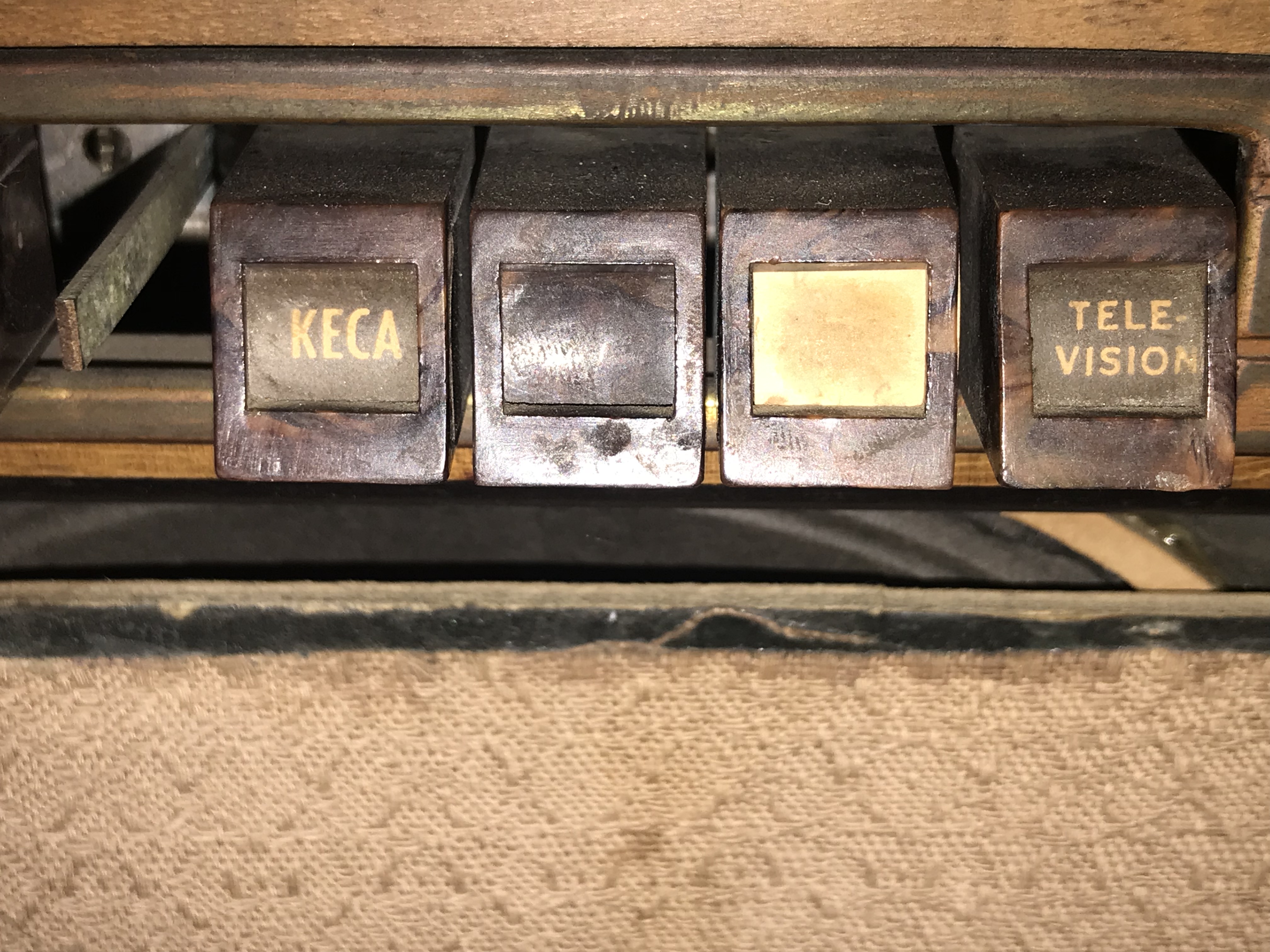

I’ve ordered a complete set of replacement caps this morning. And a can of non-abrasive Goop to clean up the case.  The only missing part is a missing push button.

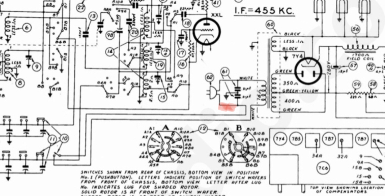

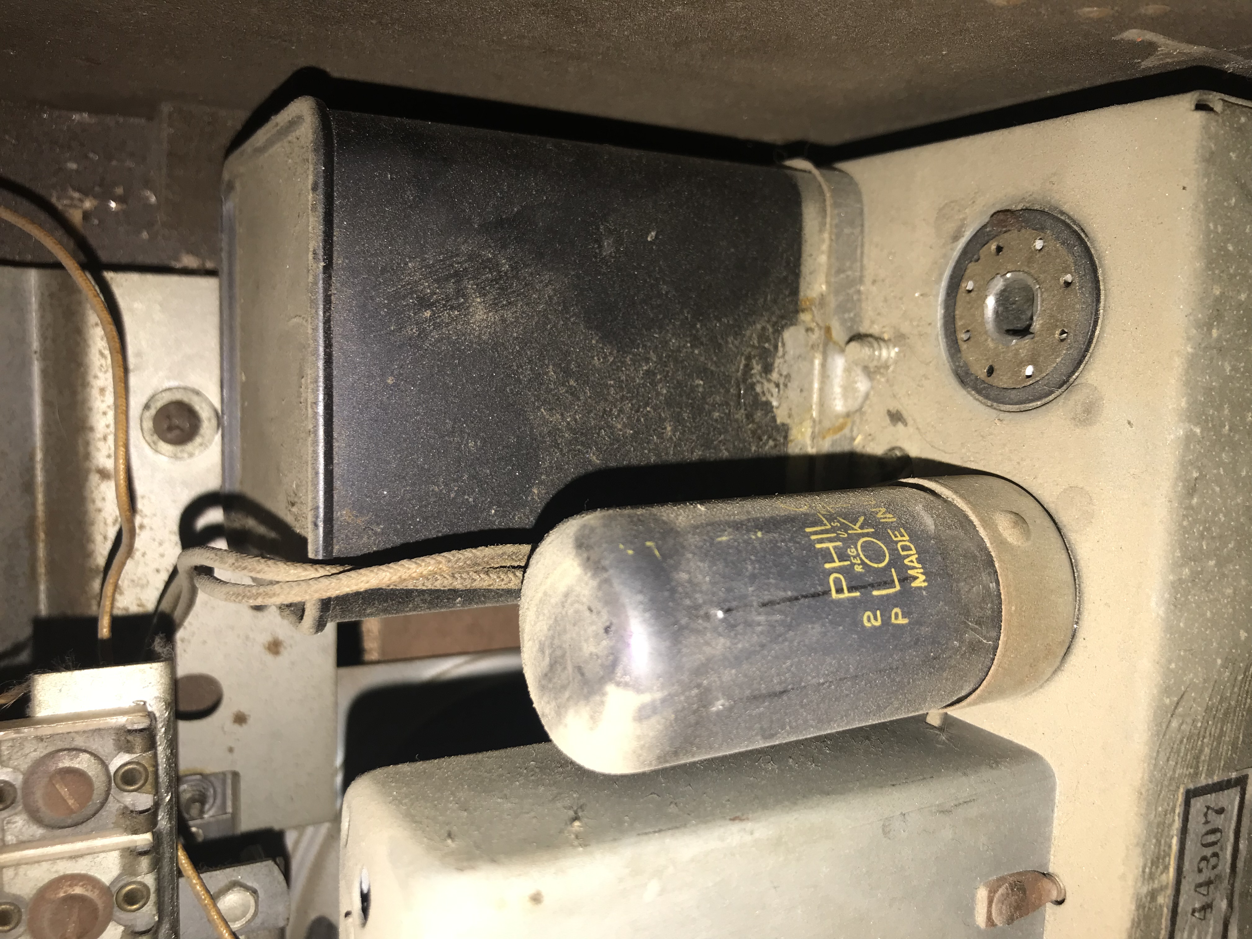

Before I get started on this…I’m thinking of using a polarized plug with a 1 amp fast blow fuse before the line caps on the hot side of the switch.  In the location indicated by the red dot on the photo. That sound about right or is there some other preference? To preserve the original look I think I’ll just use an under chassis fuse rather than drill a hole.
Hello bridkarl,
Looks good to me because that is where I would add it too !

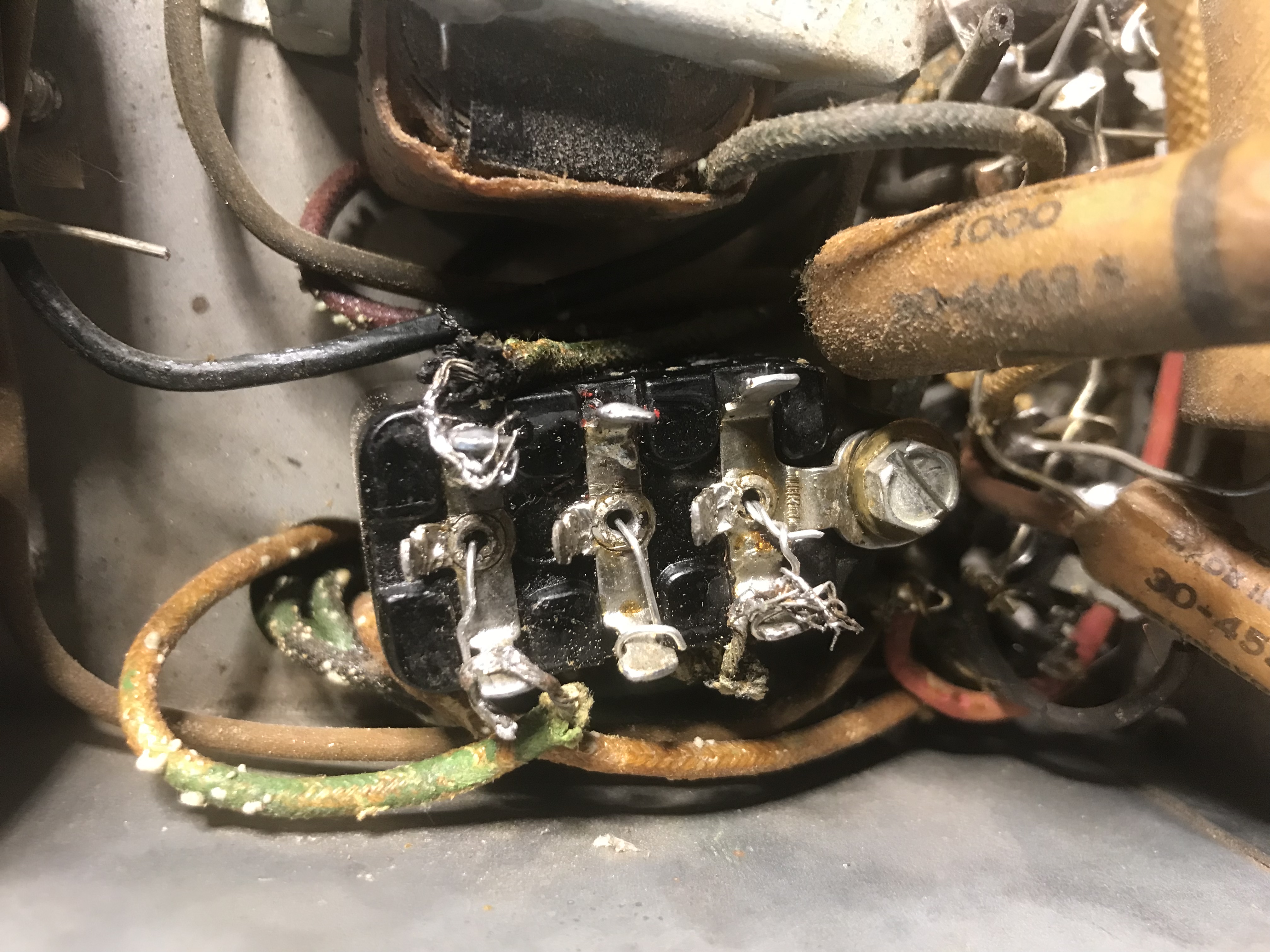

Thanks. Just always good to check. This apparently also has the line caps in a Bakelite box per normal.

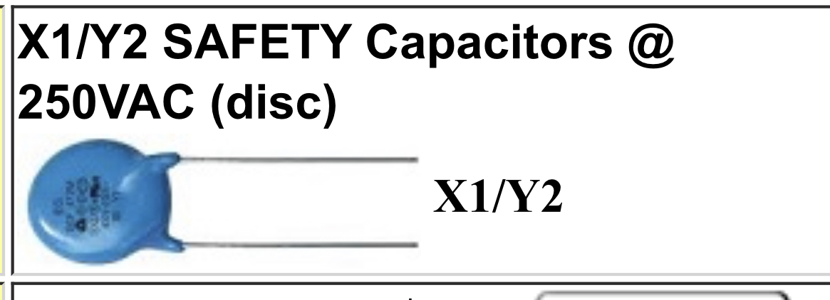

I’ve got two of those .01 x/y ceramic safety caps on order.
Shouldn’t be a hard job except for finding that missing push button. Looks fairly straight forward layout.

Yes, I buy those Safety capacitors from mouser and yes that set should be fairly easy and having a power transformer is a plus !

This 42-345 seems fairly easy. Seems clean on the inside - no issues.
I replaced most of the caps this afternoon. I’m waiting for some parts to finish this up. The only hard part was two .05 caps which were placed under the coils. That’s just an evil location.
The screws holding the chassis to the case on the bottom are gone. I’ll have to figure out what size these were. One or two runs of rotten rubber wiring that need to go.
More slow progress. I replaced the condenser block today using two .01 safety caps. I’m just replacing other caps later this week like the electrolytics.
It’s clear to me that I’m the second person to recap this as the 12mfd cap clearly isn’t the original.
