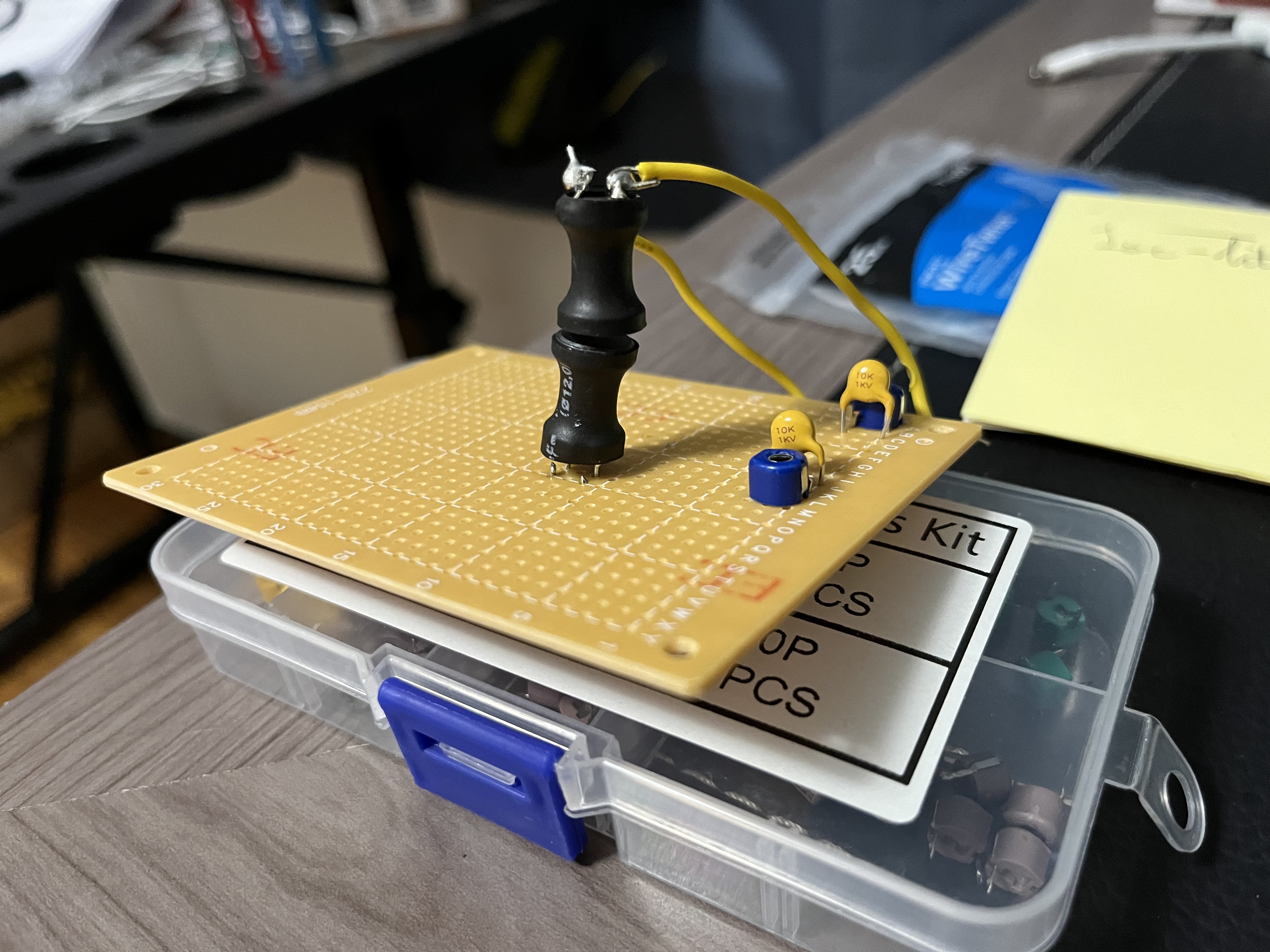

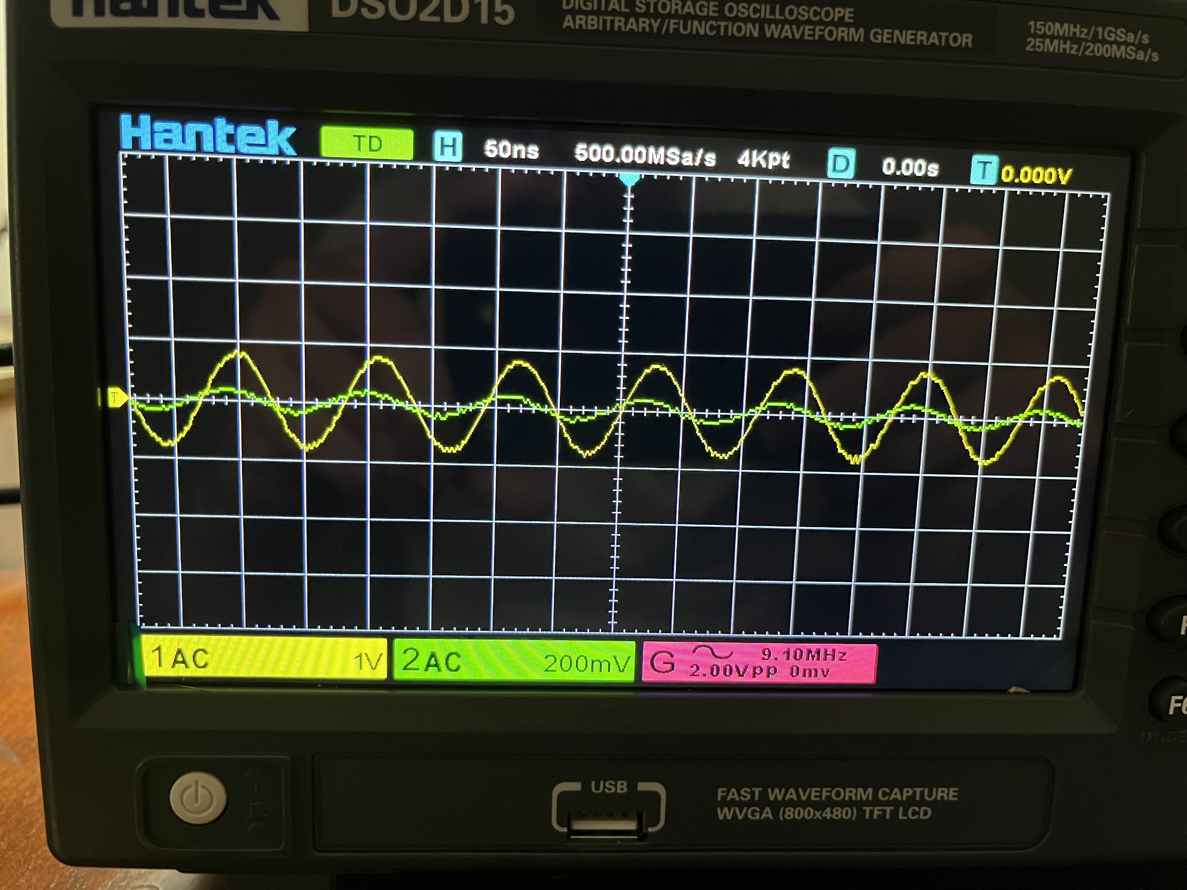

The components arrived today, which was far faster than I expected. I’ve tried prototyping both the coupled inductors and the individual conductors. I believe I’ll have to adjust the capacitance to get things just right, because I seem to have no range of adjustment at 9.1 MHz. I seemed to have better luck with the individual inductors than I did with the coupled inductors, but the resonant frequency was 3.5 MHz. I noticed that I seemed to have roughly a 200 kHz bandwidth (perfect for FM), because the output signal began attenuating whenever I adjusted the signal generator up or down by even 0.1 MHz. I also happened to notice that the output had some variation as I adjusted the secondary capacitance, but not as I adjusted the primary capacitance. This could be some external capacitance (possibly from my oscilloscope) interfering with the total capacitance of the circuit.
I also find that the inductors need to be very close to each other for best results. If the gap gets bigger than about an eighth of an inch then the output signal is attenuated severely.
I’ve attached several photos showing the reduction of amplitude of the output voltage as frequency increases from 3.5 MHz up to 9.1 MHz. By that point I had to adjust the volts per division of my channel 2 input.
I was testing this circuit in unloaded conditions, meaning that I did not have it integrated into the IF circuitry of the actual radio.
At this point, I have two thoughts on why the resonant frequency was lower than expected.
1) My oscilloscope may be introducing some series capacitance. Recall that capacitance is additive when in parallel.
2) The inductance might be too high. A value of 22 µH is quite small, but it may still be high enough to start choking any signals higher than about 3.5 MHz.
I think you're picking up 10pf in lead length. See if you can put the inductors close to the caps.
A keen observation! Thanks, I will give that a try tomorrow. I had started with short leads when using the coupled inductors, but moved the individual inductors further away due to the increased footprint. I will reposition it all.
Might not hurt to get some smaller inductors on order. Using, say, a 2.2 µH or a 3.3 µH inductor will give me some more breathing room to upsize the capacitors. This should help limit the effects of parasitic capacitance.

I have reattempted with short leads to the inductors and with some resistance inserted on the primary side (I started with a 15 kΩ as the output resistance of the 14F8 on the primary side is 14.5 kΩ, but lowered it down to 4.7 kΩ for better readings). The results were more stable (with both the individual inductors and with the coupled inductors), but still I felt that the individual inductors worked better. I am still noticing that there’s no peaking or attenuation as I adjust the trim capacitors, so I believe that I’m still facing added parasitic capacitance from something.
My next plan of attack is to reduce the inductance while increasing the capacitance. I should be able to use a 3.3 μH inductor with a total of 92.69 pF in capacitance. I could use an 82 pF fixed capacitor and a 6.8pF fixed capacitor in parallel with each other for a fixed capacitance of 88.8 pF, in parallel with a 10 pF trim capacitor. This should raise the capacitance enough that any minor interference will not drastically affect the resonant frequency.
I thought about determining the theoretical inductance of the existing, broken IF transformer’s coils. There are 15 turns at a diameter of 0.175” and a solenoid length of 0.15”. The formula for inductance of a coil is L = (N^2 * μ * Α) / l, where N is the number of turns, μ is the permeability, A is the cross sectional area, and L is the length of the coil. I calculate 4.61 μH for the inductance with no iron core. I should be closer to this value if I use the 3.3 μH inductors.
