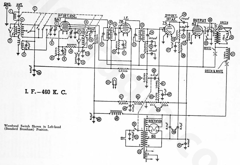

Hello, Working on this radio and have completed the recap including ecaps. I have noticed there is no plate voltage on the 75 tube. There is no plate voltage at the positive end of the second 8mf cap. I have either made a error in my notes or I failed to write something down. Anyway just how does the second 8mf cap get it's high voltage. I see nothing on the schematic that shows me that. There is high voltage on the first 8mf cap. There is plate voltage on the other tubes.

There is an error in the sch: the second cap has to be connected to the top pin of the #37 field coil. The missed the dot.
And so is the bottom pin of the #28 resistor 70k.
Thank you for the reply. So I did make a mistake that being believing the schematic. I always verify with the schematic. I was pretty sure my notes were wrong when looking at the schematic but they were not. When I made the connection radio came to life. Must say it plays pretty good. Now for the alignment and get it in the box.
Dan
More than one Philco sch has that mistake; it is a known one and popular at that: missing the tiedot from a plate resistor to the rail while connecting to the cap.
