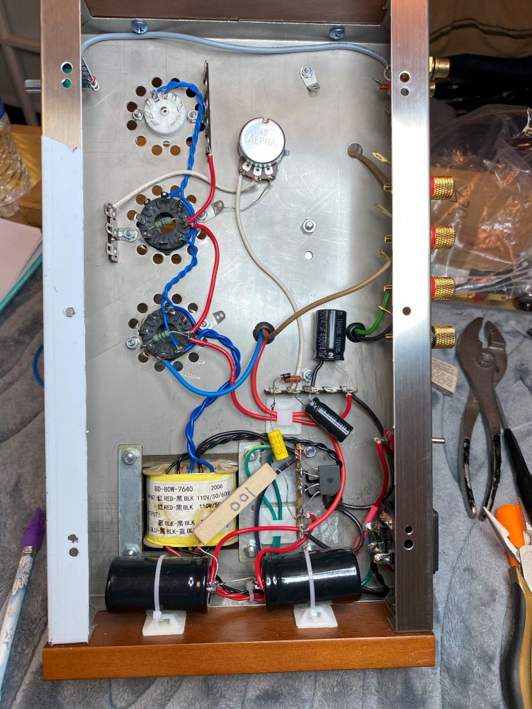

Construction has started! So far, I've gotten the power supply done and filament wiring run. The major layout is finished, have a few sketches of where things should go. I've made a few changes and moved things around. Hopefully I can start on the high signal parts, then low signal stuff. Also have the bias supply together. Anyway, here's a pic of the progress so far.

I got things pretty much in place, double checked, waited a couple days, did some resistance checks and powered up through a variac and dim bulb. B+ seemed pretty close to what I wanted so I brought it up enough to get something. Yup, I could get a signal if I touched the input, so I plugged in a CD player and ... AND.../// it sounded .... AWFUL! Almost no volume and was badly distorted. Did a few voltage checks and plate voltage was really high on the inverter. I could hit either side of the coupling caps with a signal and it sounded clean, hit the grid of the inverter and - nothing. It was dead. Tried another tube, same. The inverter was dead. So I studied the diagram (that I drew), everything looked ok, that is, until I rechecked the driver tube diagram. OooOooohhhh - wrong! I had the triode grid and cathode pins reversed. Well, that'd do it. I have a feeling I just looked at the wrong pinout and drew it wrong.
So I switched it tonight and brought it back up - and ... AND ... SQUEEEEAAAALLLLL SQUEAL SQUEAL! Well, shucks. Been there, so I flipped the ground and feedback and it came on quite well. So, yeah, oops! So anyway, some of the same stuff I ran into before. I don't know if flipping the plate leads would change it or if the tranny is backwards. Anyway, I haven't really done a thorough sound check, but I did note it has the same lousy 60 cycle hum as my last kit. Not bad, just kinda ... there. So I know it isn't a filtering issue. Gotta either be coming the heater or ground loop. Since this is an experiment, I'm going to try a few things. I set this up so I can isolate the ground with a bus I may try some different heater arrangements, like DC, or maybe a hum balance. But all in all, the fact that it works is an accomplishment! And, no smoke!

It's be interesting if you put your schematic here.
Who knows, you could get some advice from a few folks here.
That yellow tubular cap may sag over time. Long leads, perpendicular to the axis with reasonably heavy part.
