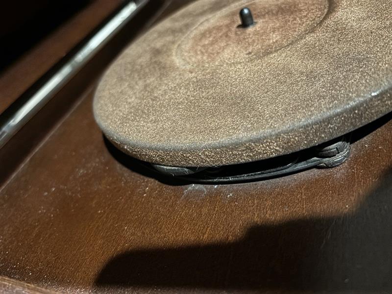

Specifically, the platter isn't covering the idler wheel, even if I push the idler wheel in (it's spring loaded). So there's no contact between the idler wheel and the inside rim of the platter. I've circled it in the attach pictures. Should the platter be sitting deeper on the spindle (circled in second picture)?
It should go in.
I do not know this specific mechanism.
I would closely examine the spring-loading arm for any unwarranted restrictions, when pushing the idler in; also make sure the idler is original and did not get somehow flattened and widened (doubt it, but...)
Was it inside when you got the set, before you removed the platter?
I don't remember unfortunately. Also I should add that the spindle easily popped right out of the platter after I took it off. I wonder if these parts don't actually go together. That might explain why the wires to the turntable motor were cut.
