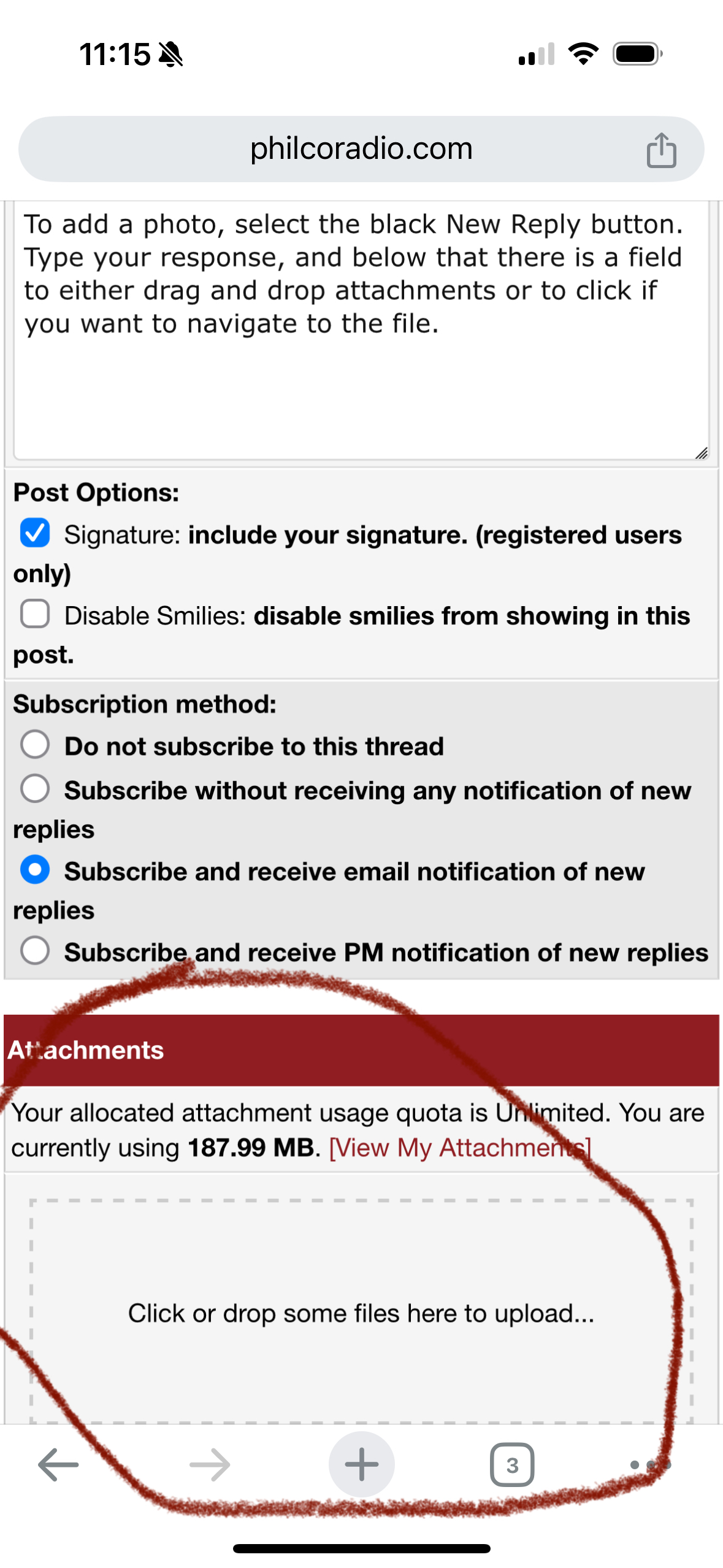

Not sure how to post a picture on this site. Any advice?
the lead for the screw terminal connects with one of the leads going directly to the internal loop antenna. Once I find out how to post a pic, I will. Many thanks....and Happy New Year everyone.
To add a photo, select the black New Reply button. Type your response, and below that there is a field to either drag and drop attachments or to click if you want to navigate to the file.

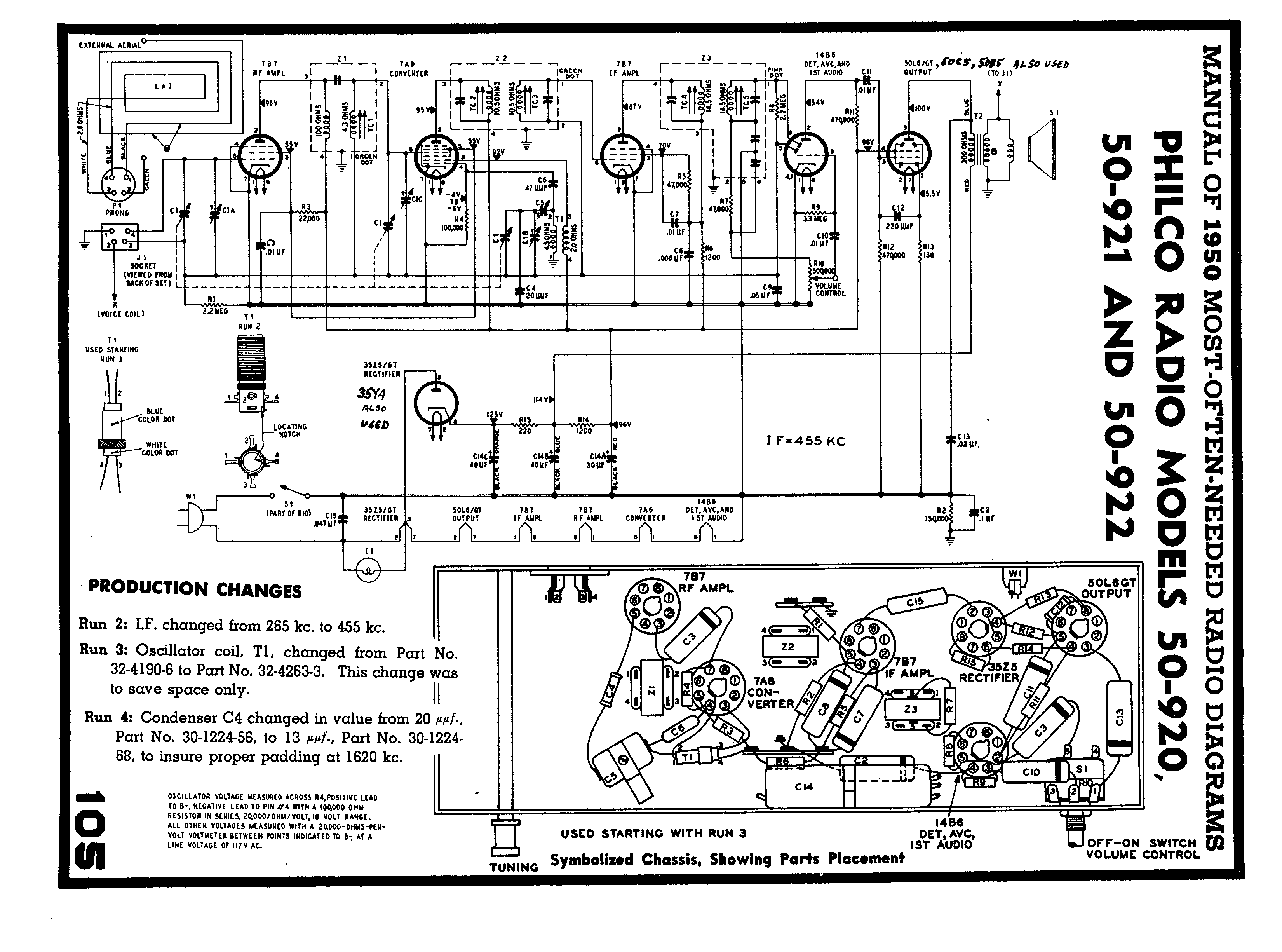

Some info from Beitmans.
Thanks everyone. hope the pics work. and thanks for the schematic. Mine has the 50C5 aud. output and 35Y4 rect.
I have tried only a long wire on the external terminal. Get some overloading on strong stations actually using the wire, but weak ones are strengthened. This is during the daytime.
Mark
Your antenna is working as intended. The loop antenna is an rf transformer with the connection available for an external wire antenna. The signal on that wire brings in a stronger signal resulting in more gain to the radio.
