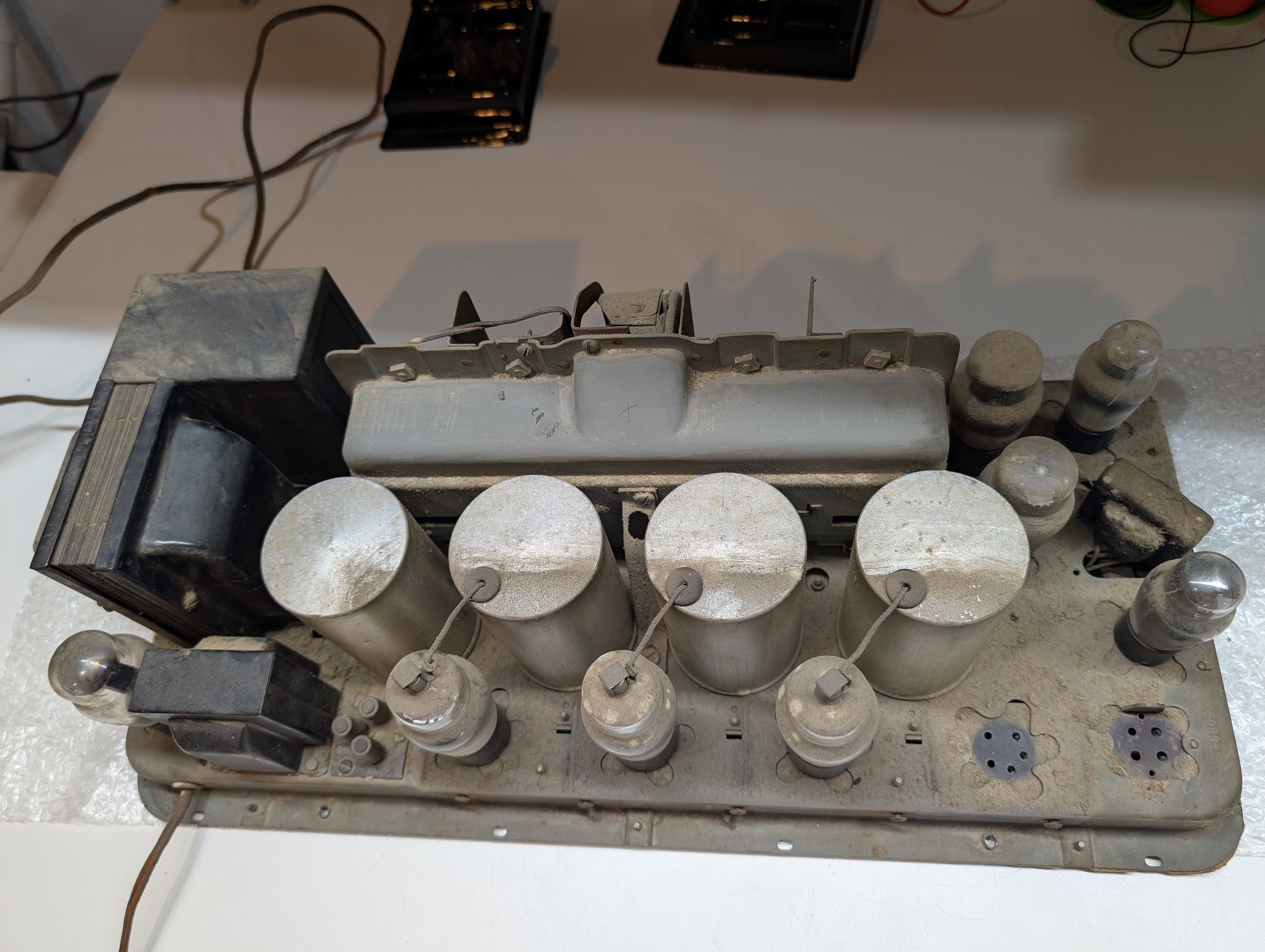

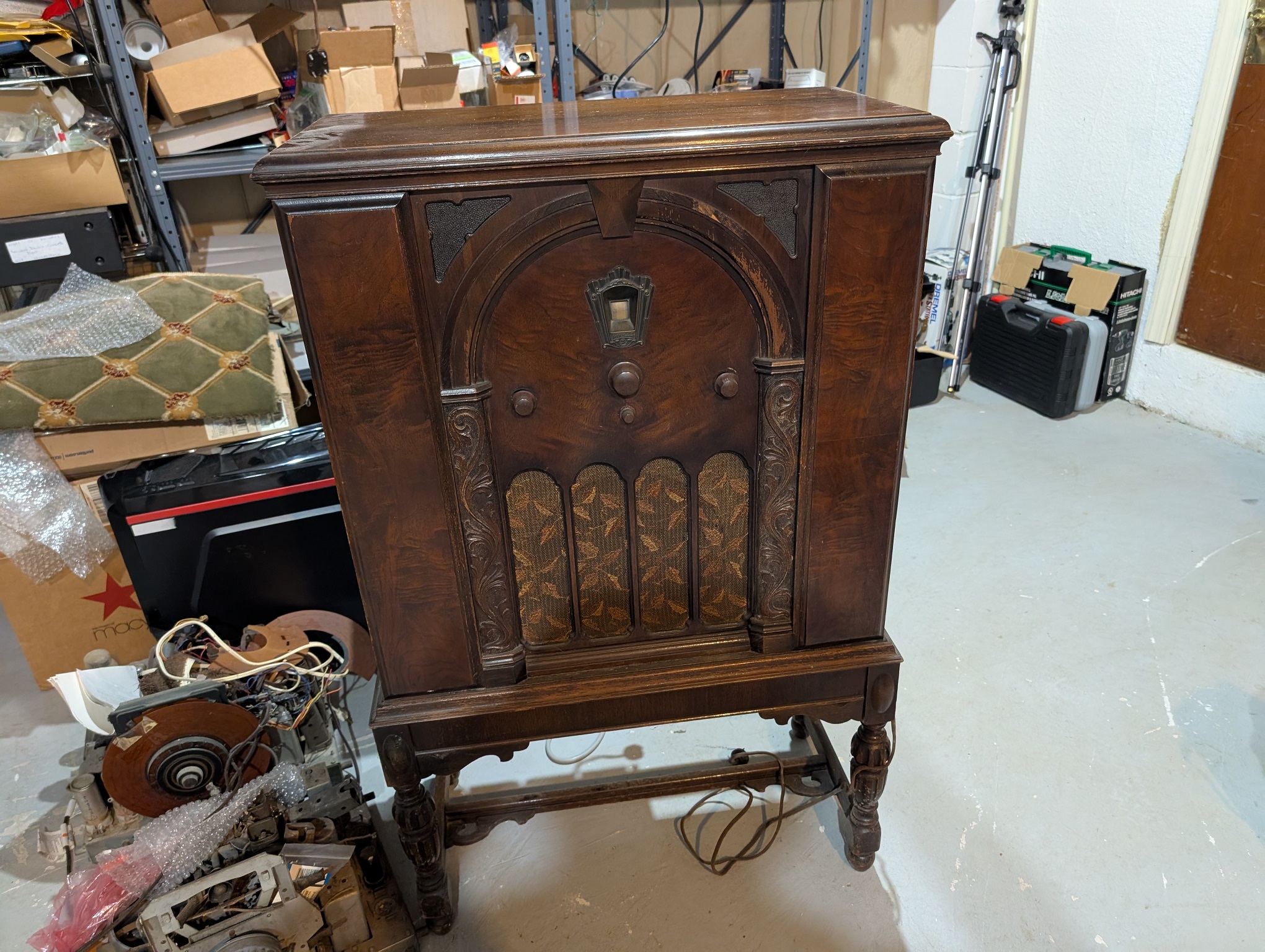

This radio was bought...at least 8 or so years ago. I still was open to getting consoles, especially those that came with a right price.
I am sure it is a 96, as, first of, it is the Highboy with the leaf pattern
Also, upon opening the cassis, (the schematics of 96 and 95 are nearly identical) the tell-tell sign, the backelite capacitors, were found, that confirms the 96.

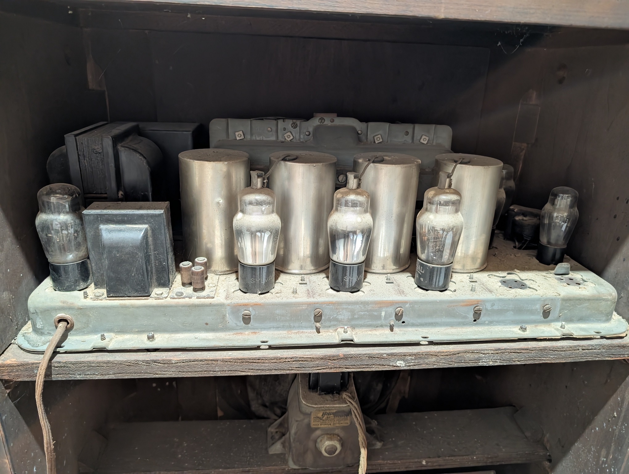

The chassis, other than lots of dust, is in fair to good condition. A fes rust spots are not bad, surface rust, and inside is clean.
This is the back of the radio.
And the chassis is out.
Like I said, dust galore.
Now, as I knew (some time ago I did check the speaker), the speaker has bad field coil (and good transformer). I have another speaker, exact same problem, and the third one was the same (I used its transformer elsewhere). Seems to be a common problem with G speakers.
Even though this is the type with removable FC, I am not a big fan or rewinding large coils, and so might try to find a speaker with good coil (the transformer I have).

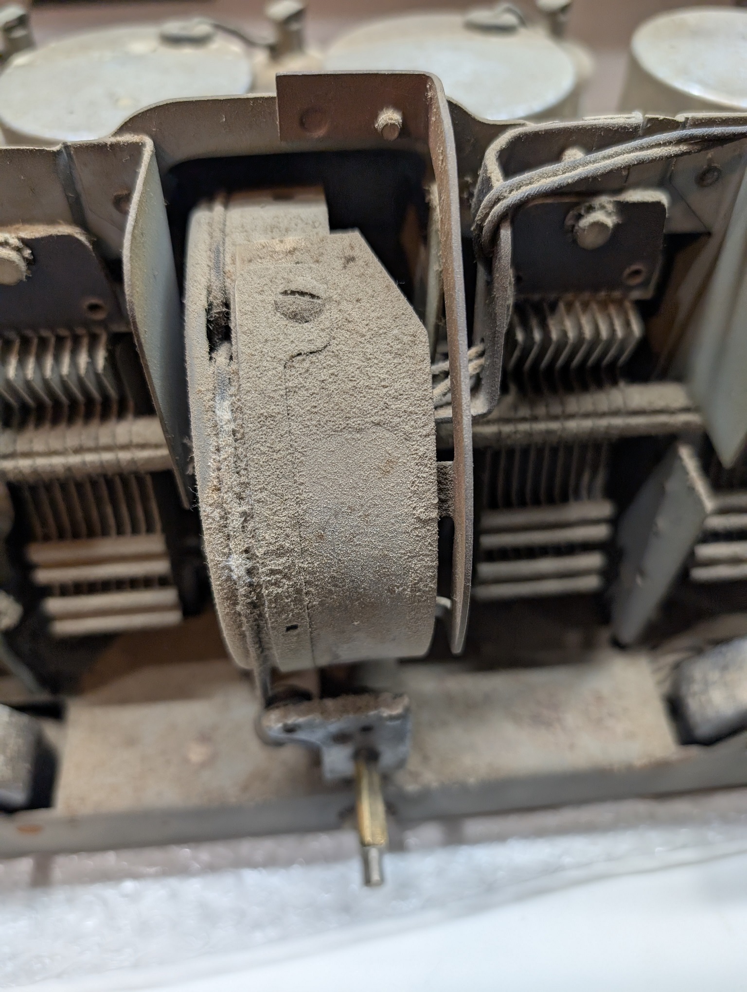

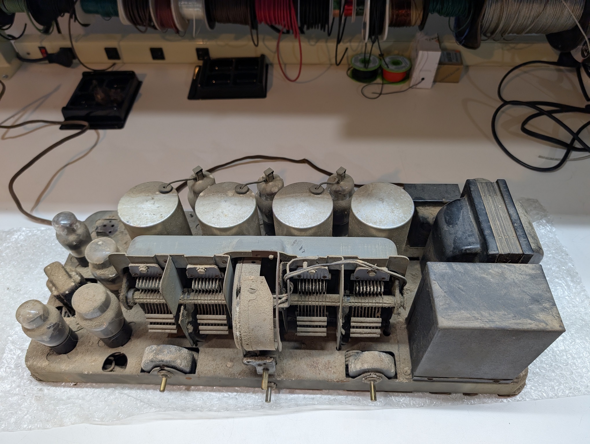

That is quite the large tuning capacitor! What are the dimensions of the chassis? I realize that it must be quite large, but in the photos it looks very shallow. Also, what is that large pot enclosure in front of the AC transformer? Is that a battery compartment?
I am excited to watch this restoration. I know that they take up a lot of space, but consoles are just so special to me. Sometimes they don't get enough love.
Joseph
Philco 46-480
Philco 49-906
Posts: 16,559
Threads: 573
To have some idea, I (and others) have 87, 111 and 112 restoration, which are the radios from the same period, with often the same or similar cabinets and grillcloth.
I never measured them, but yes they are shallower, or at least look shallower than the later chassis.

More photos. As can be seen, everything is quite dusty.
Also someone changed what seems to be the interstage transformer. Long time ago. The repairs, as it can be shown further, seem contemporary.
After the first vacuuming

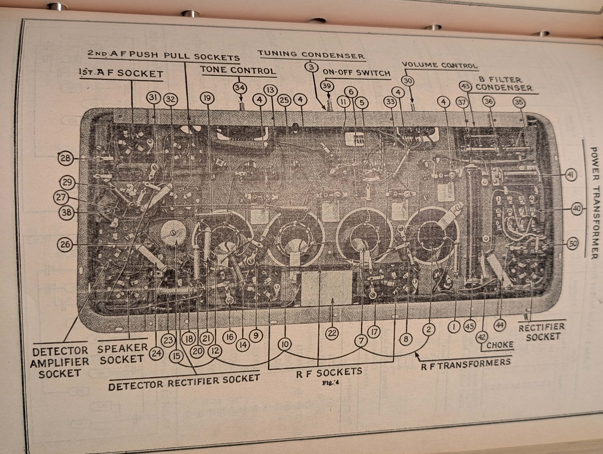

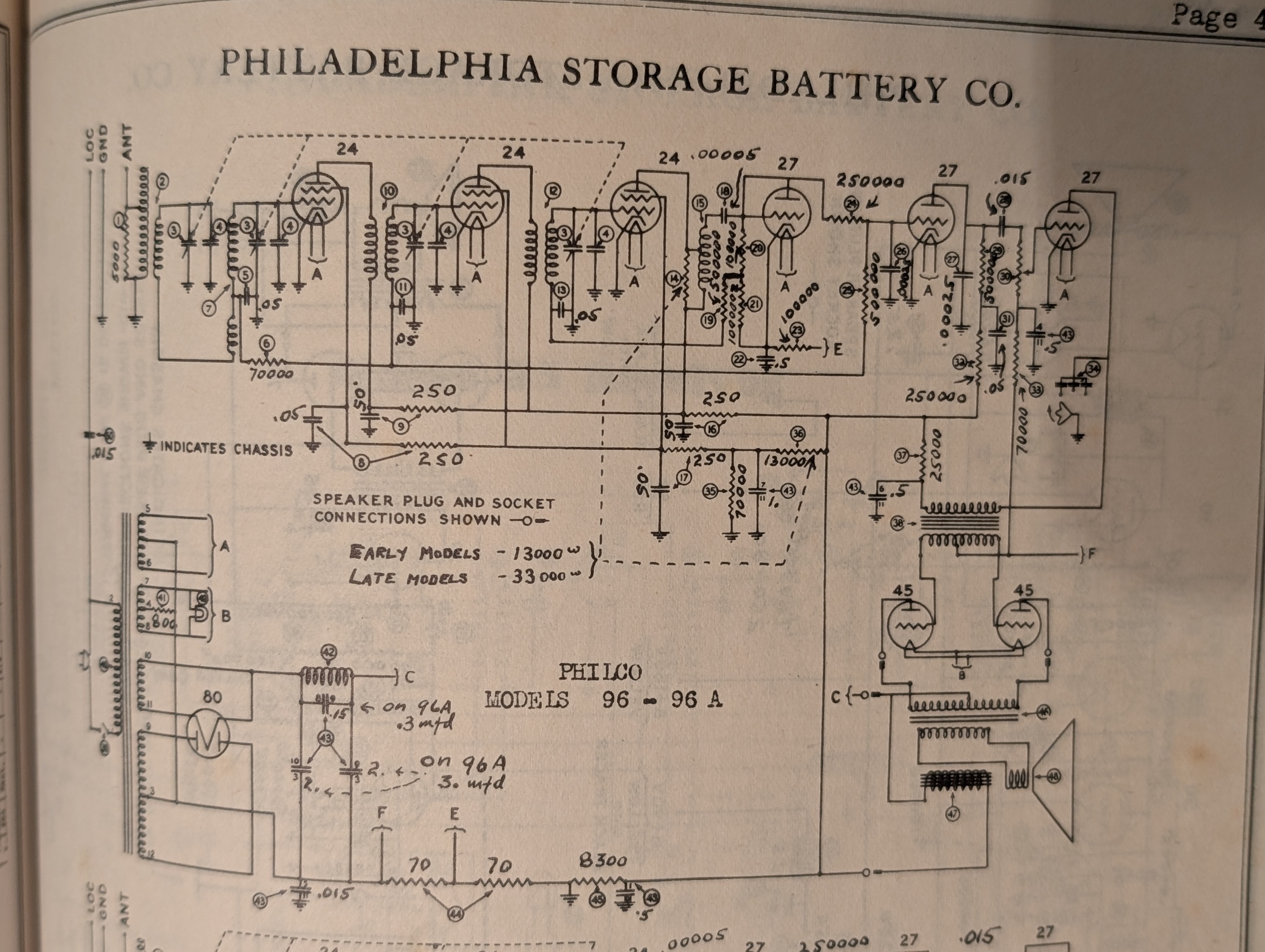

As usual, I went to the Riders books first, and here it is:
- the schematic is in Vol I
- The chassis bottom photograph is in Vol II
- And the alignment procedure is in Vol VIII
So, I went to Nostalgiaair and opend the scans, that are consolidated in one PDF file.

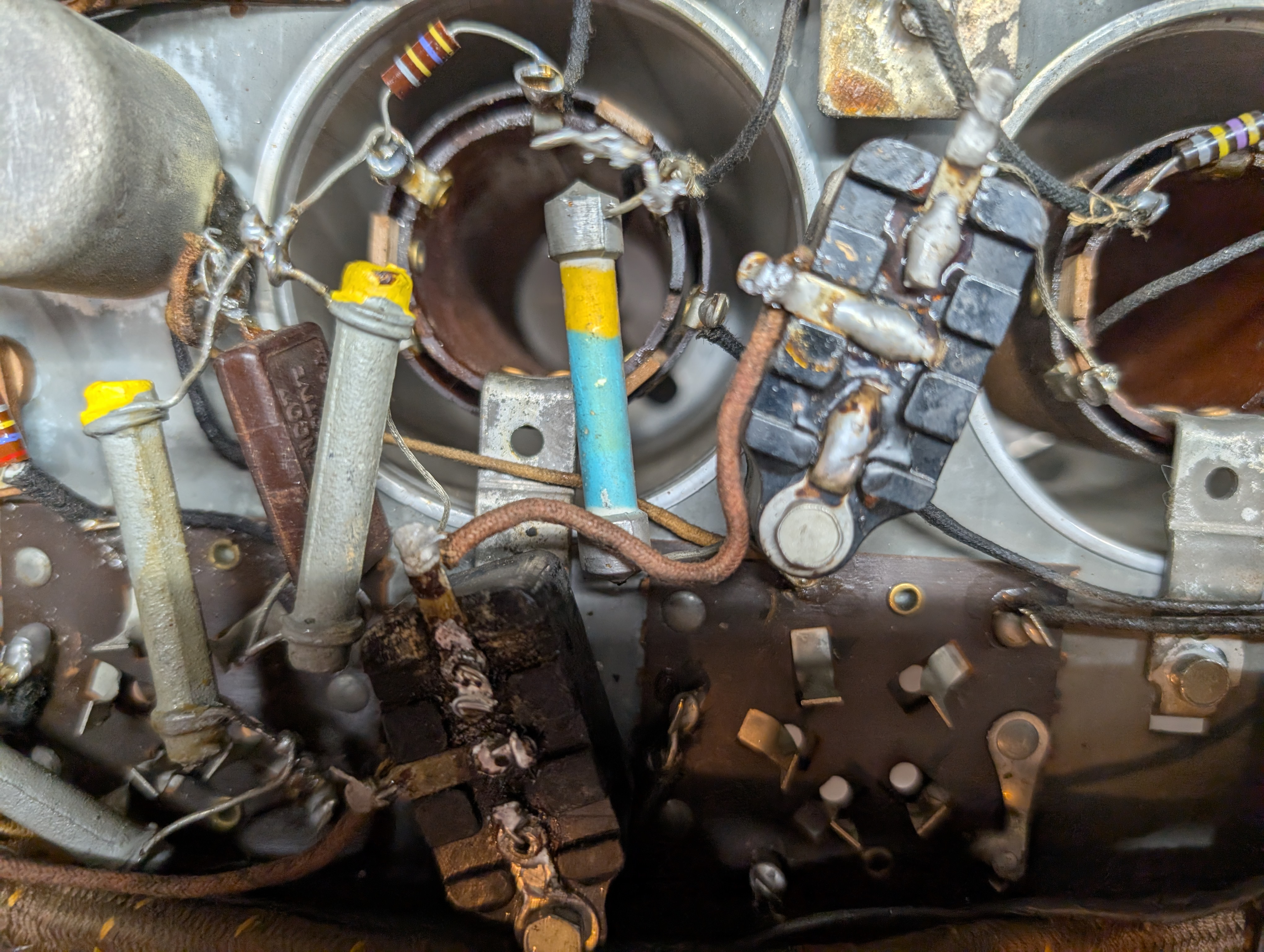

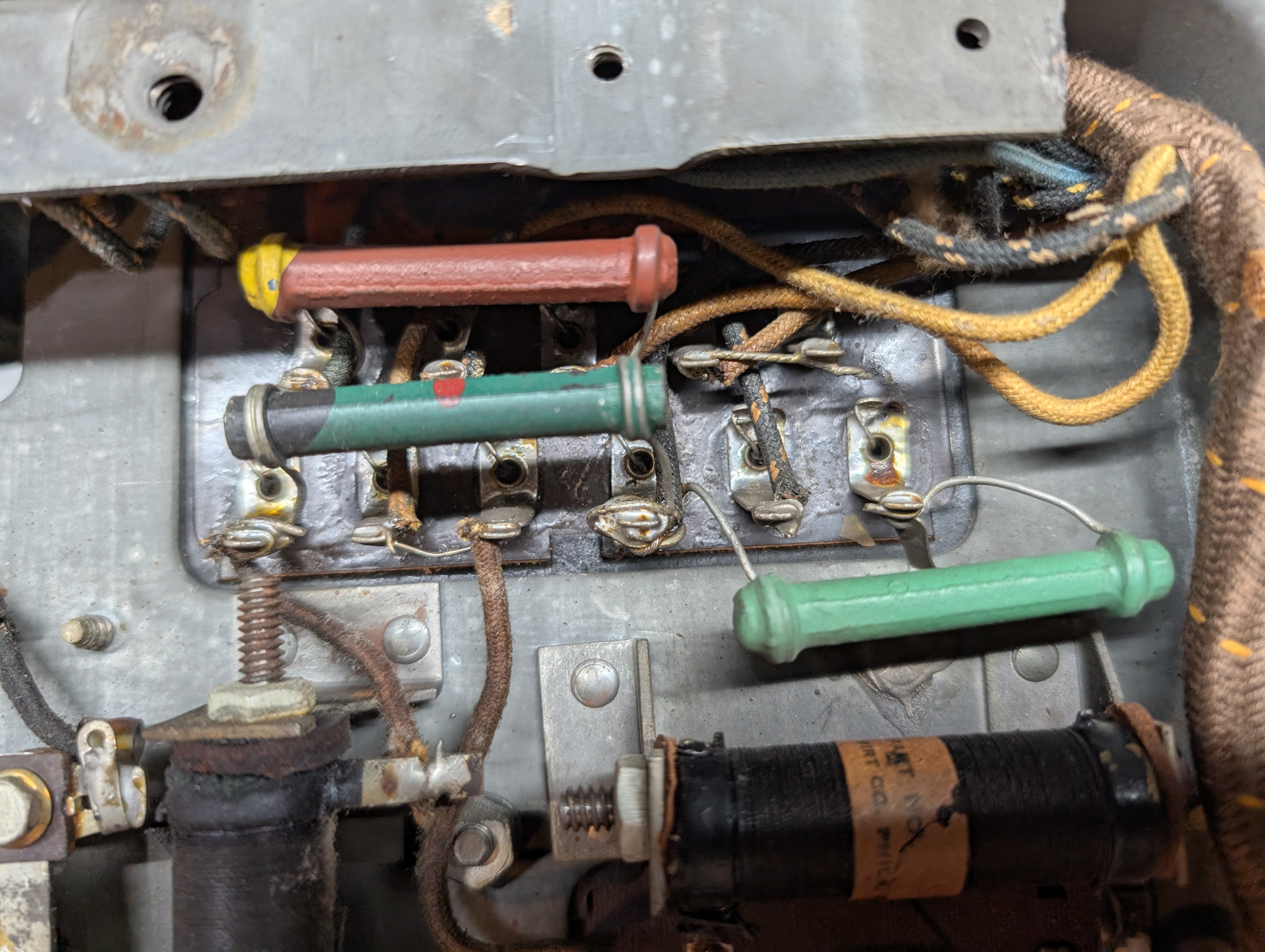

This chassis is strange. Yes, it obviously has some repairs done to it.
But many resistors, that seem factory, or at least totally time-appropriate, and do not seem replaced, are not in agreement with any values, even if corrected for time-related deterioration. And some are wrong with the markings, that do agree with their values.
Here.
This blue/yellow resistor (dogbone), which does not have the dot (none of these have dots. Some are painted with single color, grey or green), means that the value will start wth 64 (before the multiplier). The resistor shows 48K.
This is R14. It shows 13K on our schematic
https://philcoradio.com/library/index.ph...chematics/
And it says 13K on early and 33K on later models in Riders.
Let's proceed.
These 3 resistors on the capacitor block.
At this chassis photo (it is better than at the Nostalgia website, right from Riders) these aree R37, 36 and 35, respectively top-bottom-right.
The top is Brown and yellow. Which means it will start from 14. The sch shows 25K value.
The one under it is Green-black-red dot, which is 5.1K. And it does show 5.1K (wow, kept well over time). Except the R36 is .. 13K. On my schematic (which is posted above) this one is listed with R14, as 13K/33K early/later chassis.

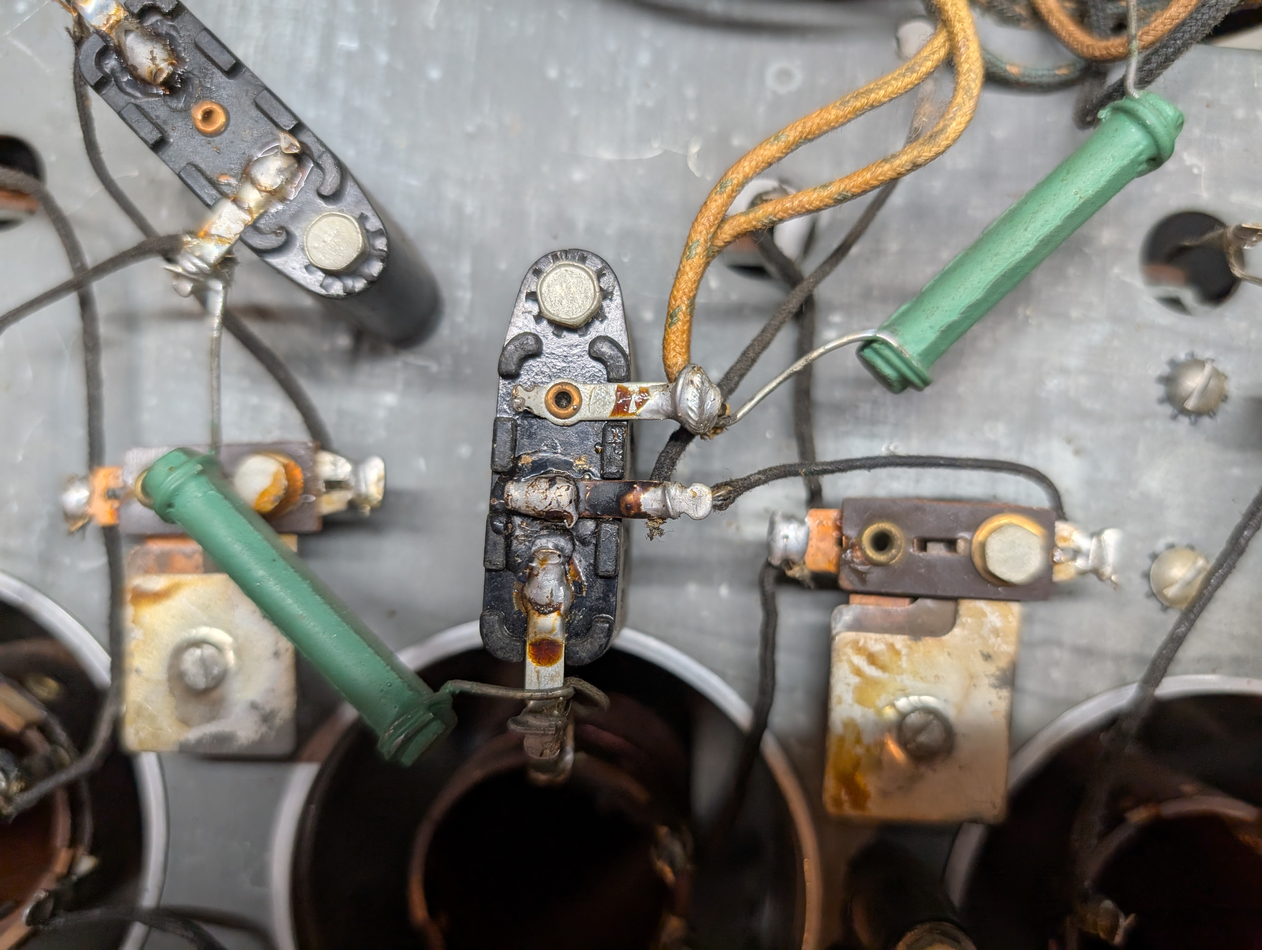

And the last one, R35, is pained green (there are others painted like that), and they are all different values. NOt even close to 70K that is shown in the sch. Here's the photo of the others painted green.
I will proceed with the values shown in the schematic, but...it is puzzling; I never met time-appropriate factory-looking components that are so badly in disagreement with the documentation.

Hi Mike, l seem to remember that Philco had their own color code scheme early on. Someone somewhere has the code. Probably didn't catch on because there wasn't enough colors for all the values.
Posts: 16,559
Threads: 573
Rod
Yes, for resistors.
But they too had two colors at least.
Not the same uniform color for various values.
Posts: 1,166
Threads: 45
Joined: Feb 2015
City: Roseville, MN
Maybe the green ones were 5.5meg, red 2.2k. $
Posts: 1,411
Threads: 71
Joined: Oct 2007
City: Linn Creek, MO
Posts: 16,559
Threads: 573
Thanks, seems this is it.
This document should be added to our repository; I only see the old resistor chart and that was not it.
Yes, "Jade Green = 70kOhm" is exactly that.
Also they seem to sometimes add "Yellow end" without changing the value.
Like Silver Grey or the same plus yellow is 100K.
Now, Blue is 13K, and in my case it is Blue and Yellow and is also 13K.
Thank you for the detailed response MrFixr.
