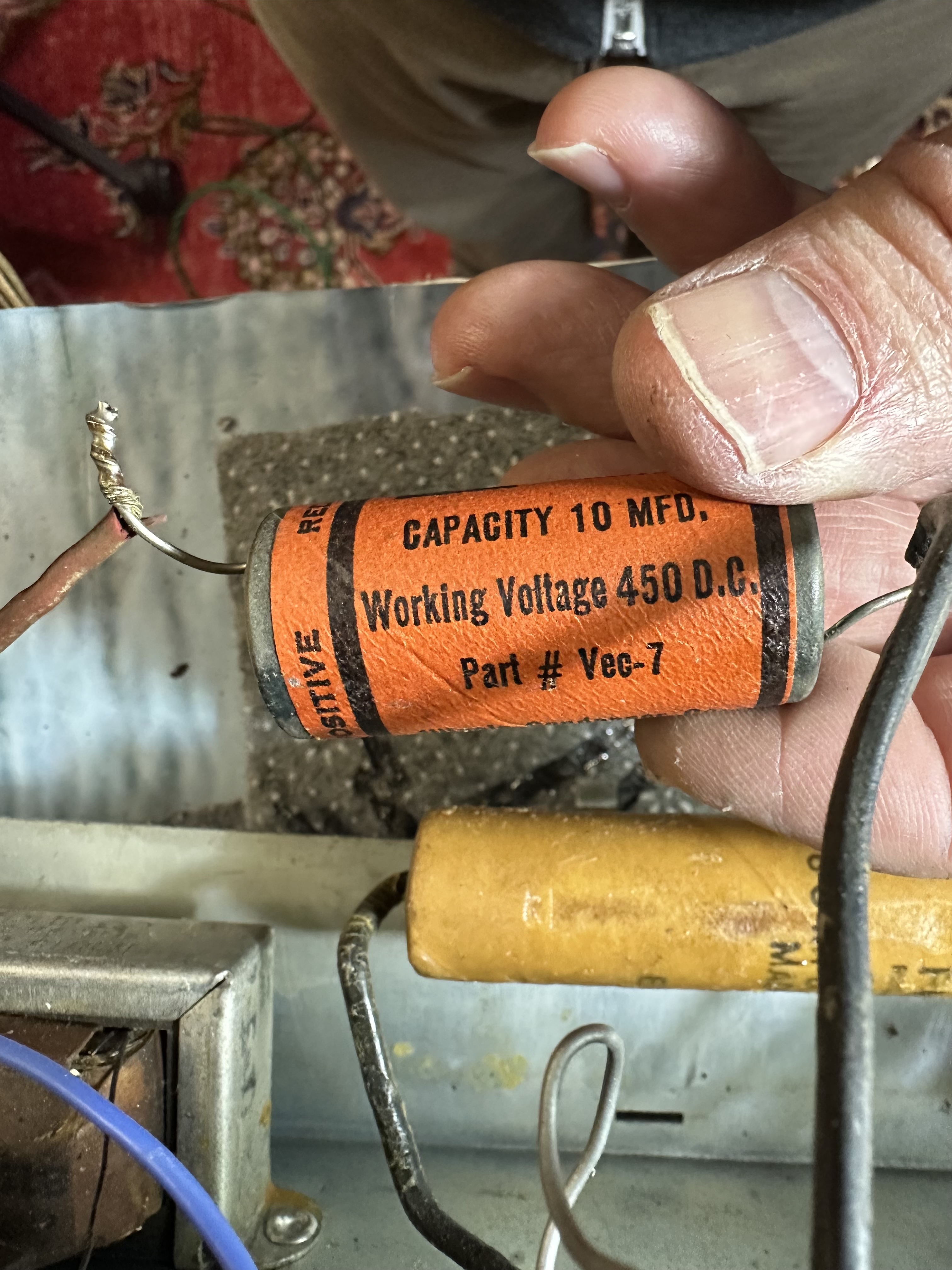

I'm working on my 42-365K, which I introduced to the Phorum last month.
I have a plan to replace the biggest capacitors, which I believe get called electrolytics.
Here are some photos:
I searched the archives and found Ron Ramirez's super helpful post from 16 years ago. He wrote:
"Okay. Here are the factory specs for the electrolytics used in Model 42-365:
"(37) Dual, 8 and 8 uF, 475 volts (per 1946 replacement 40-3003) - Part No. 30-2476
"(60) 12 uF, 400 volts - Part No. 30-2471
"Thus, armed with this information, it is safe to assume that 450 volt electrolytics will be just fine for this radio. In fact you could probably get by with 300 volt electrolytics for the two 8 uF units, but to simplify things, you may wish to go ahead and use 450 volts.
"8 and 12 uF are no longer standard values. 10 uF will be fine as substitutes for all three."
My questions are beginner basic.
Can I buy any 10 mfd 450 volt capacitors to replace the original monsters. For example, are these fine?
https://www.amazon.com/ALLECIN-Electroly...r=8-3&th=1
Second, how do I connect the 30-2476—which has two wires in and one wire out because, I think, there's a capacitor within the capacitor? Do I connect one new capacitor to the red wire, one to the green, and then both of them will connect to the black?
Note, btw, that I am replacing the rotten old rubber wires. (Side query: how was Philco getting rubber during WWII to use on the wiring of consumer radios?)
Once I replace these electrolytic capacitors and some of the worst wires, then I may turn to the other capacitors if the radio still works!
Thank you for helping a beginner. The question really is what replacement capacitors do I buy and how do I install the one that's a double.

Hello Tom, If this was my radio I would be using 500 volt electrolytic caps. I would not be under sizing voltage ratings. I buy my capacitors and resistors from https://www.justradios.com/ Yes the dual cap would be wired as you say. The red and green wires are the positive side and the black wire is the negative side. I noticed the dual 8 does not indicate the positive or negative side but the 10 does. Based on what Ron said the 10 should be a 12, check your schematic. I think both of your caps are previous replacements.

Hi Tom,
There's really no reason to use a higher voltage electrolytic capacitor than what the schematic shows unless it gives you a warm fuzzy feeling. Buying 500 volt electrolytic capacitors versus 450 will probably cost 50 per cent more. You'll also find that all the paper capacitors in your set will be in some stage of deterioration and will leak when DC voltage is applied or simply won't do the job when a signal is applied. You might as well order all the caps you'll need for the entire set as well as any resistors that are out of tolerance. It'll save shipping charges. I buy most of my parts from Mouser. Just Radios is also good. If you buy from either you can be sure of the quality. If I have an urgent need for one or two I'll find them on Amazon or ePay with free shipping.
Tom,
You are right to use 10uF 450V. 12uF is also fine, but for he very first cap after the rectifier you do not want to go much higher as this increases the voltage, and your tubes might run hotter.
300V Working voltage rating is not enough. 450V is good, and 500V is also popular.
For the second cap after the inductance (whether a choke or the Field coil of the speaker used as a filter choke) you could increase the capacitance if so desired, within reason; I often go with 22uF 450V/500V.
Now, this said, I would recommend NOT to buy caps from Amazon, with names like Allecin etc.
Also for that first capacitor, my recommendation is to go with those rated as "High ripple current" or "Lowe ESR" (which is almost the same).
The temp rating of 85C is OK, if it is 100uF, it is even better.
Panasonic is a very good source, sold in Mouser and other reputable places.
If you decide to go with film capacitors, this is fine too; if you decide to restuff the existing electrolytics with new caps inside them, the new electrolytics fit better inside due to smaller size. Many people do prefer the film caps, as they do not have limited life span, as the electrolytics do; however a well chosen electrolytic will outlive us all.

Hello Tom. Having gotten the info you needed on capacitors, let's talk about the wiring in the pictures you provided. Some of the insulation is showing signs of hardening, splitting, and de-laminating. Inspect all wiring carefully. Insulation can be repaired by sleeving the wire with heat shrink tubing, or total replacement. If you chose the latter be sure to route new wiring in the chassis exactly as was originally. Take care and BE HEALTHY! Gary
