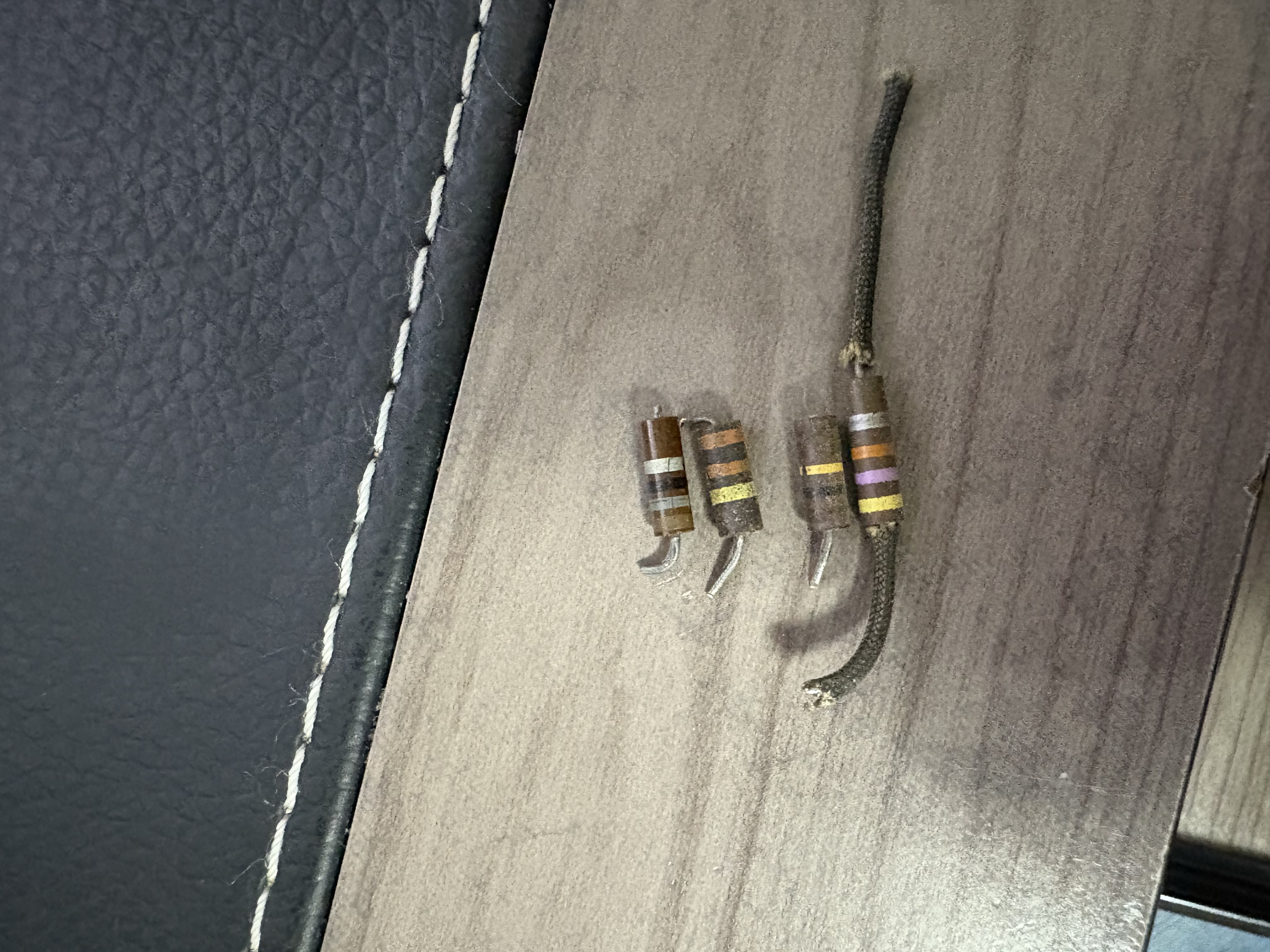

Back to the 46-480 restoration, I did make another observation. I had previously commented that R305 was an 18 Ω resistor when I removed it from my chassis. According to both the Philco schematic and parts list, as well as the Rider's schematic, it was supposed to be a 150 Ω resistor. At the time I decided I would keep with the 18 Ω resistor, since that was what was physically installed. However, I now believe that this resistor isn't original to the radio. For one thing, take a look at it (the resistor on top).
It's much shinier than some of the other typical resistors I removed. Now that I've discovered the AM-only Meissner IF can in place of the AM/FM Philco part, I am starting to picture that there was likely some sort of failure which prompted these replacements. I'm willing to bet that the serviceman who installed the 18 Ω resistor did so either out of error or to increase the gain of the signal being fed to the Meissner IF can since it is a double-tuned circuit compared to the unusual AM circuit in the Philco 32-4074 IF can. Thus, I now believe that I will match the 150 Ω value seen in the Philco documentation.

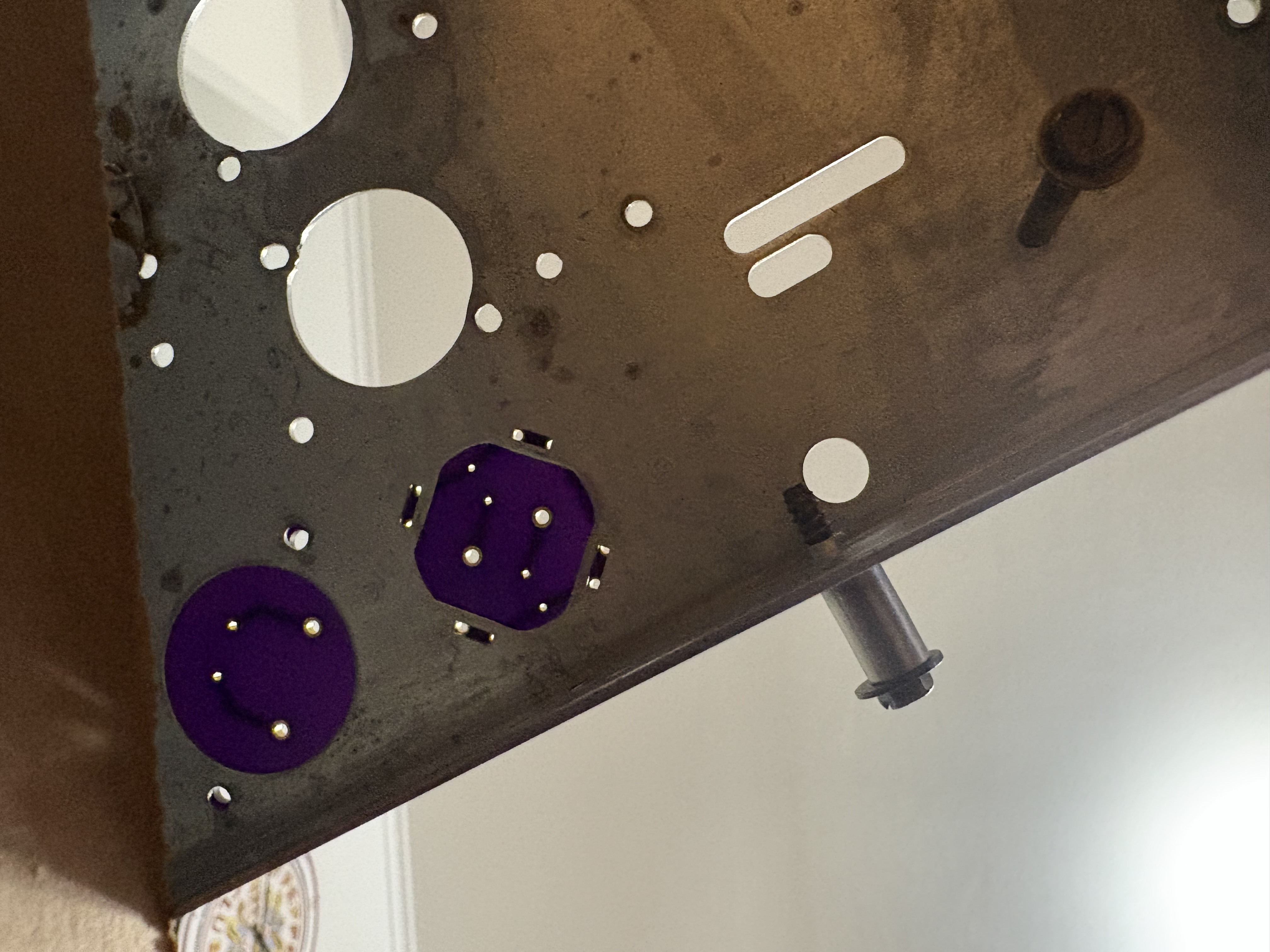

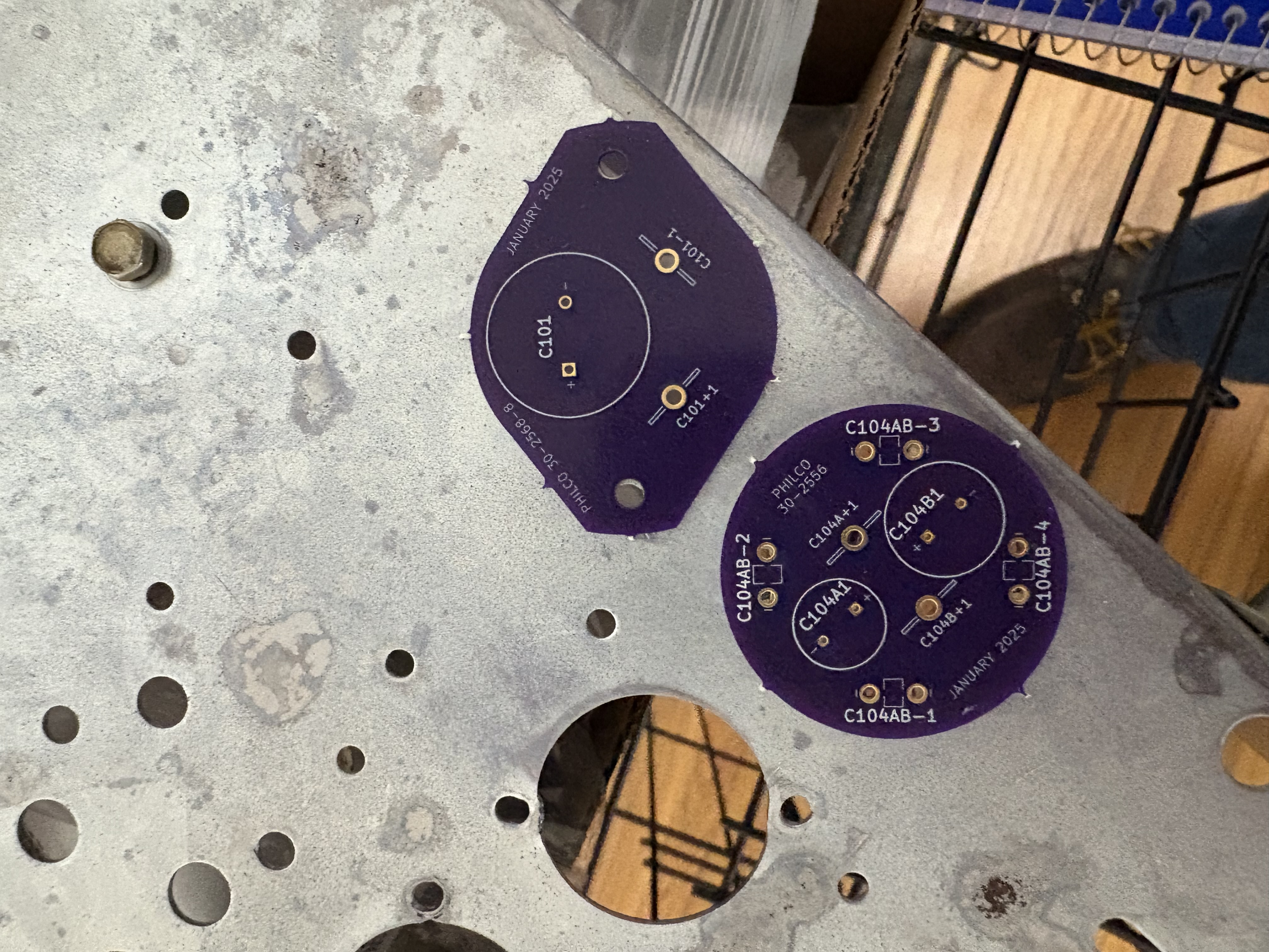

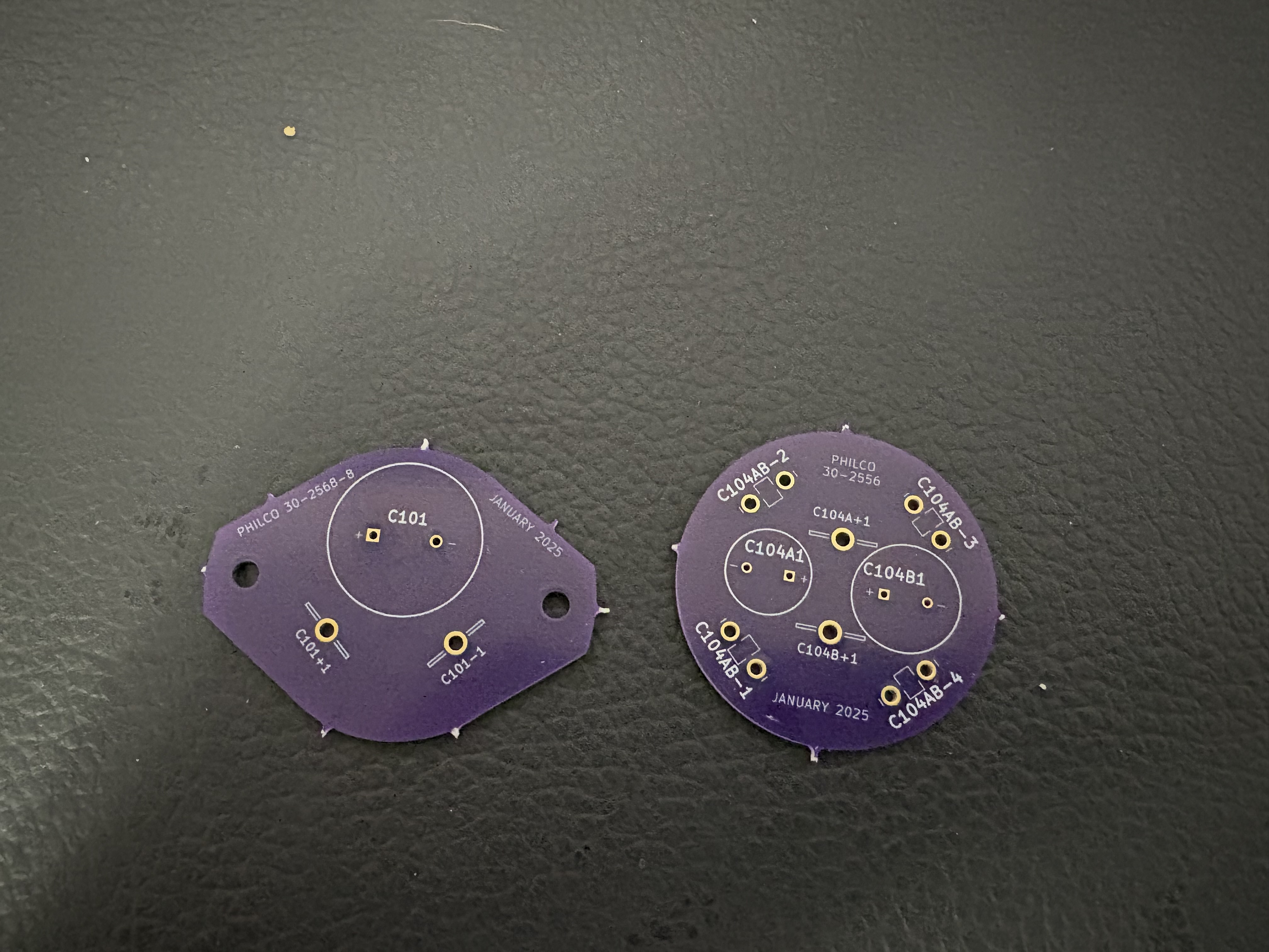

My PCBs were delivered for the multi-section capacitor replacements! The dimensions are just perfect. The elongated PCB lines up perfectly with the rivet holes, and the mounts for the four QC connectors on the circular disk align with the slots on the chassis for the original twist-lock lugs. Clearances look perfect (remember that the neutral pins, which are equipotential with the chassis) are the through holes which are closest to the edges.
I finished verifying all of the passive components yesterday, so I’ll get an order together on Mouser this evening. I’ll include the QC connectors and solder lugs for these two PCBs. Can’t wait to see them assembled and installed on the chassis!

I’ve gotten the parts in the mail, and so I now have the custom multi-section capacitors assembled and installed onto the chassis! I will say that the QC connectors were a bit thicker than I imagined, so they didn’t really want to twist. Not to worry, as I was able to bend them outward and then apply a small bead of solder to hold the assembly on the chassis.
