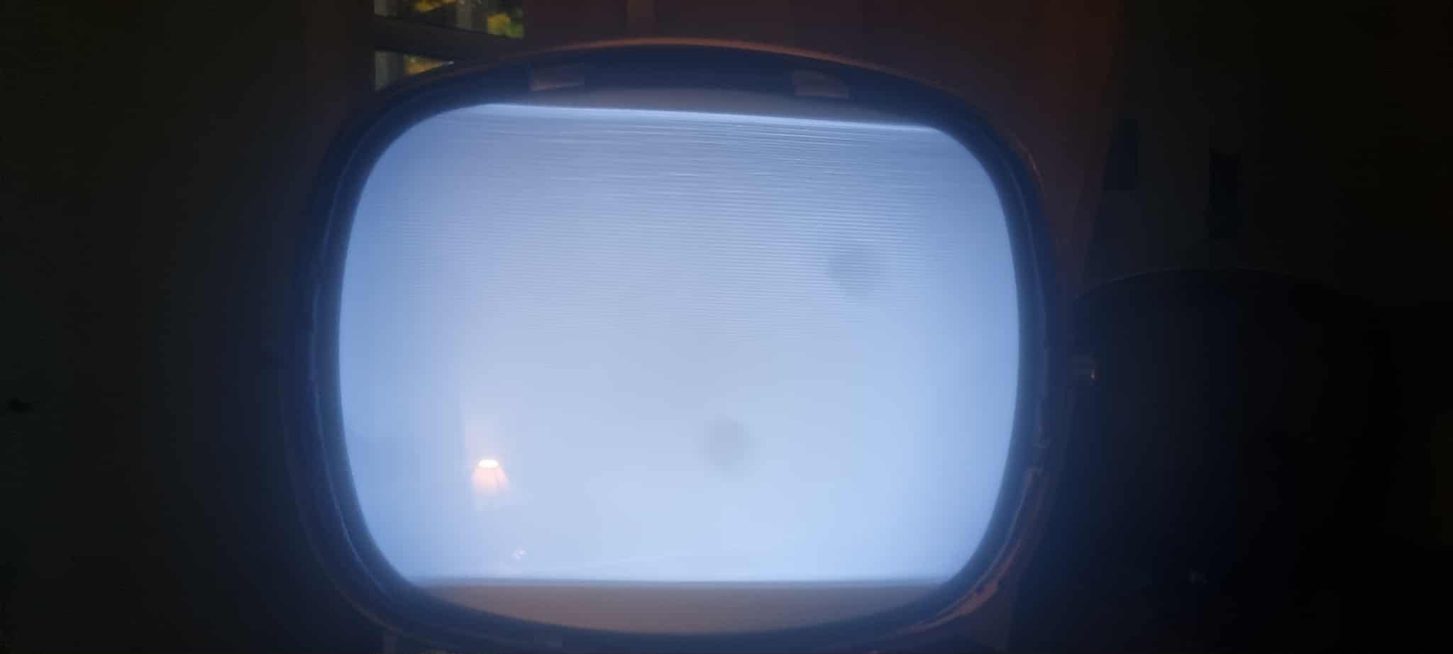

Hello, good afternoon, I would like to ask what the possible problem could be if I don't have an image on the screen. I changed the capacitors, resistors, and the networks. I did it myself because the factory doesn't send them to Argentina. I tried with another tuner from another one that I have and it didn't change.

Bob Anderson (Bandersontv) on Youtube would be the go-to guy on these. Lots of good videos. I don't know what model you have, but it's obvious there's no video. The good is that you have sweep and light on the screen. You swapped tuners with no change. So your problem has to be between the 1st IF stage and the video output (unless you are missing a voltage to your tuner or have a bad tube (between the two??). Couple questions: Do you have sound? If you have good sound, no video then start looking around the video amp/out stage. Check voltages etc. If no sound, then could bring you back up the IF chain. Double check your work, make sure the caps you replaced are the correct value, wires connected correctly, none broken, no solder blobs stuck somewhere. Beyond that, I hesitate to go further ... do you have schematic? Is it a transformer set or live chassis? What test equipment do you have? Isolation transformer?

The model is the holiday without UHF It has no sound and I don't have an oscilloscope or signal generator.
